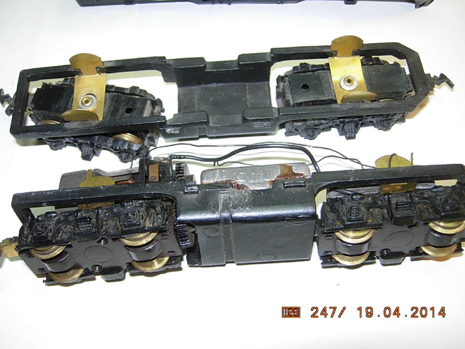

This past April my pal David gave me a lot of Varney chassis and bits.
The powered and dummy ones were simple, just cleaning and lube.
The last was different, as it had the Centriclutch attached.
But, the drive shaft was missing.

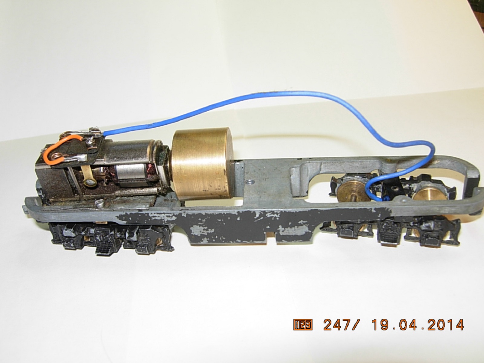

My problem is, the bearing on the existing motor is so worn, the tension from the drive belt causes it to bind.
How would one swap this clutch onto another motor without trashing the clutch?
There is no hole in the end to tap the shaft through.
Any crreative or obvious solutions, anyone?

I had to remove a Jerry Martin clutch from a DC60 motor and found that the center part was soldered to the motor shaft.
To remove the flywheel you have to heat it. It will expand enough that it can be pulled off of the pulley section.
Then unsolder the center section to remove it and the pulley section.
Ray

It was fun for awhile using the F3 with the clutch for switching in the yard. But,
After playing around with the loco for a few days I replaced the motor and clutch with a can motor.
The clutch was a novel idea to overcome jack rabbit starts due to crude motors and control devices.
Ray

That's a neat clutch design, but the weight of that huge flywheel plus the pull of the belt is no doubt what lead to the extreme bearing wear.
