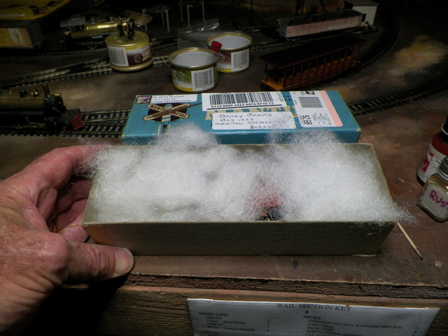

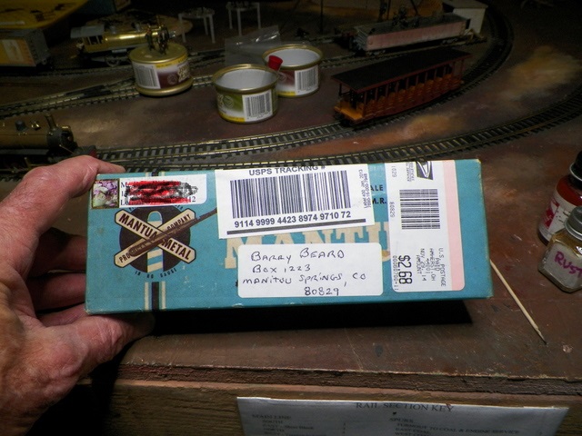

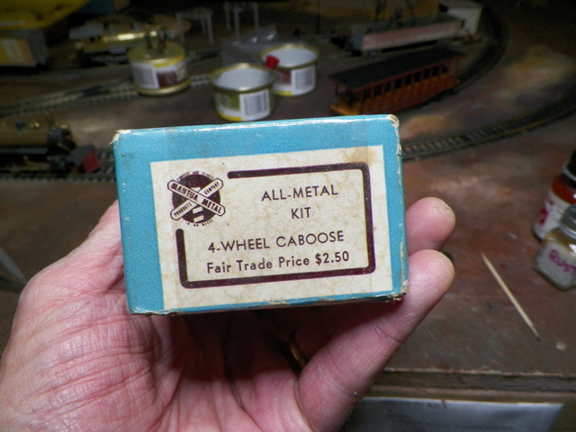

The best part of this "book" may be the cover. I'd ordered this Mantua Metal Products Four Wheel Caboose (eBay, of course, when I say "ordered"). So . . . when I looked in my post-office box today, this is what I saw . . .
Really! The seller used the original box for the packaging (name obscured here - only by Paint in this altered photograph - to protect the guilty) . . . In a way it was cool. Sort of like when you're 8 years old and you've been waiting for this premium you ordered from the ad on the shredded wheat box and now you've finally got the same shirt that Rusty wore on Rin Tin Tin.
Anyway, the caboose arrived fine and the original box survives; albeit with a bit more history recorded on it . . .

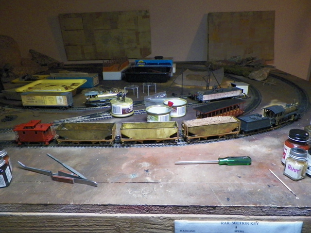

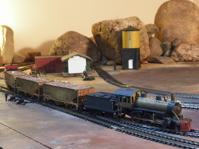

I got that caboose for a couple of reasons. One is that I think that pretty much gives me each of the types of Mantua Metal Products cars that were made (NOT each of the road names), and two is that I thought a small caboose might be appropriate for this little sort of work train I'm putting together . . . a work in progress yet (be nicer if I'd clear the extras off the layout) . . .

Nice little all-metal consist you got going there! If you want to save the box, you can get a heat gun, and get the labels hot enough that they will peel off without taking the paper underneath with it. Not a hair dryer, a real heat gun. Ugh, what a way to ship something, but I guess if you didn't know what the box represents, then oh well.

You can also get those labels off with Bestine. It's pricey, but worth it. It goes through adhesives and hot melt glue without damaging printing or plastic.

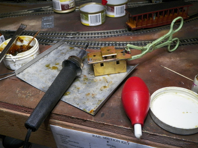

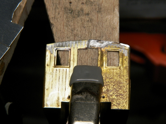

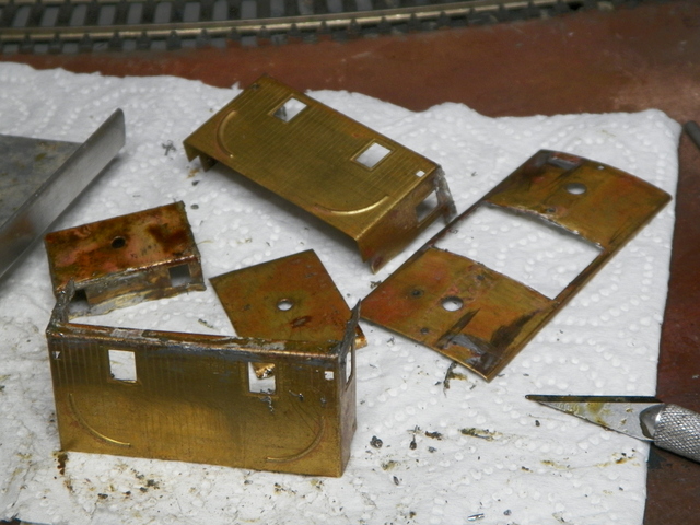

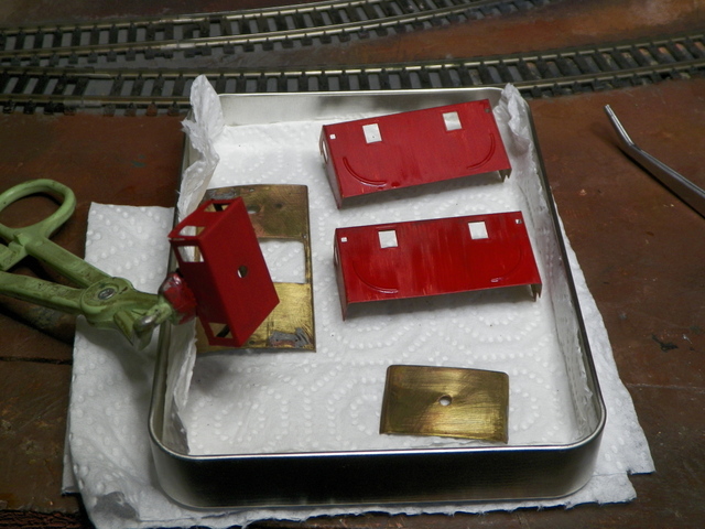

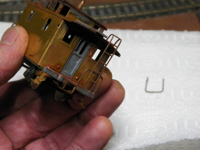

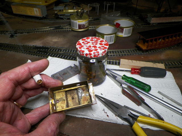

Hey Richard, In a way, I don't feel good about destroying someone's 50 year old (or so) model work, but I've got my own thoughts on what I want this caboose to look like. And I think I can improve on the build even while some folks might prefer to see me take a different direction. Anyway, here's where I am now after some brake fluid (paint was much easier to remove than I thought; some of that old paint is like welded on), a bit of soldering iron, a few knife blades and a couple hours of "carving" . . .
The little caboose was pretty solid with the cupola and roof pieces all soldered on and the sides soldered where they come together above the doors. The soldering, however, seemed to have been done while some of the parts were not ideally aligned. The guy soldered better than my ability, but it was still messy . . .
In my limited experience, I've found that I have better luck "carving" solder off than using the suction device to suck it up once it's melted, so I basically carved the solder out to get the thing apart. Now . . . if I can clean it up without marring the "wood siding".
As far as "that box", I'm just going to leave it like that. I think it's sort of a historical artifact that has been embellished with some recent history.

It sounds like your iron isn't hot enough to melt the solder joints completely, which is why you're having to carve through it. I tend to prefer guns for soldering brass, since it gives you quick targeted heat. A Weller gun over 100 watts should be fine for thin sheet brass. There are much better solder suckers on the market than that squeeze bulb type. I struggled with one for years until I got a good spring loaded one. You can also use wire braid to wick it up, or use the poor man's method and rap the parts on the bench to knock it off.

Thanks for the tips about soldering Nelson. I think I better go shopping for soldering supplies.

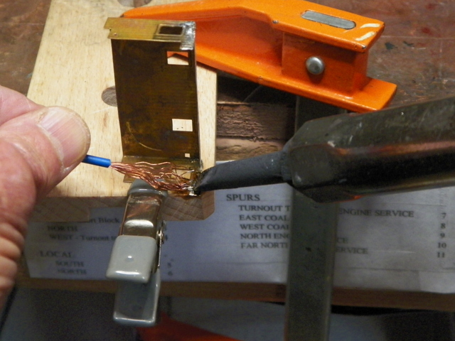

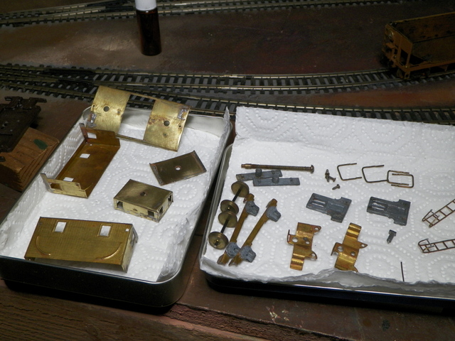

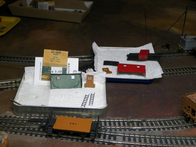

Well I've been working on that caboose and I went out and bought a desoldering pump and dug out a 100 watt iron. What seemed to work best for this novice wasn't the pump, but using some braided wire. The idea is that the tiny fluxed wire attracts the melted solder. It wasn't actually the high dollar braided wire you can buy for the purpose . . . it was some of the smallest wire I had on hand twisted up. Finer wire would have been good (and I would be a better modeler if I were more patient), but this wire did some good. I think the finer wire would have allowed me to clean out some tighter nooks and crannies . . .
an "after" compared to a "before" . . .
and now I have a "kit" . . .
I took photos along the way and here are some bits and pieces . . .

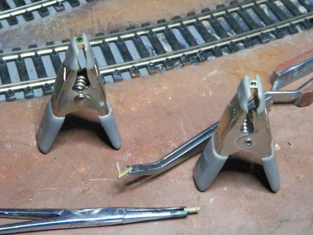

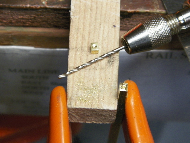

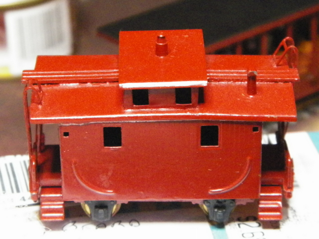

making the marker lights and flag holders . . .
more paint and glazing . . .

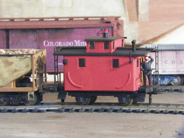

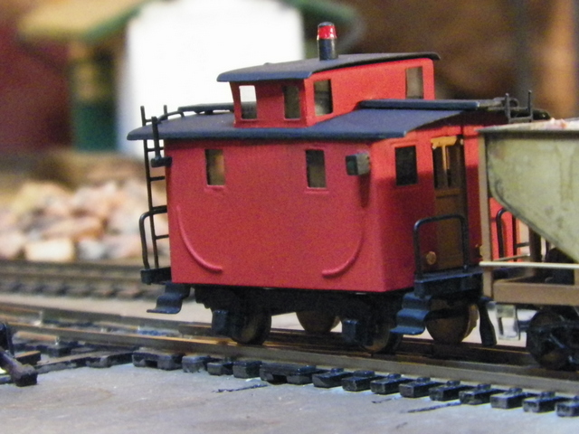

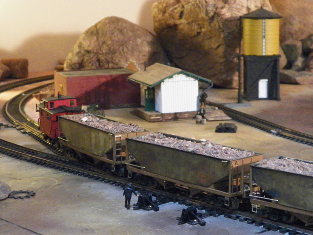

and . . . at last . . . on the road . . .

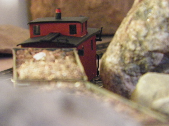

part of a train working in the canon . . .

Barry, you do very impressive work. Not only the caboose but all of it - nice hoppers too, they look good in their natural brass finish. And I think you are understating your patience!

Looks fantastic, better than it ever did before.

It all looks good. Nice old school consist.
Barry, braid can be found by stripping old shielded cable like coax. Some use a foil jacket, but any braided shield should be fine for this sort of job.

Thanks guys. And thanks for the tip regarding the coax Nelson. That is one thing about these old metal cars; seems like for the most part, if you screw up, you can take it apart and try and do better the next time (I hope it isn't like recording music where the first take ends up being the best!). Then, the issue becomes jumping in that cold water to redo the project. Yikes.
