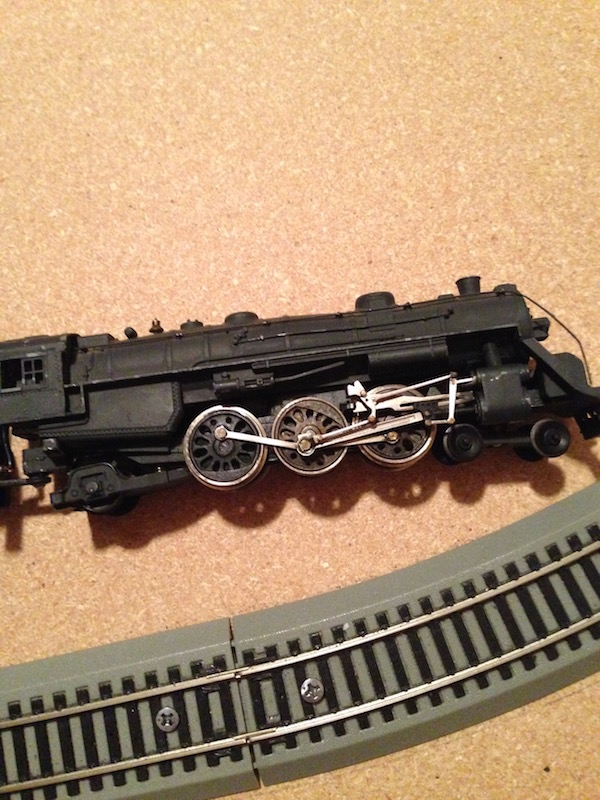

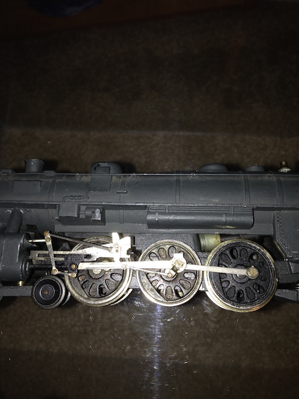

 Posted - October 05 2014 :  11:39:36 PM Link directly to this reply  Show Profile  Add kovacste000 to Buddylist

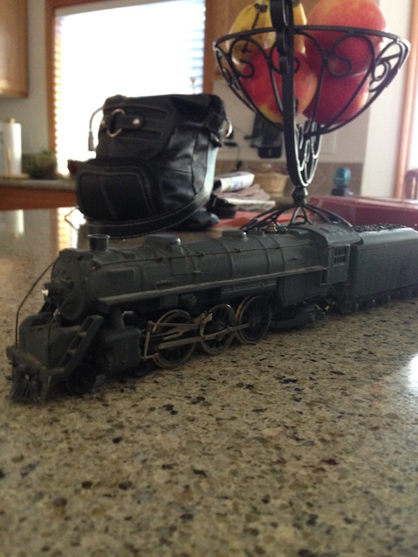

I finally got a Mantua 4-6-2 at the train show yesterday!First off, let me tell you guys about it.It's a Mantua 4-6-2 from the mid 1950's. Runs great, looks pretty good, it even has knuckle couplers.The only big gripe about it is that it has tons of problems on my Bachmann E-Z track curves. Thankfully, I do have another layout that uses Kato track which works just fine with it. It still shows a bit of a struggle on them on the Kato track, but it makes it through it without needing the slightest push. I got it for $30 along with a nice little box car which I'll show in next week's COTW. The guy selling it said he got everything he was selling from estates so there you go. Anyway, enough of the "backstory", let's get to the actual picture.
What do you guys think of it? I think it's pretty sweet.
Edited by - kovacste000 on October 05 2014 11:39:54 PM
 Posted - October 07 2014 :  9:26:33 PM Link directly to this reply  Show Profile  Add JNXT 7707 to Buddylist
I think you did good Stephen - a running steamer for $30

 Posted - October 10 2014 :  7:12:18 PM Link directly to this reply  Show Profile  Add scsshaggy to Buddylist
The locomotive just has problems going around Bachmann E-Ztrack curves due to it being too large for it. When it gets stuck on the curve, the wheels are still turning but the locomotive refuses to move because the wheels are overhanging the track. I tried on the Kato track too and it worked just fine on those curves. Now that you've read this, what do you think might actually be the problem if it's not the curves on my Bachmann track? And what brand of track would you use?
Originally posted by kovacste000 - October 10 2014 :  3:48:44 PM
This video:
http://youtu.be/SGj4SRt_Db0
shows a Mantua Pacific on what I think is Bachmann E-Ztrack (anyone here know if it really is?) and it makes the curve just fine. I think the radius is 18". I think there is also 15" radius E-Ztrack and I can't vouch for that. The scene with the HO stuff in it starts about 2:04.
You will see the train lurch occasionally. I think that is caused by the track being set up on outdoor carpeting. The weight of the engine presses the track down into the nap of the rug and flexes the rail joints causing loose connections between the rails and momentary interruptions in power. I'm not suggesting that that's Stephen's problem, since the wheels are still turning on his engine.

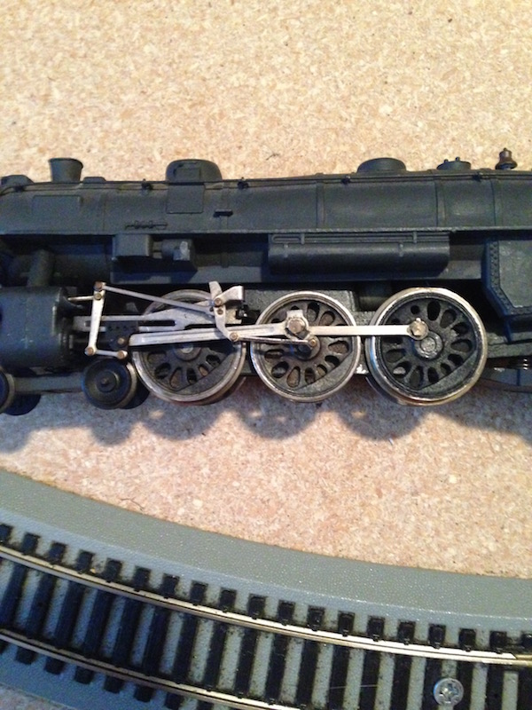

Stephen, I noticed that, in the picture of your engine, the gap between the cab and tender seems kind of small. Is there a custom made shorter draw bar? If so, could it be too short for the curve radius being used? That could cause some jamming and derailing.
Edited by - scsshaggy on October 10 2014 7:17:44 PM
 Posted - October 10 2014 :  9:26:27 PM Link directly to this reply  Show Profile  Add kovacste000 to Buddylist
Hey guys! I just found out what the heck was wrong with the locomotive. Apparently, the truck was too close to the front driving wheel, causing it to stutter and derail. Take a look.
After fiddling with the truck, it ran around my Bachmann E-Ztrack beautifully. I can honestly say it's one of the best running steam engines I currently own. Even rivaling some of my newer H0 steam engines.Not bad for $30 I must say. Especially with a nice box car.Oh, and as always, thanks for your help, guys.

 Posted - October 11 2014 :  7:08:55 PM Link directly to this reply  Show Profile  Add NickelPlate759 to Buddylist
Was the truck on backwards? That will make it interfere with the drivers. The longer end of the truck has to face forward.
 Posted - October 11 2014 :  7:25:20 PM Link directly to this reply  Show Profile  Add kovacste000 to Buddylist
Originally posted by NickelPlate759 - October 11 2014 :  7:08:55 PM
Yep. The trucks were on backwards because somebody who either built it or messed with it put the trucks on the wrong way. So anyway, where can I find a bell for my Pacific? I looked on Yardbird Classic's website and they don't have one for sale that would work with my particular locomotive. Where do I get it? Should I ask Yardbird Classics for the part? If there is a bell along with the holder thing for it to put on my engine, how do I put it on?I apologize for sounding a bit demanding, guys.

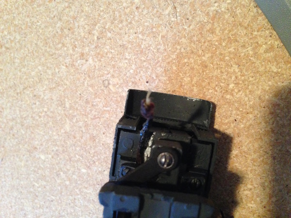

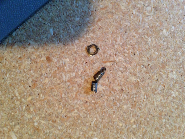

Originally posted by kovacste000 - October 11 2014 :  7:25:20 PM
You can find cast brass bells on the bowser-trains.com site under Cal-Scale. They're not original Mantua parts. They have bell brackets and all cast on and mount with a pin that presses into a hole, the way the Mantua bell does.
 Posted - October 12 2014 :  8:33:13 PM Link directly to this reply  Show Profile  Add kovacste000 to Buddylist
No, I'm talking about the one that goes over the headlight of the loco. I already have the bell that goes on the boiler of the loco. I probably should've made it more clear in my previous post.
Edited by - kovacste000 on October 12 2014 8:34:10 PM
richard p

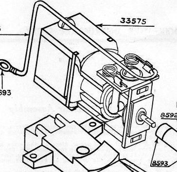

 Posted - October 13 2014 :  2:21:53 PM Link directly to this reply  Show Profile  Add richard p to Buddylist
The bell would attach with a tiny screw attaching the bell bracket to the boiler. You should email Yardbird and ask. I have seen them for sale before. They pop up from time to time on Ebay. If you get lucky ( I did) you can get the entire boiler with the bell for about the same price as the bell alone. This way you don't have to worry about the hole from the original bell. I think the engine looks much better with this bell. HO Seeker does not have Pacific diagram but the Mikado is similar.
http://hoseeker.com/assemblyexplosionMantua/mantua282mikadoinst1953pg06.jpg

 Posted - October 13 2014 :  7:01:59 PM Link directly to this reply  Show Profile  Add kovacste000 to Buddylist

 Posted - November 28 2014 :  2:56:00 PM Link directly to this reply  Show Profile  Add kovacste000 to Buddylist
I've got some bad news concerning this locomotive. The wire on it just broke while I was cleaning the locomotive today. Therefore, I have to bring it in to a hobby shop (or yardbird) to get it fixed. But until then, my pacific is as good as dead.
But, as I may have just showed, there's still hope for it. In fact, the new wire that we'll eventually get will probably work better than the old wire ever did, on top of the fact that all it needs is a new wire which should be too difficult to find and sauter to begin with.
Edited by - kovacste000 on November 28 2014 3:05:45 PM
 Posted - November 28 2014 :  3:13:56 PM Link directly to this reply  Show Profile  Add JNXT 7707 to Buddylist
Should be an easy fix Stephen, as well as an upgrade as you mentioned. It's a wonder that the wire lasted as long as it did!
 Posted - November 28 2014 :  3:24:00 PM Link directly to this reply  Show Profile  Add scsshaggy to Buddylist
If you have tin snips and a drill with a bit bigger than the screw and smaller than the post the screw goes into, it's easy to make the spade connector out of an old piece of brass. (I use brass from a spent .22 caliber bullet shell.) Add some flexible stranded wire, and you're back in business.
 Posted - November 28 2014 :  9:30:49 PM Link directly to this reply  Show Profile  Add kovacste000 to Buddylist
Turns out, it was extremely easy replacing the wire.And honestly, I have no idea how that wire lasted so long, either.Anyway, the locomotive has this bizarre issue where the locomotive overloads with both screws that go into the boiler in and works okay without them. It's truly bizarre.
 Posted - November 28 2014 :  10:08:38 PM Link directly to this reply  Show Profile  Add scsshaggy to Buddylist
Originally posted by kovacste000 - November 28 2014 :  9:30:49 PM
The following assumes that by "overloads" you mean an electrical overload:
It occurs to me as possible that, in soldering the new wire to the motor, you might have gotten it a mite high so that it's near the inside of the boiler when the screws are out while, with the screws tight, the boiler is pulled down to just touch the bare wire at the solder joint.
To test for this, you could put a piece of tape over that connection and put the boiler on. If the problem doesn't occur with that insulation in place, that was the problem. Otherwise, back to the drawing board.
 Posted - November 29 2014 :  12:33:23 AM Link directly to this reply  Show Profile  Add kovacste000 to Buddylist
Originally posted by scsshaggy - November 28 2014 :  10:08:38 PM
We put tape in the location of the wire connection to the motor that you see in the diagram I got from HOseeker's page.
I have no idea whatsoever what the problem is.My only hope is probably to bring it in to a hobby shop or Yardbirds Classics.

I finally got that problem fixed today.Unfortunately though, within minutes after my little "victory", this happened.
The linkage for this thing cracked much like those cheap Bachmanns from the 70s and 80s. First the front truck problem (understandable), next the wire problem (also somewhat understandable), now this?! Good gosh, I feel like this thing is against me.
 Posted - December 02 2014 :  01:22:28 AM Link directly to this reply  Show Profile  Add NickelPlate759 to Buddylist
Ouch! Well, we do tend to fall apart as we get older...
Did a side rod screw fall out on the other side, or did one of the drivers spin on the axle? A screw can be put back in, but if it's the latter there may be some zinc gremlins in the wheel castings that softened them up.
I had a set of drivers from a 50's Pacific in a parts lot, and the center on one pair on the insulated side swelled enough to make contact with the driver tire through the insulating strip. Dead short on the rails. The wheels also had a noticeable side-to-side wobble when turning.
 Posted - December 02 2014 :  09:40:32 AM Link directly to this reply  Show Profile  Add kovacste000 to Buddylist
Here's the other side.Apparently, when this happened, one of the back driving wheels popped off. However, I was able to get it back in tightly somehow. On top of that, before this happened, the locomotive started having issues on the track curves again for some reason.
Now my parents are calling this thing a piece of junk. I'm starting to wonder if I should think the same thing.
Autobus Prime
 Posted - December 02 2014 :  10:36:12 AM Link directly to this reply  Show Profile  Add Autobus Prime to Buddylist
Originally posted by kovacste000 - December 02 2014 :  09:40:32 AM
k:
<AUTOBUS SOAPBOX>
Truism: The average person's "junk" is the resourceful mechanic's "learning experience". A person who habitually takes that experience when it becomes available gains insight and pushes himself out of the primeval fog that clouds the average person's eyes when looking at technology. Those who the average person sees as technical wizards (and annoys to death whenever anything breaks) are simply those who took the experience enough times. You've leveled up once with the first fix, let's diagnose this and attempt a fix, and maybe level up again...
</AUTOBUS SOAPBOX>

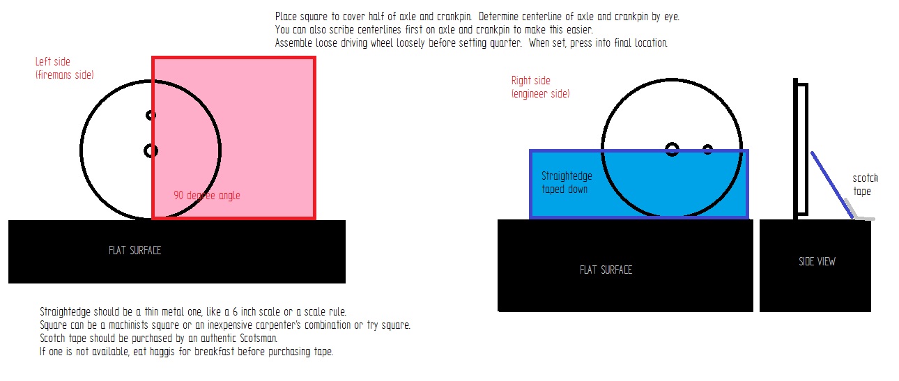

Your driving wheel is slipped. This happened on old Bachmanns for a different reason. On those, the axles were half-axles, connected by a brittle plastic sleeve. The sleeve cracked and allowed slippage. Your driver has slipped on its metal axle. The Mantua assembly is fixable without purchasing new OEM parts.
The loco probably started having trouble on curves when the driver started working loose. Wheel gauge has to be narrower than the track gauge. Too-wide wheel gauge and the loco will derail, and it will show up first on curves. Curves are curved, and rigid wheelbases are not. Too-wide wheelsets get pinched out.
You can press the driving wheel back on with some Loctite. The Loctite may help keep it in place if the fit isn't as tight as it should be. It looks like the insulated driver is the one that came loose, so no worries about losing electrical pickup on that wheel.
There is one further wrinkle to this learning experience: Quarter. Driving wheels are set with their crankpins rotated 90 degrees apart. This is needed to avoid 'dead spots' where all crankpins on both sides are in line with the axle centers. At this point, forces pulling on the rods could potentially rotate the wheel either way just as easily. This shows up in real life as a crank mechanism locking and binding. You can put together some Lego Technic gears with connecting rods to observe this in action.
At any rate, you will have to set these drivers in quarter. There are jigs for this but they cost a lot. You can do without the jig using a hard, flat surface, a steel straightedge, a reasonably accurate 90 degree square, and a reasonably accurate eyeball:
Hard flat surfaces can be a scrap piece of thick window glass (plate glass is best but modern window glass is probably close enough) or ground flat steel, stone, or iron. A piece of marble or granite countertop might well be flat enough.
Take all your driving wheel sets out and measure the good ones first, in your quartering setup. This will show you what the assembly should look like. Note that the quarter angle does not have to be exactly 90 degrees as long as it is the same on all driver sets.
Wheel gauge (spacing) is also important. If you don't have a NMRA sheet-metal gauge, measure what the other two driving wheelsets are with your 6 inch steel scale, and press yours to the same distance. That should be close, anyway. :)

 Posted - December 02 2014 :  11:51:16 AM Link directly to this reply  Show Profile  Add richard p to Buddylist
Junk?! Just remember that the engine is almost 60 years old and you have no idea how it was stored and for how long. I hope it can be fixed. Worse case is that you have an awesome display engine. You can also part it out and get pretty decent money on the metal cab and pilot.

 Posted - December 02 2014 :  3:56:25 PM Link directly to this reply  Show Profile  Add JNXT 7707 to Buddylist
Hey Stephen, that locomotive is almost as old as I am - it deserves just a little pass here and there! Patience, my friend!
Look at it from another perspective: it is older than dirt yet can still be fixed. Try saying that about today's super-detailed to the nth degree plastic showboats when they are 50-odd years old!
Plus, at the same time you are gaining knowledge very few people will have.

 Posted - December 13 2014 :  6:56:25 PM Link directly to this reply  Show Profile  Add kovacste000 to Buddylist
Anyway, I just got this thing to my local hobby shop and they stated that it'll be at least $25 total and that I should get it back within 4-5 weeks. Here's the card for it to prove it, I guess.
PRR 4800
MantuaShifterAvatar
 Posted - December 14 2014 :  4:06:20 PM Link directly to this reply  Show Profile  Add PRR 4800 to Buddylist
Teenager to teenager, a word of advice concerning this kind of thing. If the parents are complaining about some train-related thing of yours being a waste of money, just explain what happened to it and/or how to fix it, in enough technical detail that they get all glossy-eyed and go along with it. Works like a charm over here
And if all else fails, just insist that your money is your money, and if you want to spend it on what might look like rubbish, that's your decision, full stop. Lord knows I've been called out for bringing home boxcars that're missing ends... fallen apart... totally rusted out... crushed by a hammer... MOLDY... even one 40' reefer with 3 hatches, 1 ladder, mantua couplers, 6 spacer washers on each end, Athearn F7 trucks (!!!), and water damage.
And as for junk, your loco's FAR from junk. As several others have said, it must be kept in mind how friggin old this pacific is. Considering its age and how little it cost you, I'd say it's in pretty good shape. For example, I've got an old New One 0-8-0. It looks decent but pretty much can't be repaired (for reasons), but since it only cost me $10 I'd say all's well and I got a hella rad "shelf queen". Besides, it's not as though your cast pilot broke... then I might be a little more inclined to give up hope. Some mechanical repairs like this might be a pain in the a**, but they're doable... IMO it's when castings get messed up that things start looking bad. Anyhow, best of luck with your Pacific, man
--CRC
