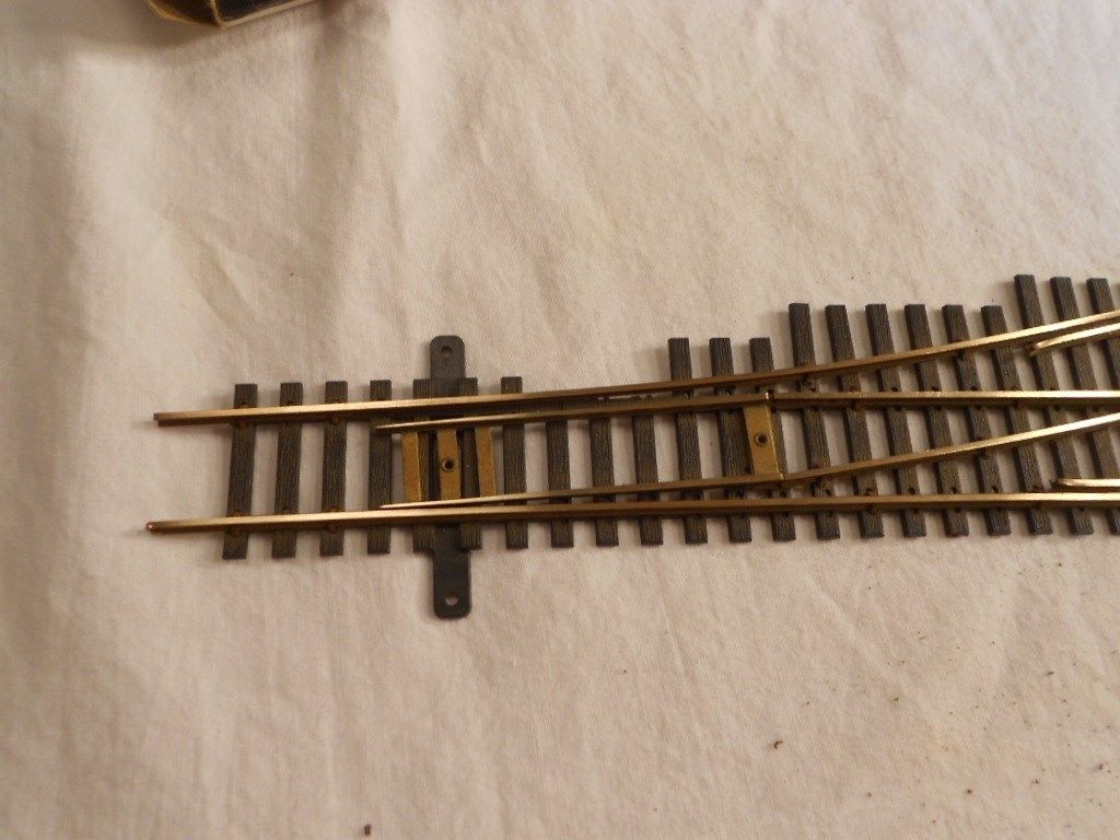

I have an old switch like the one pictured. I have no switch machine for it and need to know what switch machine works with this switch.

That's an Atlas box, but the switch doesn't look like any Atlas switch I ever saw, and it doesn't have the attachment points for an Atlas switch machine. The throw bar isn't designed to work with it either. I think that's some other brand.

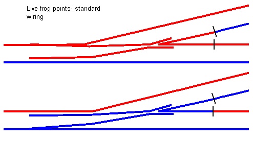

The frog is electrified and the points are connected electrically, so I think that the points supply power to the frog and closure rails from whichever stock rail they touch. That affects how the thing is wired. Either the points need to make very solid contact with the stock rails or you need relay connections on the switch motor to positively electrify the frog.
Both rails leading away from the frog will have the same polarity as the stock rail with a point touching it, so it's a power routing switch, unlike the usual Snap switch.
If mounting under the tracks is an option, I think the Tortoise is the best way to go and I think it has relay contacts for wiring the powered frog, as well.

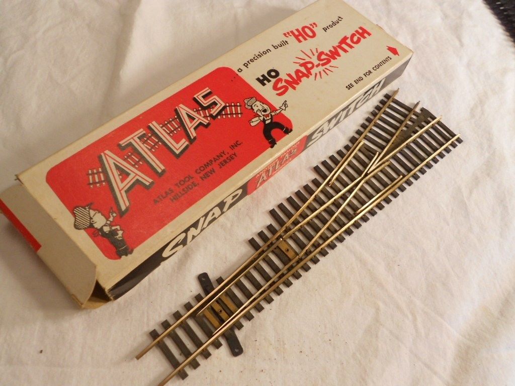

No, that's a circa-1960-ish Atlas switch. Fiber ties, rails stapled in place. They came in boxes like that both assembled and as kits.
For what used switches sell for, brass especially, I wouldn't use it, the fiber tie track is subject to warping and things because the ties absorb moisture.

I would tend to agree with Irvv. If use one then this may help with the rail wiring.
