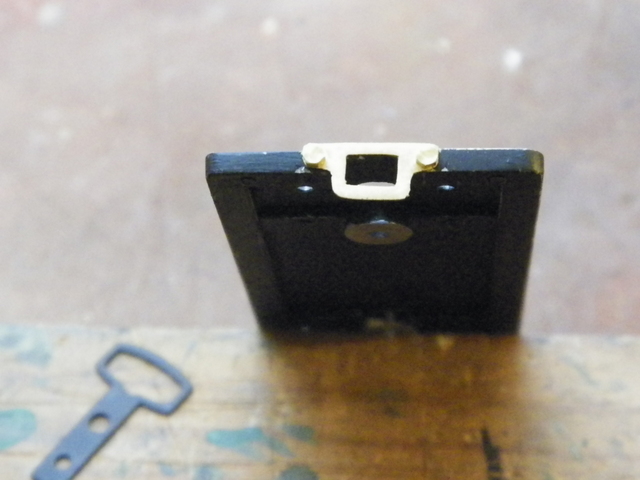

I'm continuing to be seduced by the old school Mantua stuff and I've recently decided to go for the gold and return to the use of hook and loop couplers (this in part due to someone remarking - forget who - about "prototype" for early steam not including "air hoses" hanging between the cars. Well . . . what the heck . . . if all that effort of finding the right Kadee and how to mount it neatly was in poor taste on my behalf, then . . . so

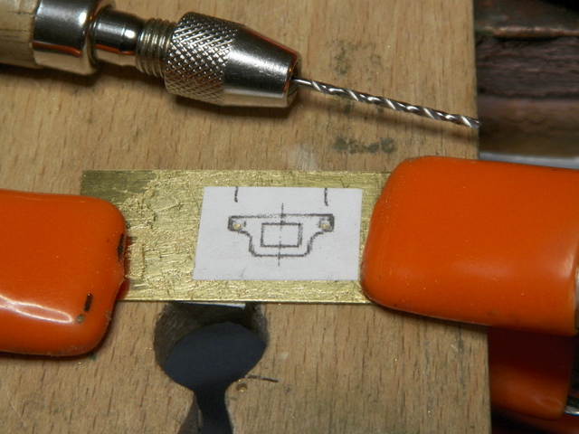

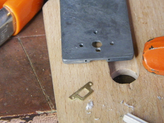

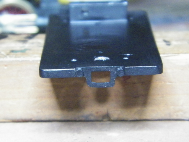

Getting the cars switched back will be fine; I never changed anything from original. The tenders on the other hand are proving a bit more work. None of the tenders I have came with the original bakelite coupler pockets. The following photos are of my fourth attempt (made it pretty close this time) . . . [Those are 0-90 hex bolts; sawed off to maybe 3/32? Turn 'em easy and don't force 'em . . . I'm going to be getting a tap & die for 0-90 to clear out a hole I busted one off in by being a bit too aggressive.]

Barry, I've been looking at the brass face of the coupler pocket that you made. The one photo shows brass, with a paper template glued to it, clamped to a wood block. I assume the wood block was a backing for drilling but I'm less clear on how you cut it. I find it hard to cut small pieces without bending or mangling them. I kind of remember you cutting the crosshead guide yoke for one of your Moguls by clamping the brass and using a jeweler's saw, but I would think that would mean putting the template on a board.
Long question short, how did you cut that delicate little thing?
 Posted - November 25 2014 :  9:23:44 PM Link directly to this reply  Show Profile  Add Barry to Buddylist
Don, it's one of those boards they sell you with the jewelers saw. It's got a notch cut out of it, like those things they keep on the floor to pull your boot off. Then there's also a round hole above the notch. So basically you can clamp both sides (the tapered notch lets you adjust how much you need "exposed".
Yeah, I was wondering whether I was going to be able to pull it off or not, but it seemed to work OK. In this case, I cut a bit outside the line and then filed the shape to finish. To do the center, I drilled a hole and then assembled the jewelers saw through the hole. You can turn a pretty tight corner with those tiny blades.

Barry, thanks for the explanation. It looks like there's a lot that could be made by a person who developed some skill with a jeweler's saw. I need to look into getting one and learning how to use it right.
