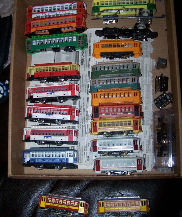

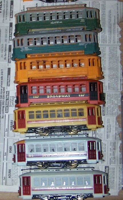

Here's a picture of my overall as-found trolley collection. Now I'll split them up and identify them.

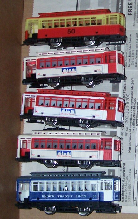

All the long trolleys are Bachmann Brill, ignore the orange one to the lower right. :) I have 3 chassis's , and two are probably junk, I may get one running out of the 3 units.

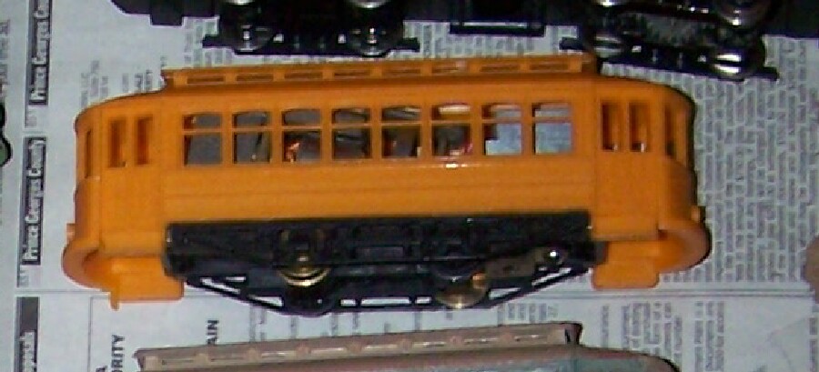

This orange trolley I can't find any ID on, it has a slanted motor, maybe a 5-pole. No markings on it that I see anywhere.

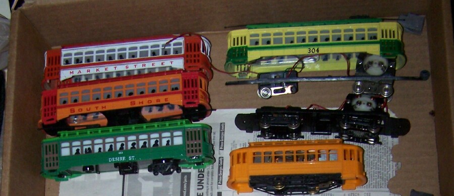

These are Mehano / RSO trolleys, only the top one is listed as RSO, the rest as Mehano, all are dummies, they have working lights, but no motors, I think these were part of the two-car trolley set that come attached.
All these bodies are Tyco, I have Nob Hill, Main Street, and Broad Street, plus some plain ones. Two run fine. I don't have enough chassis's for all the bodies, however

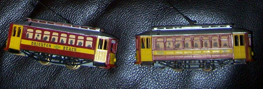

These two are Greenlines, they have metal chassis's and are geared. Neither will move, the motors appear locked, so I will have to take them apart and see what's jammed. I was able to ID these via an Ebay search, there's a 3rd version with a green and white body. I will be interested to see how these run.

Hi Jerry. very nice trollies. The orange one I know as early Mantua/tyco. I had a boxed set with the track street sections. Mine had no trolley pole, or a hole for one. On the box it was called a cable car.
* The 2 you call Greenline, I have some, and remember them as being made in japan and sold in the Silvine line of trains. Probably pictures will show up in old model railroader or craftsman magazines.

Yes, when I took it apart at work today, I found Mantua stamped into the weight inside. It's VERY different than the MU-2 design. Motor bearings were bone dry, got to seriously lube this unit before it will run. I did clean up all the contacts and points, that helped, but it's barely turning over, it's so dry.

I took apart one of the Greenlines/Silvine trolleys at work, it was also bone dry inside. The weight was showing signs of zinc pest rot, but the basic chassis frame was solid, and had no cracks. Whew! I noticed that there was a little metal man up front, pretty cool, painted even. Hope to get both units lubed and oiled tonight and see if they will run again.

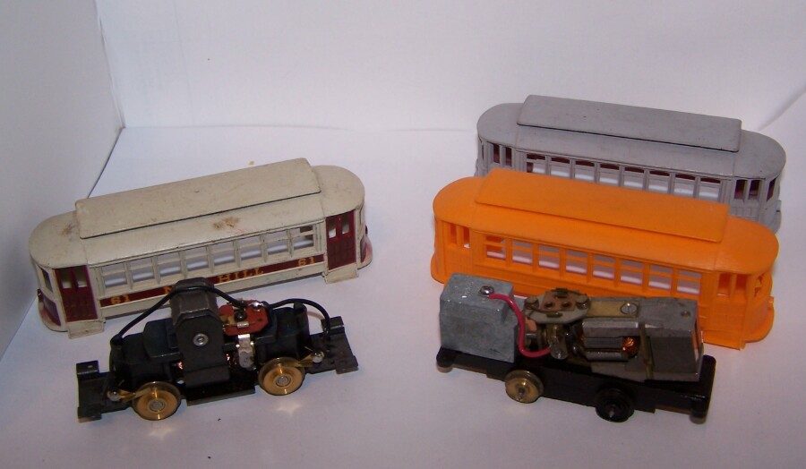

Trolley update - Frank / Toptrain is correct, I took apart the unmarked orange Trolley, and on top of the weight it is clearly stamped Mantua, or I should say molded in. So that mystery is solved. With some oil and lube, it finally began making some fitfull starts and stops around my stairway loop tonight. I think it needs a bit more work. Here's the comparison between the old Mantua, and the newer version( ha ha! ) with the NU-2 motor.
The old Greenlines trolley also got some lube and oil, and it is finally moving under it's own power as well It is also a bit jerky, but with a bit of run-time, it may smooth out some. I have to keep tapping it to get it going again. But it really needed that oil on the bronze bushings to wake it up, plus the grease on the axles was hardened up and restricting movement. Will keep tweaking on them. :)

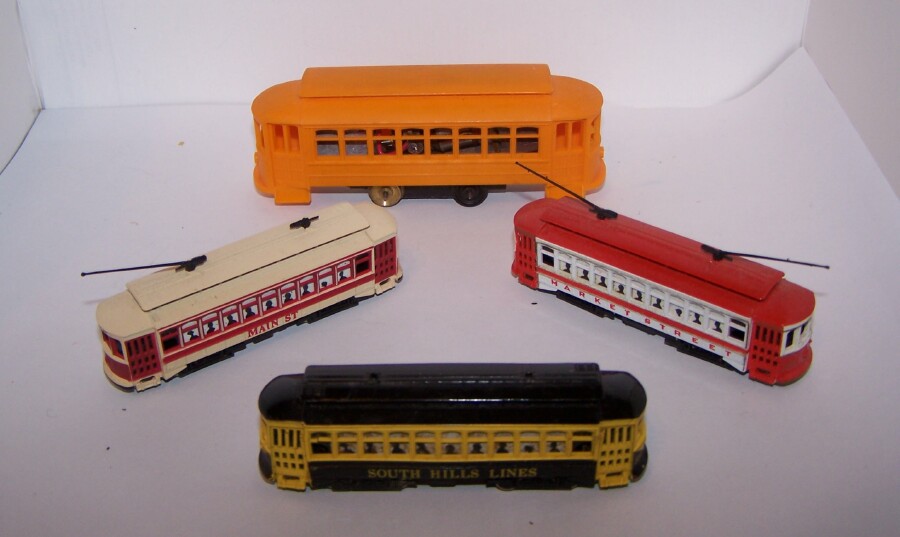

Anyway, here's a pic of the 3 N gauge trolleys I have.
The black and yellow one has a swelled motor, I'm not sure why. It was a club member's junkbox find. I think the other two were as well, but are in better shape. Haven't tried any of them yet. Will do so Tuesday. I'm whooped, and ready for bed now. :)
