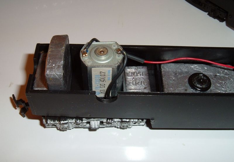

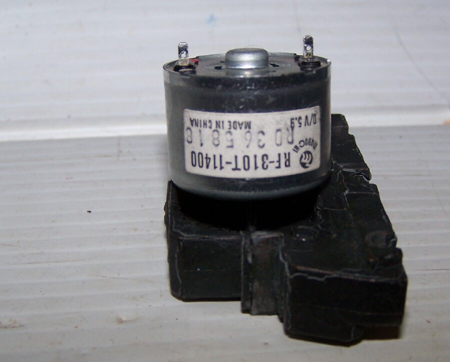

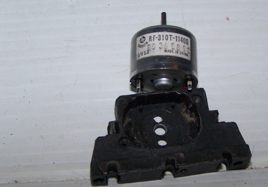

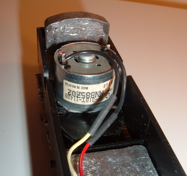

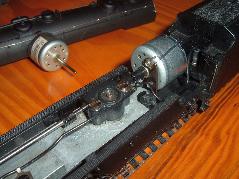

I have tons of those motors from CD or DVD ROM drives. They are commonly used as spindle motors or laser head positioners. They run fine at 15 volts, but are high RPM and tend to be weak at the low end.
Here are some installations.
This C-Liner truck finally got an FK-130, which has much more torque and lower RPM.
The Y6b has a gear reduction set installed, which is essential with these for a reasonable speed range. The Mabuchi pictured isn't the one that made the final cut. I went through a number of them and settled on a Mitsumi with lower RPMs. I also have a vertical motored version of the IHB 0-8-0 that got a spindle motor like the one in the background (main difference is the longer shaft) with a NWSL gear set.
It should power the PT truck fine, but it will be speedy and IIRC won't fit in the 2-8-0 tender without grinding the frame.
