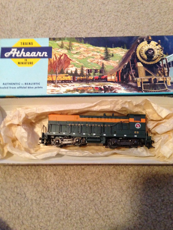

Basically what the title says. First things first, here's a picture of the locomotive itself.

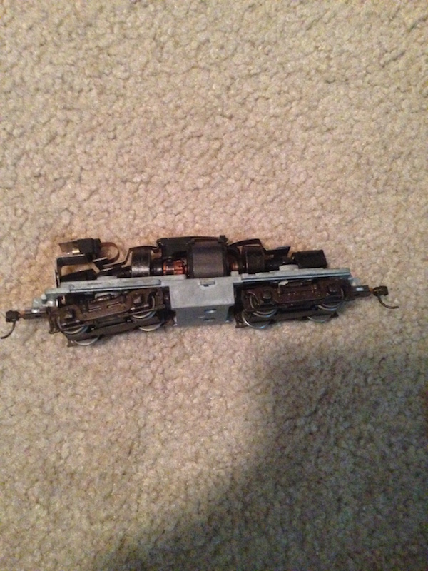

The light itself works just fine but when I put the shell on, I can't see the light shining at all through the little plastic light socket where the light should be shining. Here's a picture of the locomotive without the shell to help identify the problem.
Do you guys know what the problem might be? Any help is appreciated.

 Posted - August 30 2014 :  12:27:36 AM Link directly to this reply  Show Profile  Add Redneck Justin to Buddylist
May need adjusting down and back. Sounds like the shell is moving if off it's contact.

Well, make sure the headlight lens isn't filthy or obscured by something first. If you still can't see it you might want to replace it with an LED. Athearn loco headlights have always been rather dim in my experience since it's just a light shining inside the shell instead of directed through the leadlight lens, so this is a relatively common thing to do. These guys have some good information:

I actually put the shell at the level of where it usually goes and the light is actually lower than the shell itself. What that probably means is that the light is below the slot where it's supposed to shine which might explain why it doesn't light up while the shell is on. With that theory, I pulled the little metal slot where the light goes and brought it up to about the level of the locomotive. I'm going to test it on the track sometime today to find out if I actually fixed it or not. If that doesn't fix the problem, how do you adjust the shell or whatever part you're talking about? The shell fits just fine on the chassis and clicks in with no problems. And also, how do you clean the headlight lenses?

One reason the older Athearns were so "cheap" (as in "affordable") was due to their modularity. You had just a couple basic frames using common parts, that could underpin whatever shells they felt like tooling for a basic fit.
So yeah... you got headlights that didn't always align with the shell details and even when they did, you had mobile floodlights or haunted cabs. Part of the charm, and part of the price of being affordable. It seems silly given how basic the "fixes" can be, but having specific lightpipes and custom brackets and scale bulbs and whatnot, as required for an individual model type, all adds to the cost - as has been lamented here ad infinum.
I haven't modified that specific Athearn loco model but there are a few things you can try. As long as the bronze tongue in the light fixture can contact the truck tongue, you may be able to bend or shape the bracket for better aim. A better solution would be a smaller bulb with wires, fitted to the shell behind the lens. You can modify the mechanism any number of ways - by contrast, the shell has to mostly remain as-is to be "what it's supposed to be".

The problem with the S12 is that the lens is recessed well up inside the headlight casting far away the bulb, plus the bent the top of the bracket into a visor that interferes with the light. Bending it up as far as you can without hitting the top of the shell will help a little, but when I had my first S12 I cut it off entirely and got pretty good brightness out of it. Leave enough of a stub to keep the bulb retainer in place.
The best fix is to remove the bracket and mount a bulb or LED in a piece of brass tubing right behind the lens.
