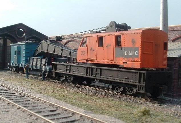

Shaygetz - That's an awesome photo! The lighting is just perfect... and I like what you've done to the crane. I've had something similar in mind for my crane, but I haven't decided on a MOW scheme.

I looked at that crane photo and though I knew it MUST be a model there's something about it! ...
Terrific work!

Thanks, Tony and G...I do appreciate the kind words.

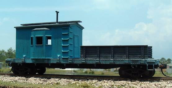

I got it in a box lot some time back and did my usual---trade out couplers for body mount Kadees, refitted with MDC/Roundhouse wheelsets...no reason other than they fit and were way better than the Tyco wheels. Then I weathered with chalks and flat enamels. The rust spots are a new thing for me, done by spot painting dark brown, allowing it to dry a bit, then drawing it downward with a wash of dirty thinner. I covered over the "Amtrak" moniker and lettered it as a second hand piece for my road. Posing it outdoors on a photo diorama makes for the lighting effects. I'm currently working on a new diorama that features a bridge for more dramatic shots.

That is Gawd-damm Awesome!
Inspiring in fact. I have to get a decent digital camera.

Shaygetz - Forgot to ask/mention: Is that a kitbashed crane tender? Where did the "caboose" portion come from? Looks good! Especially like the contrast of the blue tender to the orange crane - helps set "secondhand but whatever works" story.
 Posted - May 05 2007 :  11:03:19 AM Link directly to this reply  Show Profile  Add shaygetz to Buddylist
I appreciate the kind words, guys.
Tony, it's 'bashed from a Revell work train part I found in a box lot, the flat is an AHM, and the sides from a LL track cleaner carcass. I found it fascinating that every stake pocket lined up without work. I carved off the molded on roof walk, made a stack from a sprue, wire stirrups replaced the broken off ones, then did my weathering bit with pastels and dirty thinner.
