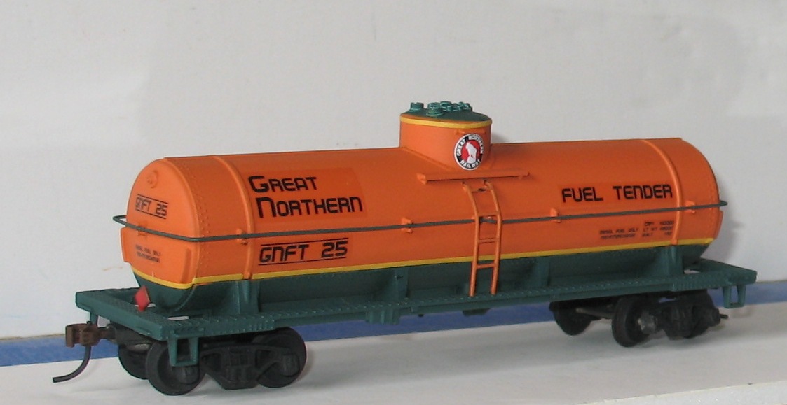

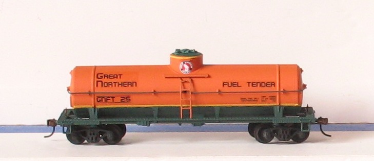

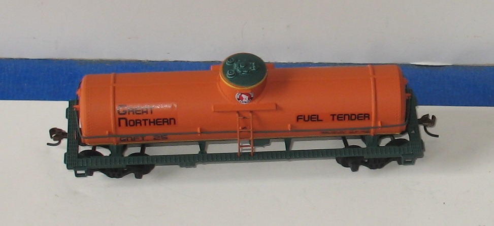

This started out as an idea for a final GN-themed "special car" that would go alomg with the several GN diesels I have in my inventory.

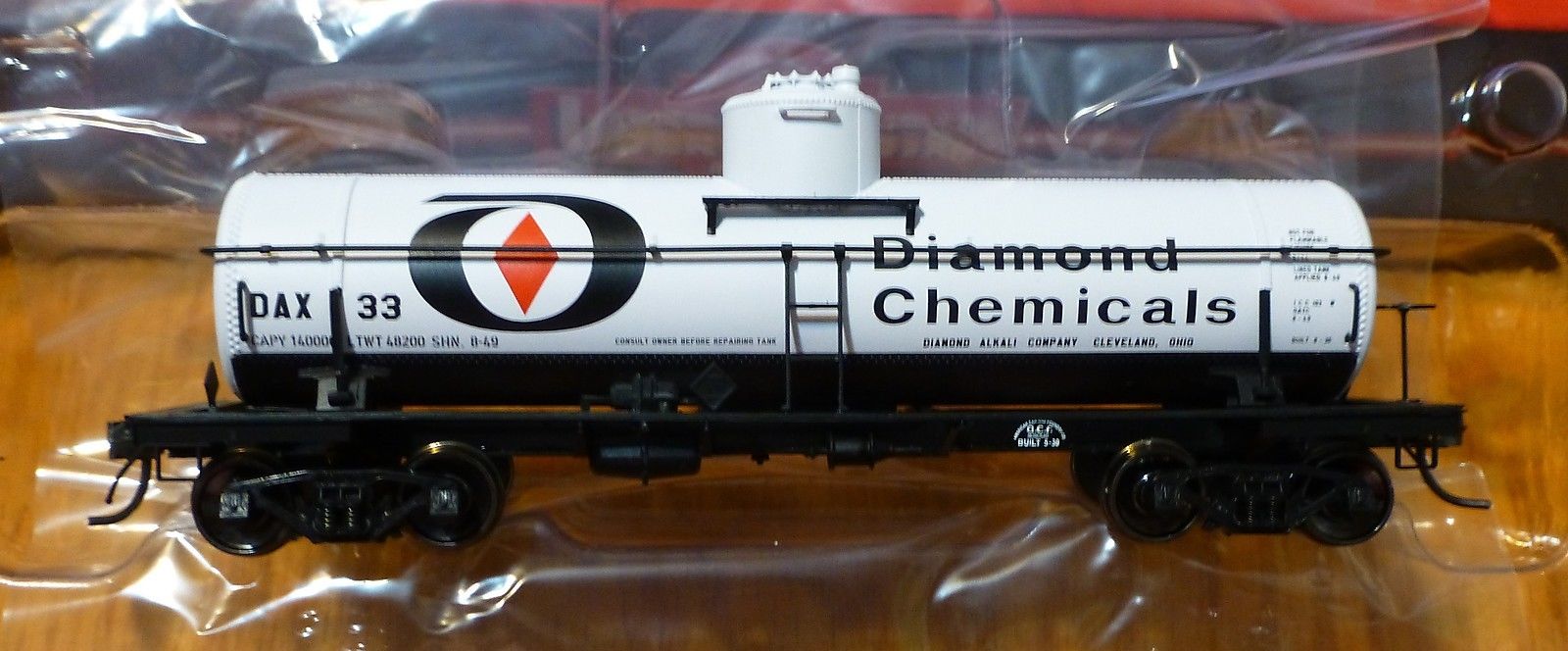

I picked up an old Mantua Diamond Chemicals tank car- old enough to have metal Talgo trucks and a metal frame under the tank.
I could not separate the tank from the frame, as it used plastic pop-in rivets in a one-time assembly method, so I had a lot of extra masking work to do. The wheels remain cookie-cutter Mantua originals, but I managed to open the coupler pocket to install self-centering kadee- clones. I used Rustoleum Dark Hunter Green (gloss) for the GN empire green; Krylon "Mandarin" for the GN Orange and for the striping-some yellow craft tape, cut to 1mm width, I found on a multi-color roll set at Office Depot.
I made my own decals, except for the GN Rocky logo, and DullCoted the whole thing after all paint dried. The tapelines are adhesive, but not seriously so, and the DullCote helps to secure them in place.
An enjoyable project- but challenging from a mask and paint perspective.

I've got the same Diamond tanker by mantua... a word of advice, if you're interested, a standard set of Athearn trucks and 2-56 screws is a dead-on exact fit to replace the old trucks. No filing/sanding required anywhere.
