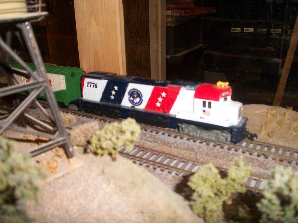

As much as I love Tyco, I am ready to throw my third attempt at a Spirit of 76 GP 40 over the garden wall. It almost always comes down to a split drive gear, you know that little tiny white one, that comes off the drive shaft?
Any suggestions for how to adapt and an Athearn chassis, or even an AHM chassis to the cute Tyco shell? I do not own a lathe or garage full of sophisticated tools.
In general, I have come to avoid Tyco locos like the bubonic plauge. Just waiting for my Tyco GG1 to split its drive gear. The older Mantuas seem to hold up pretty good, for the most part, although I have had to replace worn gears on them from time to time.

Metalsmith1, I will be studying your post you mentioned. Let me show the offending beast. You will note the power truck is a different color, that came off yet another failed Tyco.
http://www.tycoforums.com/tyco/forum/uploaded/Chops124/20140805035655_'76%20failed%20gear.jpg
The photo was taken at the very moment the gear failed, about a day ago.

A few words... first, this is a C430, not a GP40. Bachmann's the one who made a cheap-ass GP40 at the same time, not Tyco.
And speaking of Bachmann, that's the problem. The "power truck of a different color, that came off yet another failed Tyco" is not from a Tyco but from a Bachmann loco from the 80s, which used very similar means of mounting the trucks to the loco. THOSE are what you should be avoiding like the plague - they all have white plastic (nylon?) gears that ALWAYS crack. I have an ancient Bachmann U36B with the same truck, and the same problem you've described.

PRR 4800, why the assumption that he installed a Bachmann power truck? The front truck of the C-430 is the powered one, and this is clearly Tyco PT. If the rear truck is a Bachmann retrofit, then it's probably a dummy. Besides, the Bachmann pancake motor had a brass pinion on the shaft that wasn't prone to slippage which is what Chops is describing.
Chops, this gear problem can be easily fixed with CA, or a new pinion. PT trucks are a dime a dozen, so parts aren't hard to come by, including a matching rear truck. But if you would rather repower it with an Athearn chassis, more power to you, pun intended.
 Posted - August 07 2014 :  01:43:43 AM Link directly to this reply  Show Profile  Add Chops124 to Buddylist
I gently pried out the power truck, and low and behold the pinion gear,
on this apparently Bachmann truck, had merely slipped off center. A gentle
nudge and it went back into place. I will add a tiny drop of a CA. If
I can rummage up another power truck, I think I might replace
the dummy truck. Double the power.
