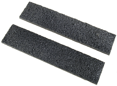

Believe I've used CM Shops 2-pack made for Athearn Quad Hoppers (Walthers #12-3104). They're $4.50 and I've had good luck dropping them in various 40ft. Open Hoppers.

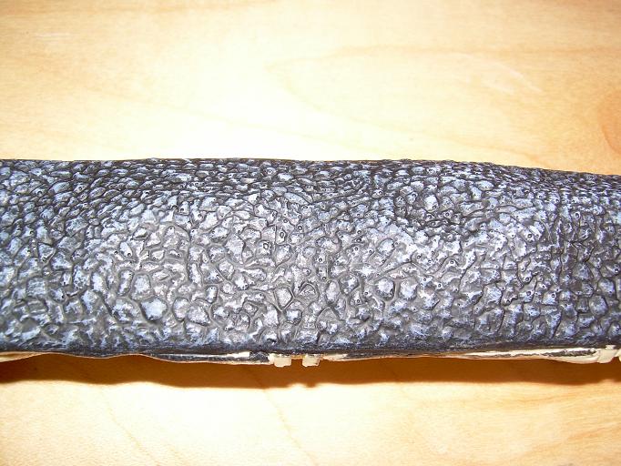

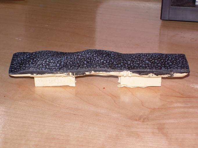

Here are a couple photos of my cast coal loads.
The first photo is of the complete casting. The cream/white color is what the resin looks like prior to painting. I only paint the surface that will be visible. The second photo shows a close up of the molded surface texture. The RTV rubber mold will handle much greater detail then the Bachmann piece provided.
