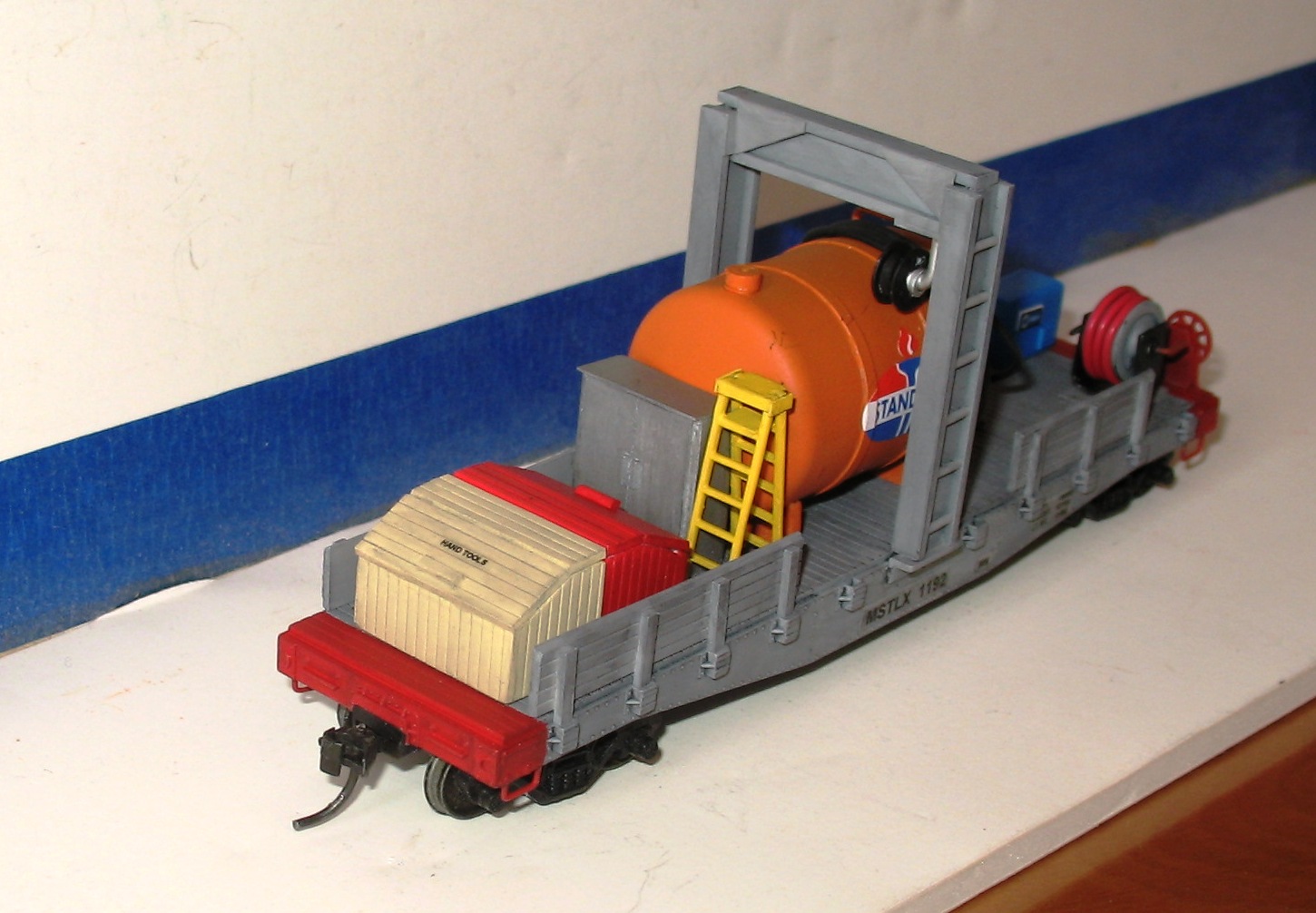

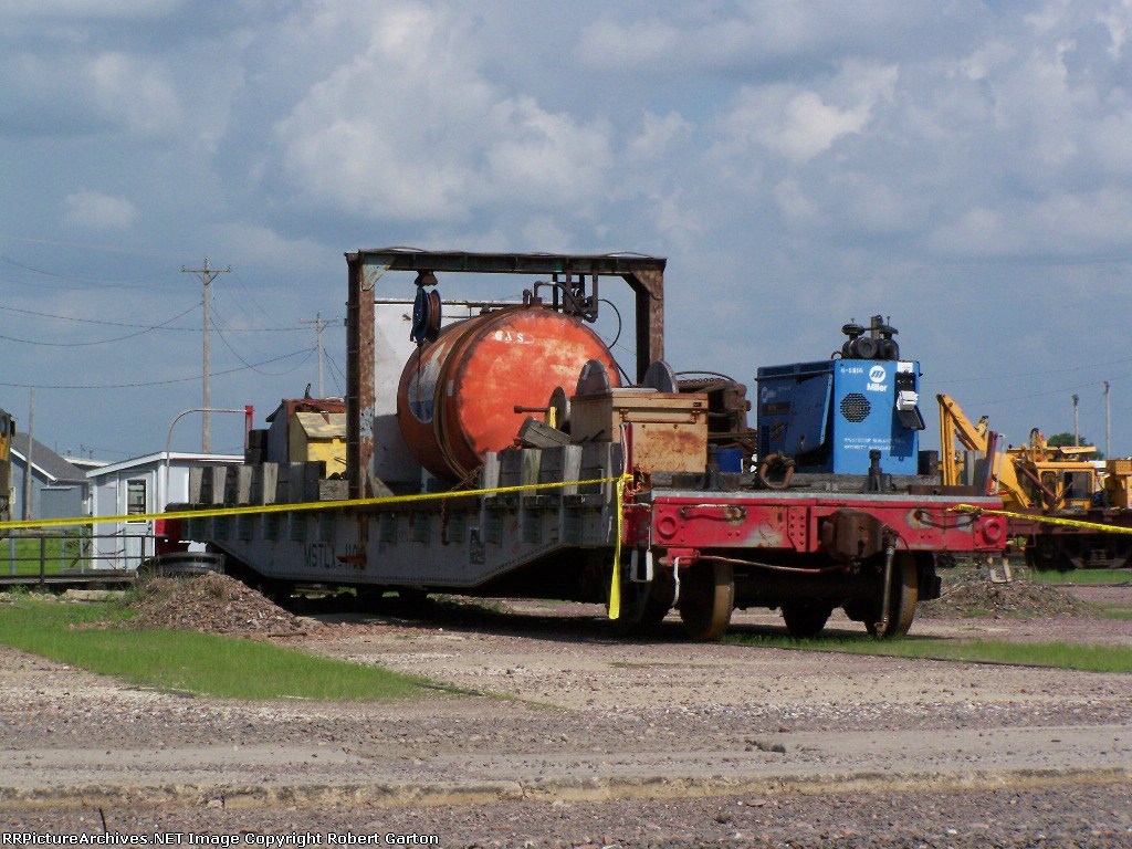

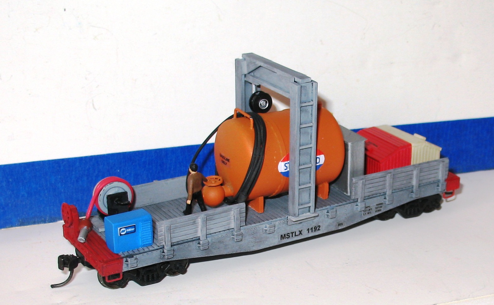

I started this car after seeing a RailPictures Archives image of an old Minneapolis & St. Louis MOW flat car online. The original:
I used an old 40 ft. Athearn BB flat car as the base, although a longer one could have been more appropriate, but with my smaller layout, the shorter version will have to suffice.
Everything above the deck level was hand-made from styrene pieces and approximately sized with an HO scale ruler, to replicate the objects in sizes that were relatable to a human HO figure, which I used on the final model as a scale item.
The tank was made from irrigation PVC pipe ends and I used steel piano wire for the four stirrups. Basic Walmart gray primer was ink-washed to suit, but I left out rust weathering effects as I am still not conversant in applying that type of effect.
The results:
Siouxlake Ron

Barry: the original photo has a "gas" label on one end of the tank, which I copied. Probably for refilling gas-powered generators or gas-powered tools?
Ben: The original photo shows a much-faded Standard Oil logo on the side of the tank- perhaps this was a stationary storage tank at one time. I haven't seen Standard Oil signs since I was a kid up in Minneapolis in the 1960's. (didn't they become "Exxon"?).

From my OP: "I used an old 40 ft. Athearn BB flat car as the base, although a longer one could have been more appropriate, but with my smaller layout, the shorter version will have to suffice.
Everything above the deck level (the cabinet, welding rig, girders, etc.) was hand-made from styrene pieces (girders are available from Evergreen or Plastruct) or styrene solid rods (the side rungs on the girder) and approximately sized with an HO scale ruler, to replicate the objects in sizes that were relatable to a human HO figure, which I used on the final model as a scale item.
The tank was made from irrigation PVC pipe ends and I used steel piano wire for the four stirrups. Basic Walmart gray primer was ink-washed to suit, but I left out rust weathering effects as I am still not conversant in applying that type of effect."
When I refer to "styrene pieces", let me explain- I took small pieces of balsa and cut them, using an HO scale ruler, to give reasonable dimensions to the objects I was copying from the real world photo. I then used .010 very thin styrene sheet cut into an series of "opend-box" panels, which I then wrapped around the balsa piece and CA glued closed.
The PVC pipe ends are found in Home Depot in the irrigation fittings aisle- I took another piece of .010 styrene and made a liner for the inside of one pipe end, which then allowed me to align the two end pieces when gluing together- again, using CA cement.
The piano wire was standard K&S engineering .025 wire, and I very very carefully drilled holes in the base of the flat car side sill, using CA to secure them. Two of the original plastic ones were already gone on the model I used, so I decided to just do all four as wire stirrups.
I painted and "weathered" the flat car floor first, but only after dry-positioning the separate pieces.
The "hose reel hanging from the girder came from two reversed ho scale plastic wheels, sanded flatter on their faces, inverted and CA glued togther.
The "hose" is actually that solid styrene rod wrapped into several loose ovals, then CA glued to keep its shape. All plastic work was done prior to individual painting.
I looked up Miller welders online to get an idea of the dimensions, then used thee above-described balsa-and-styrene wrap method to make the shape.
Siouxlake Ron
