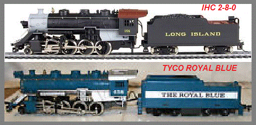

What about using the engine and tender frames from a IHC/Mehano 2-8-0 for the repower project?
