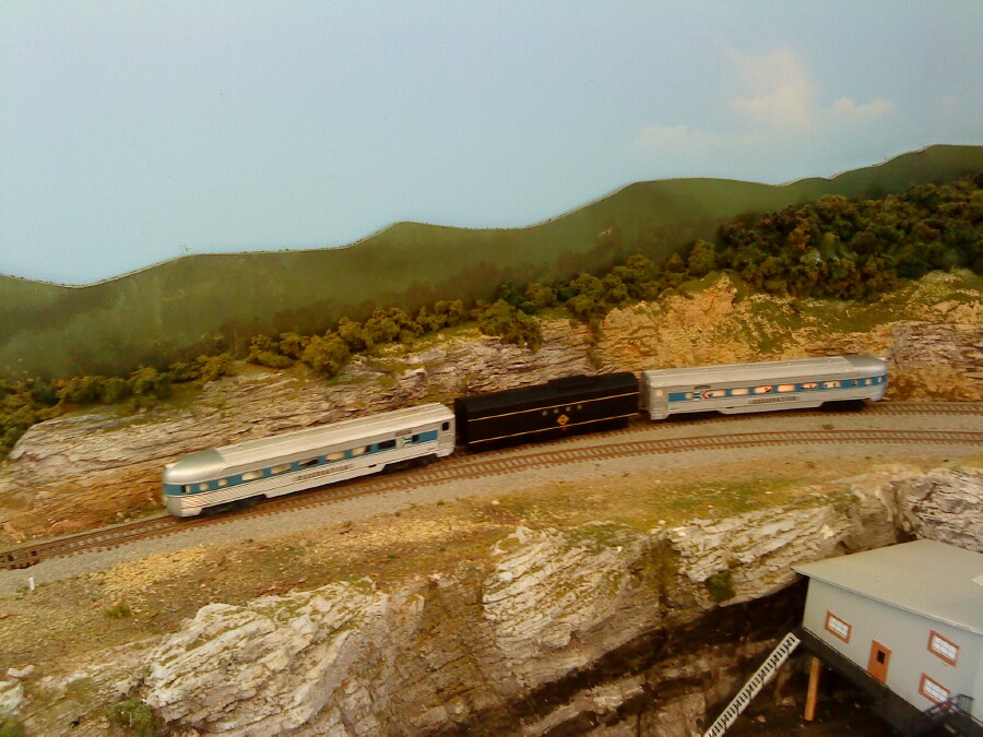

Hank, I believe JNXT has the right idea - use the RDC chassis's as a basis, as they're already powered. You can find Proto 2000 modern versions, or the old rubber-band drive Hi-F units. You would have to taper the end of the chassis to fit, but they are long enough to probably fit under the Observation body at least. I came up with an idea, which I'm still working on, I have two observation units, and a B unit F-7 in the middle. I bought a DCC B unit and run it like that, I call it the Silver Sausage, as it's an excursion train for sightseers. I intend later to possibly add Diner cars so they can eat as well on longer trips. I still need to body-mount the Observation car couplers, as they don't like being pushed around curves, but I've run this a couple times at shows, and it draws attention I like doing the unusual.

Your photos are great. Guess I better buy those 2 NYC observation cars I've been admiring. They can be repainted & named/numbered.
