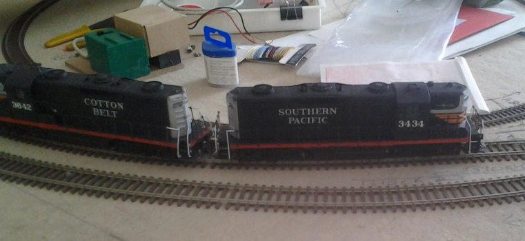

These are two of the four AHM GP9's I reworked and painted SP Black Widow. I milled and re-powered with a Sagami can motor and shimmed it so the drive line is straight as an arrow. I cleaned and burnished the gears so there are no burrs or flash. I milled and added the dynamic brake blisters from an Athearn Genesis GP9. The handrails were hand bent. I molded lead weights so now the weigh over 1.5 pounds each. They run smooth and quiet and each can pull a 50 car train up a 2.2% grade without breaking a sweat

Those are great looking units. If possible could you post a picture of one with the body off, and allow a view of the drive train.

I agree... I want to see what the drive train and custom lead weights look like. Some higher resolution shots of them with better lighting would help too, if possible.

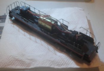

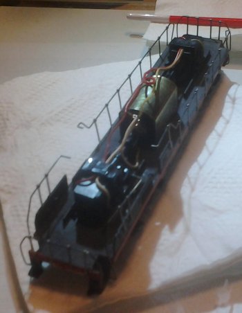

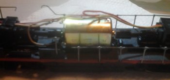

This is one of the works in progress...
I had to mill out the frame to get the motor to sit properly and get the driveline straight. I use a drop of 3M Weather Strip adhesive to hold it in place.

One of the important things in keeping them quiet is to make sure the driveline is as straight as possible.
The molded weight is inside the body, along the top. I actually melt the metal into the body and it conforms to the interior contour.

I see you used those Igarashi motors the owner of Hobbytown was selling off. Great motors. The custom handrails make a world of difference in the appearance. The over-sized plastic ones are pretty miserable, and are just part of the styrene frame casting, so they crack easily.
There were Atlas/Kato Alco single lead worms available that halved the speed, but I can't find them anywhere now. They may not be necessary with the new motors. The one noisy part of the drive train I discovered was where the spline shaft snaps over the little ball universal on the worm shaft. They are often a loose fit, and rattle on curves. I crimped the ends to tighten them up, and they were fine.
I'm amazed you were able to squeeze over a pound of lead into those shells. Did you use low temp alloy?

Yes, it melts at 158 degrees F. You have to be careful, while it MELTS at 158 it can get hot enough to melt the plastic.
