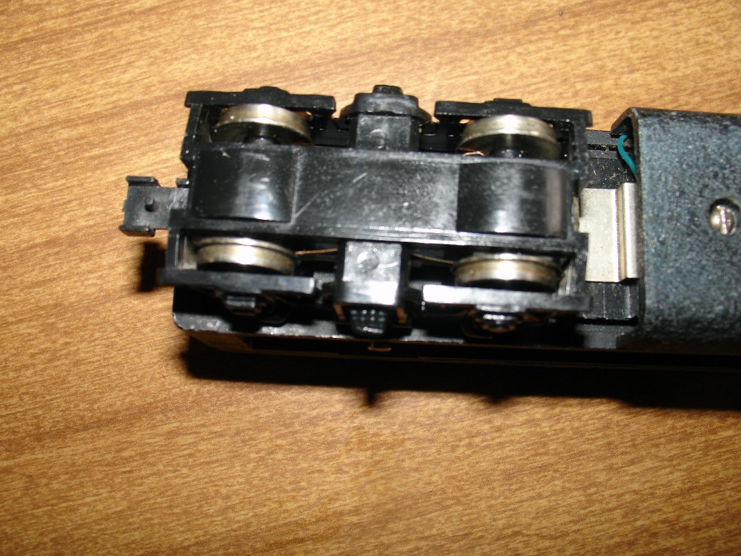

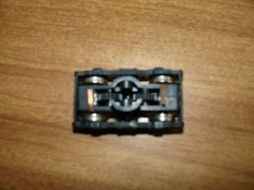

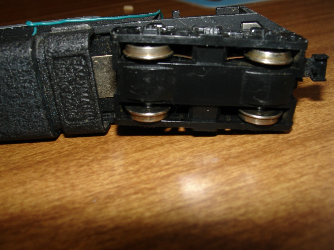

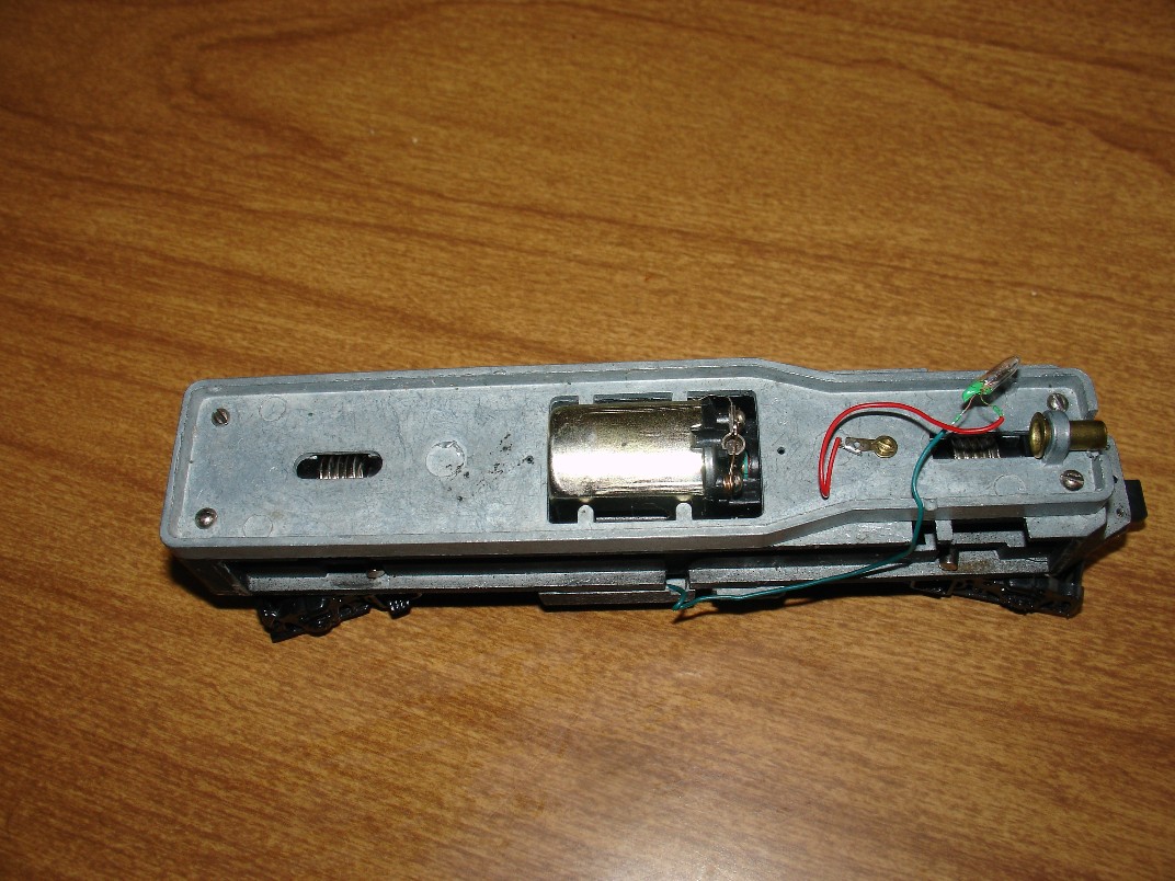

I recently got a Bachman F-7 unit that was not running. I striped it down and the motor was OK. The problem came down to the wheels and the wipers not making contact
I need some ideas on making a better contact wiper. There have been posts here on the forum regarding this problem, but I can't locate them. Can anyone help jog this old man's memory or tell me how you may have fixed the problem yourself?

Leo, the pickup on those units is excellent. In your photos the wipers appear to be well sprung against the wheels. The only issue I can see is that one of the wipers that rubs the chassis contact plates is bent downward. If you make sure that they all stick up at an angle and make good contact, there shouldn't be a problem.
One problem these do have is that the front edge of the contact plate that runs under the fuel tank comes too far forward and tends to catch the gearing on the front truck. I grind a rounded recess into the front of the plate to make it clear the gears.

I believe that's known as a Kader chassis, that Bachmann used. I have a few of those myself, they are heavy and run well when working correctly. Generally, no problems with the contact design, they usually are just in need of clean-up and get all the crap off the finger-tips, which clog up and cause the problem with continuity. Sometimes you have to pull the truck apart so you can bend the contacts in some to put more tension on the wheels, but other than that, they seem to work well when maintained. No additional contacts should be needed.
