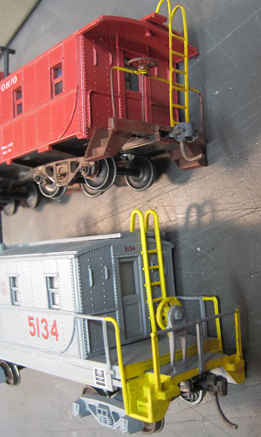

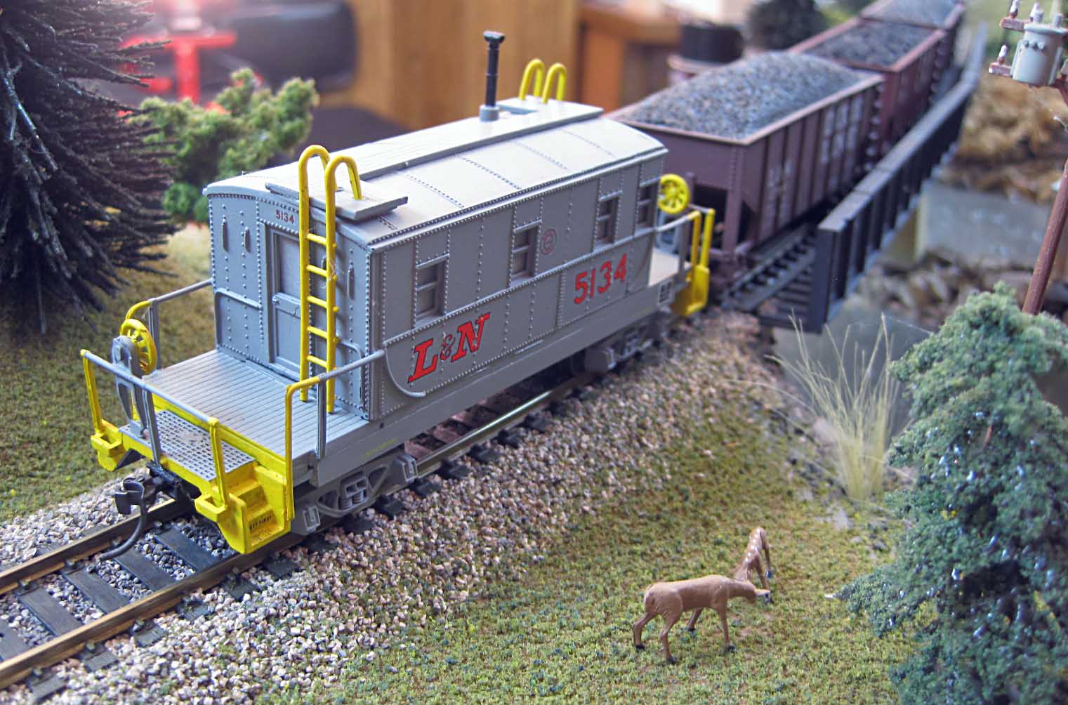

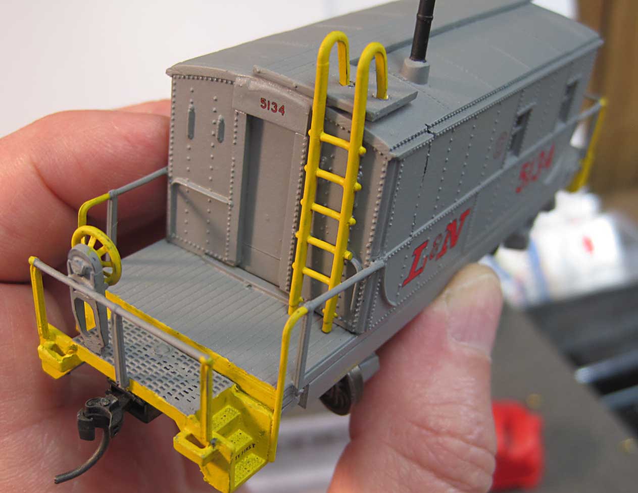

I had bought a bag full of HO train junk pieces at flea market/antique store a while back. Among the parts was an old riveted steel caboose shell with a cupola near the end - not sure if it was an AHM or an Athearn. There was also an AHM caboose base - looks like what's on some of my wide-vision cabooses with the snap-in trucks with truck-mounted couplers.

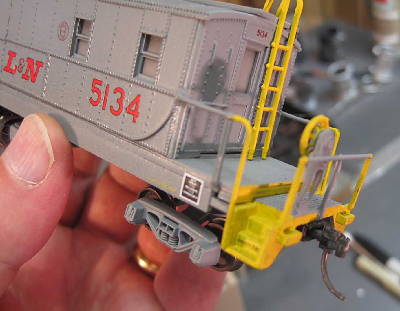

I had always wanted to try making a transfer caboose, so I thought I'd see what I could come up with. Would have preferred using a bay-window shell, but this is what I had! I cut a slice out of the caboose shell with a razor saw - more or less the part where the cupola sat - and then glued the two ends back together, giving me a shortened body that would allow for two 'porches' on either end. I also cut off the roof overhangs.

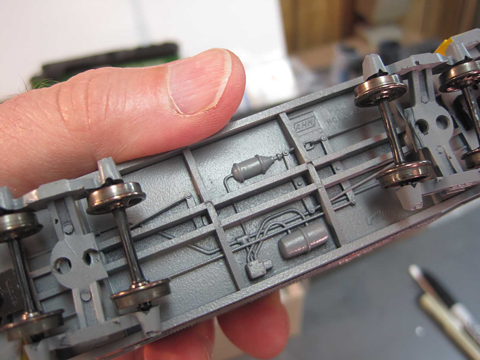

Because the bolsters on the caboose chassis were so big that it made the caboose sit very high off the rails, I added some strips of styrene on each side to cover the gap. I also added smaller strips of styrene on top around the edges, to be a framework and support the floor. For this I used sheet styrene that has the 'siding' surface, so it looks like wood flooring planks. I used the same type of sheet styrene - only thicker - to cut the roof walks from.
The ladders, brake wheel assemblies and smoke jack are from my parts box, as are the railings, which were originally off an old Bachmann DD40AX.

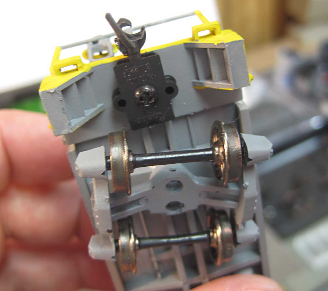

I found some snap-in trucks, used a MicroMark reamer on them and installed a set of Proto 2000 metal wheelsets, installed a pair of body-mounted Kadee #58 couplers, and painted everything L&N gray.
Finished up with L&N yellow on the steps, ladders and railings, and then some L&N caboose decals I had left over.

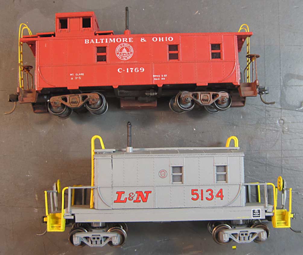

Pictured here with the type of caboose shell that I used, with the cupola slice removed.

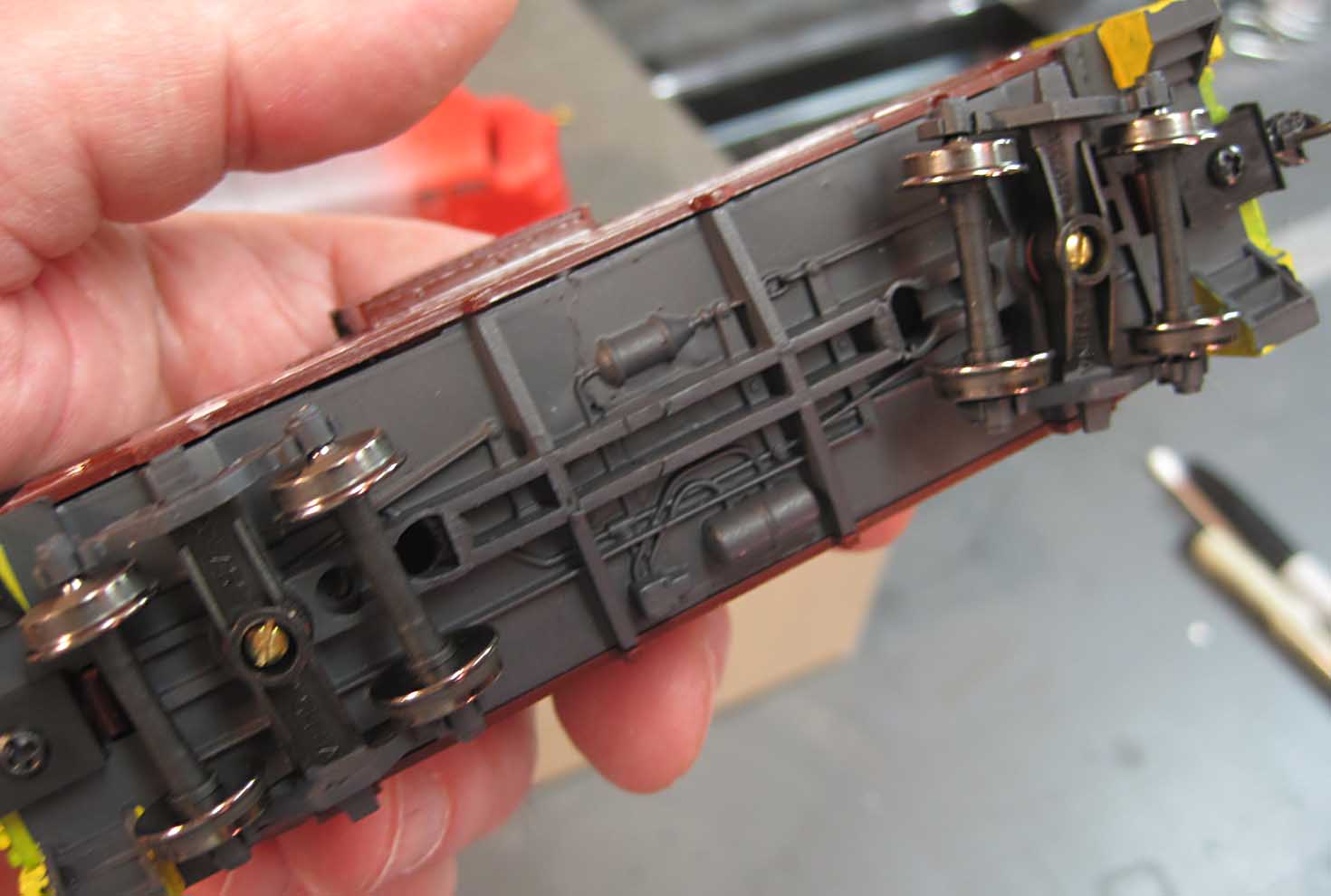

This is a similar wide vision caboose chassis like I used. Could be Bachmann.
It's somewhat crude in a way - as I said, I would have preferred using a bay window caboose as a donor, and a thinner cross section for the floor (possibly milling down the bolsters to lower the chassis), but looking on the internet at many different pictures of transfer hacks, I found the railroads did what they could with what they had, there were hundreds of variations. I ended up with a one-of-a-kind car, much like in real life, that serves its purpose. Dig in your own parts box and try one!

It's always fun to see what can be made of an assortment of unrelated parts. Nicely done!
 Posted - March 24 2014 :  7:52:07 PM Link directly to this reply  Show Profile  Add microbusss to Buddylist
nice job I sees these Transfer Caboose occasionally
 Posted - March 24 2014 :  10:07:54 PM Link directly to this reply  Show Profile  Add gmoney to Buddylist
Nice job! And plausible too, since the Clinchfield had some cabooses of the type you started with, and both L&N and Clinchfield were part of the Family Lines System.
