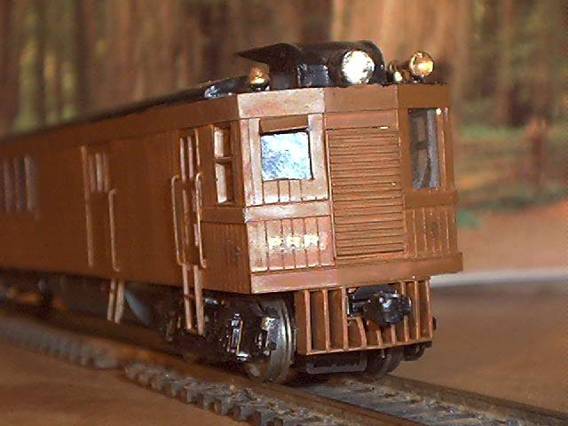

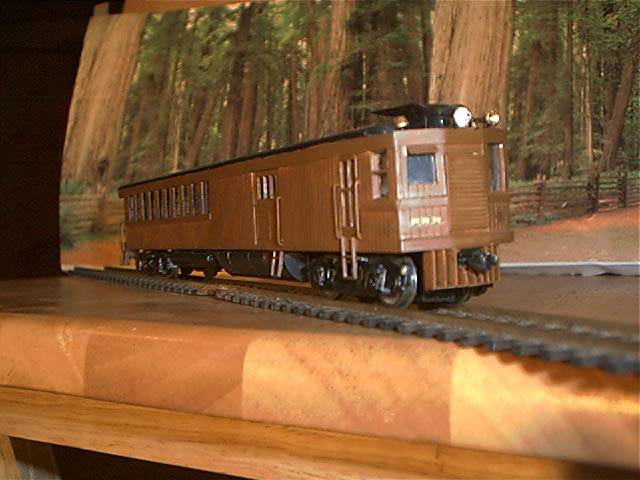

I used an Athearn switcher truck for the doodlebug I built.
If you have the Lifelike F7 chassis use it. Why not?
I like the idea of using the MDC coach or combine. I've seen an article on how to do it some where. I built the shell of mine from scratch.
Ray

 Posted - February 25 2014 :  03:18:00 AM Link directly to this reply  Show Profile  Add Erich to Buddylist
Originally posted by Ray Marinaccio - February 21 2014 :  7:49:32 PM
Hi Ray! it´s #60 I guess! -Erich

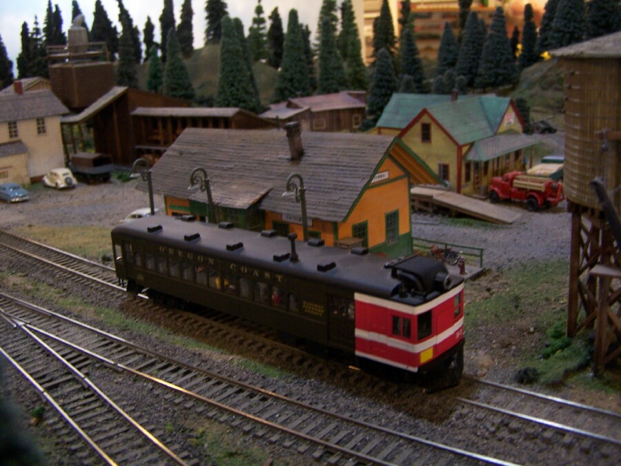

 Posted - February 25 2014 :  08:02:03 AM Link directly to this reply  Show Profile  Send AMC_Gremlin_GT an AOL message  Send AMC_Gremlin_GT a Yahoo! Message  Add AMC_Gremlin_GT to Buddylist
Here's one a club member has, I thought he had a shorter one than this, too, but I can't find a picture of it. Drat! Curses! I think this is a bit shorter than those long Bachmann versions.
