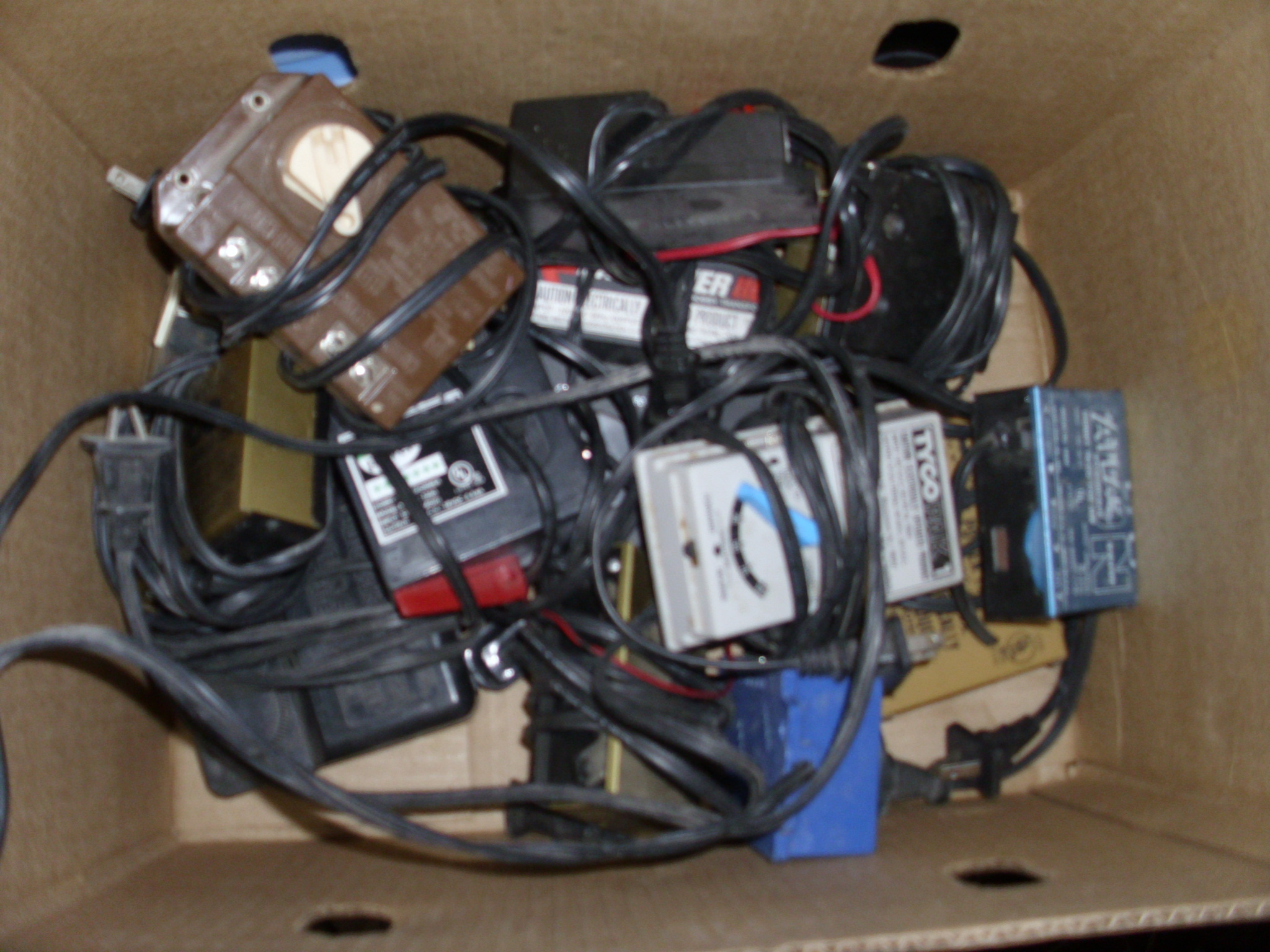

 Posted - February 16 2014 :  9:42:36 PM Link directly to this reply  Show Profile  Add microbusss to Buddylist
Yeah! me for one, JNXT 7707!
I get used DC stuffs cause its cheaper
Tho I could use a better transformer than these
SEE??
