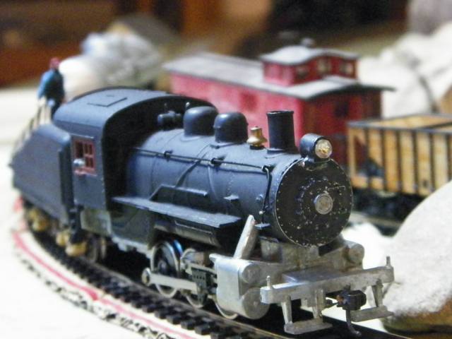

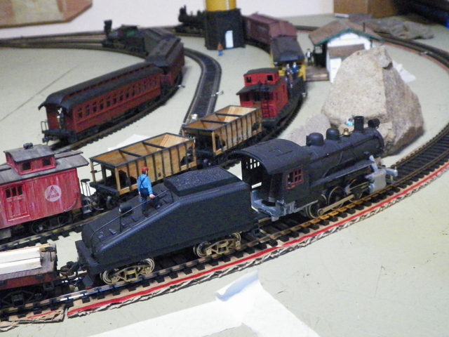

Hi Ken, I got intrigued by those slope back tenders when I discovered the railroad that I'm sort of trying to model (Colorado Midland) used a few of them during construction of the railway; squeezing them in places their bigger stuff couldn't yet get into. In the first photo, the CM 0-6-0 is helping with the construction of a small trestle near Douglas City, Colorado in 1887 (it amazes how much track was laid over seemingly impossible terrain from the time construction began in 1886) . . .
So . . . I got me a Mantua 0-6-0; most affordable and appealing to me at the time. MEW or Hallmark, I believe, make some CM replica 0-6-0's, but there seems to be an at least $500 price difference. And I like the way the Mantua is built. You can see in the photograph above, that it's a pretty good stretch to imagine the Mantua being a replica of the CM locomotive. Perhaps at some point, I might try and round up another one and mess with it (e.g., scratch a wooden cab, change the headlight, detailing the inside of the cab to camo the motor a bit, etc.) to make it a closer resemblance.
Presently, mine is a work in progress. There's a pair of Precision Scale Co. trucks on the tender (which do match the ones that Mantua made, and I have the Mantua trucks; they just need a tune up) that really make this thing run smooth and slow.
One thing I dig is the nice letter "M" on the front of the smoke box. I keep day dreaming about how it will look nicely painted with that M brassed-up against a nice mineral red number plate. Now . . . where did I put that elbow grease?
Regarding the rods and such; it seems to me that Mantua must have made some models with the more "complex" rods and linkage, and then some other models without? What do you think/know?

Barry,
A few thoughts about 0-6-0's:
1) For sheer utility, the 0-6-0's you have are great little engines. I have two of them and they do most of the yard switching and peddler freight service on my layout. They just keep going and going.
2) The Mantua 0-6-0 is proportioned quite a bit differently than the CM engine. The CM engine had a narrow, between the wheels firebox allowing for a lower slung boiler. Model Die Casting made an engine that was more similar in proportion to the CM engine, but I have found MDC engines a little harder to keep going than the tougher Mantua products.
3) I have been on a waiting list at yardbird trains for quite some time, waiting for some valve gear to come along for Mantua 0-6-0's. This is the Walschaerts valve gear which is outside the main rods. The CM engine you are trying to emulate had Stephenson valve gear which is hidden inside the frame. It might be easier and better to just mock up the valve rods as in the picture of the CM engine.
4) That CM 0-6-0 is an interesting specimen. For a switch engine, it's really quite large. That headlight must be 5 feet tall, and the guy standing by it looks like he'd fit down the smoke stack. This is good, because the Mantua is no lightweight, either.
Anyway, that was an interesting posting. That 0-6-0 out on the main in work train service is something to think about.

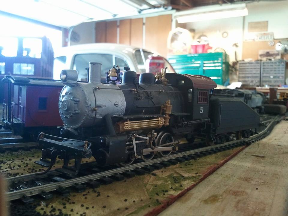

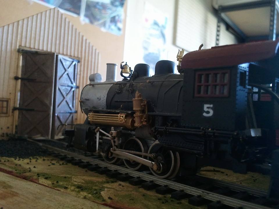

Ohh Barry
Check out my latest acquisition. A heavily detailed Mantua VALVE GEARED 0-6-0 "big six"
$30 later and I'm still drooling
Since this photo it's been thoroughly cleaned and runs pretty good. Need to repair the engineer sider timing rod and lube the motor up a bit.

Ohh Barry
Originally posted by SCVR66 - January 03 2014 :  01:24:38 AM
If you went to buy the detail parts for that conversion, now, $30 would NOT cover it.
That's one sweet job of detailing.

 Posted - January 03 2014 :  1:59:47 PM Link directly to this reply  Show Profile  Add SCVR66 to Buddylist
Certainly.......fortunately for me all the customizing which was an oil bunker, bass air compressor, brass whistle, brass steam exhaust, brass pop valves, and brass bell and brass air tanks were all done years ago.
A buddy of mine messaged me saying hey there's this guy who's been trying to sell this mantua steamer for months on this other forum with no luck.
I told him send me a picture and as soon as I saw the oil bunker, the valve gear, and added parts I knew I HAD to have it. And $30 is a good deal if you ask me.

Well Hyde, you did get me drooling. You sure got a bunch of nice brass detail with that. And Frank, that is interesting to hear that term "alligator crosshead". I do like those Roundhouse locomotives and they have some nice independent tender kits that I've seen; one in particular is like that behind Frank's and that looks much more like what I want to model than the Alco type (if I have that Alco business correct). I would like to get into doing a bit more with locomotives (other than paint) and looking at these great photos gets me closer to doing it.

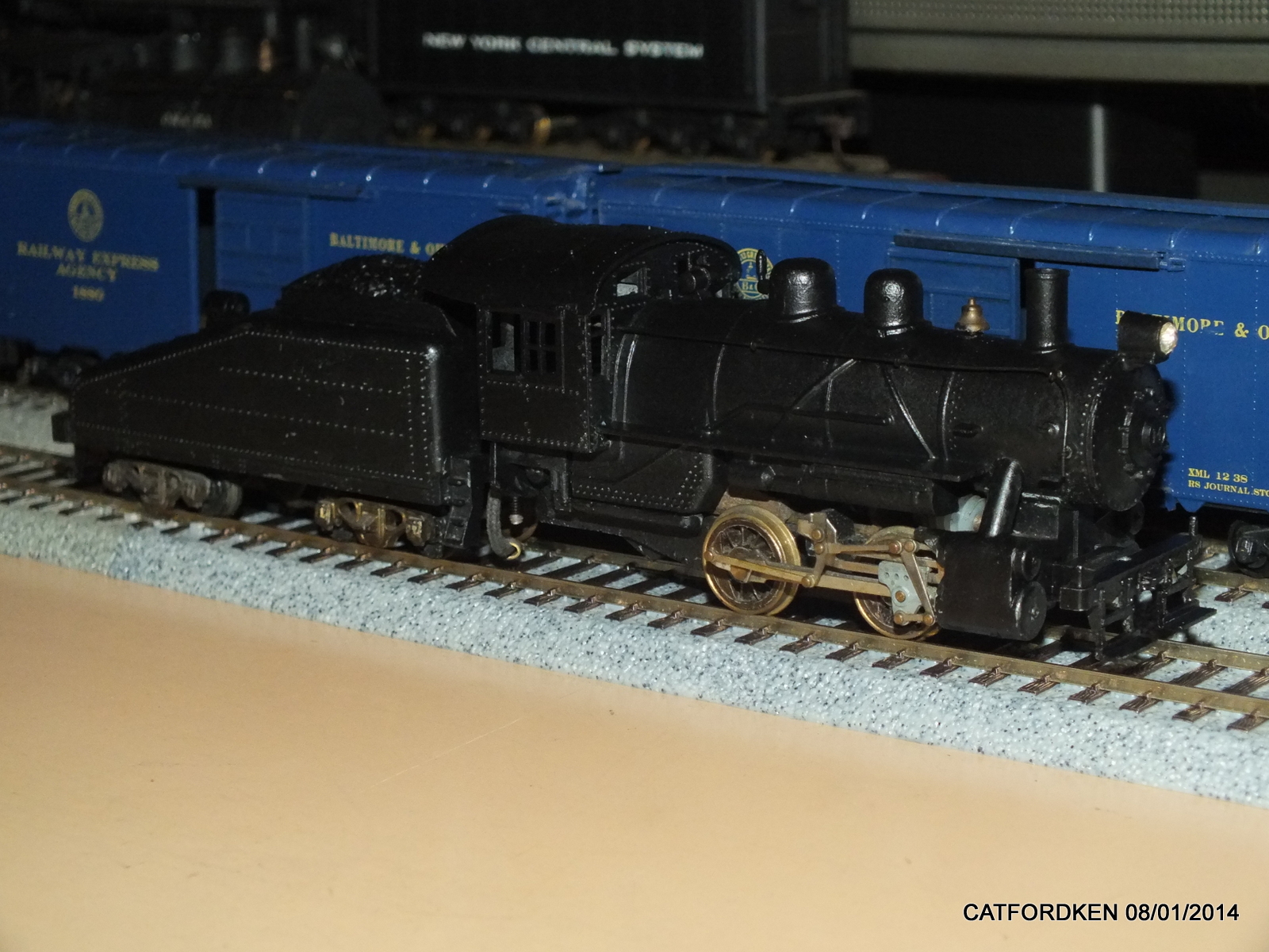

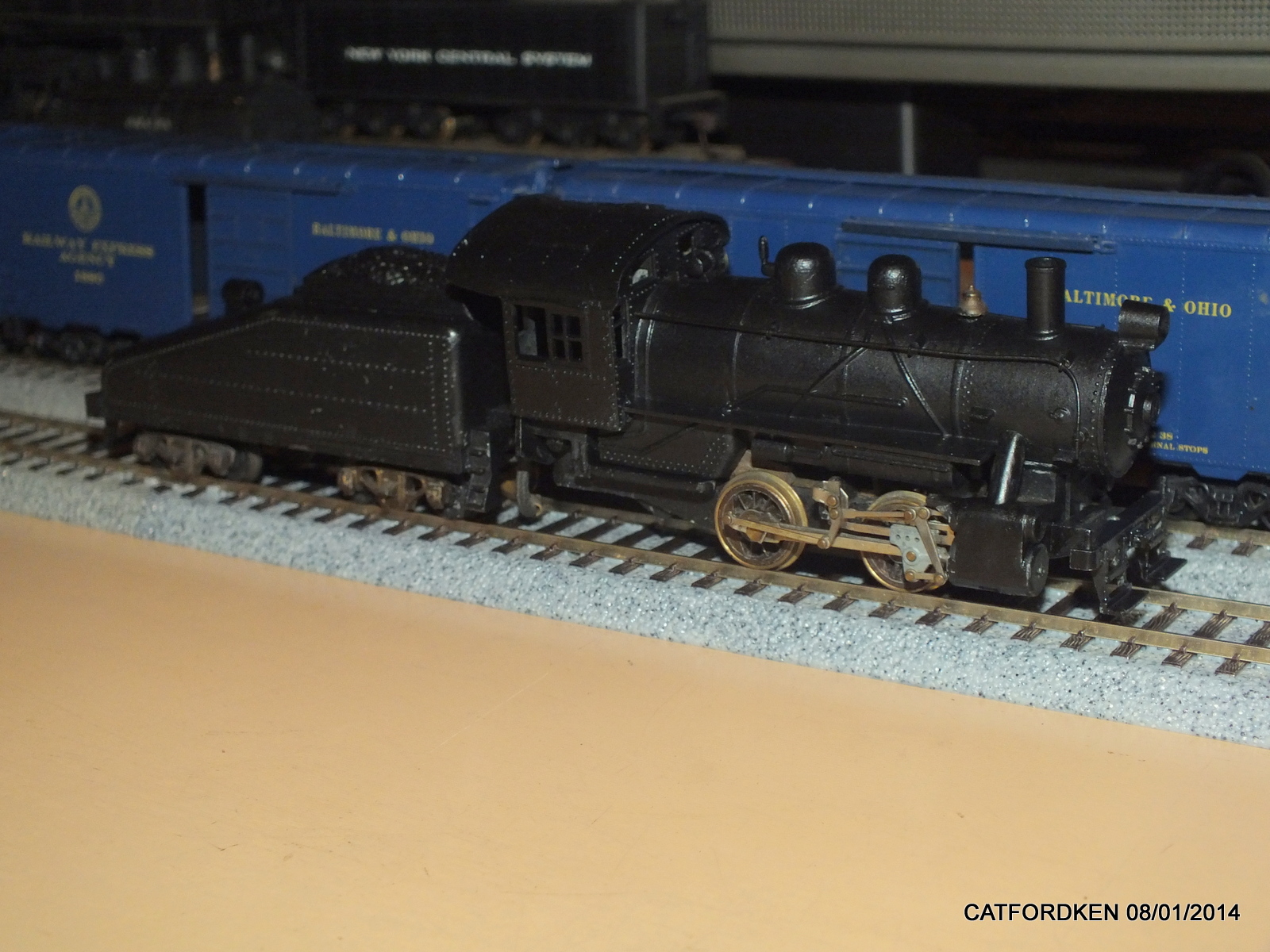

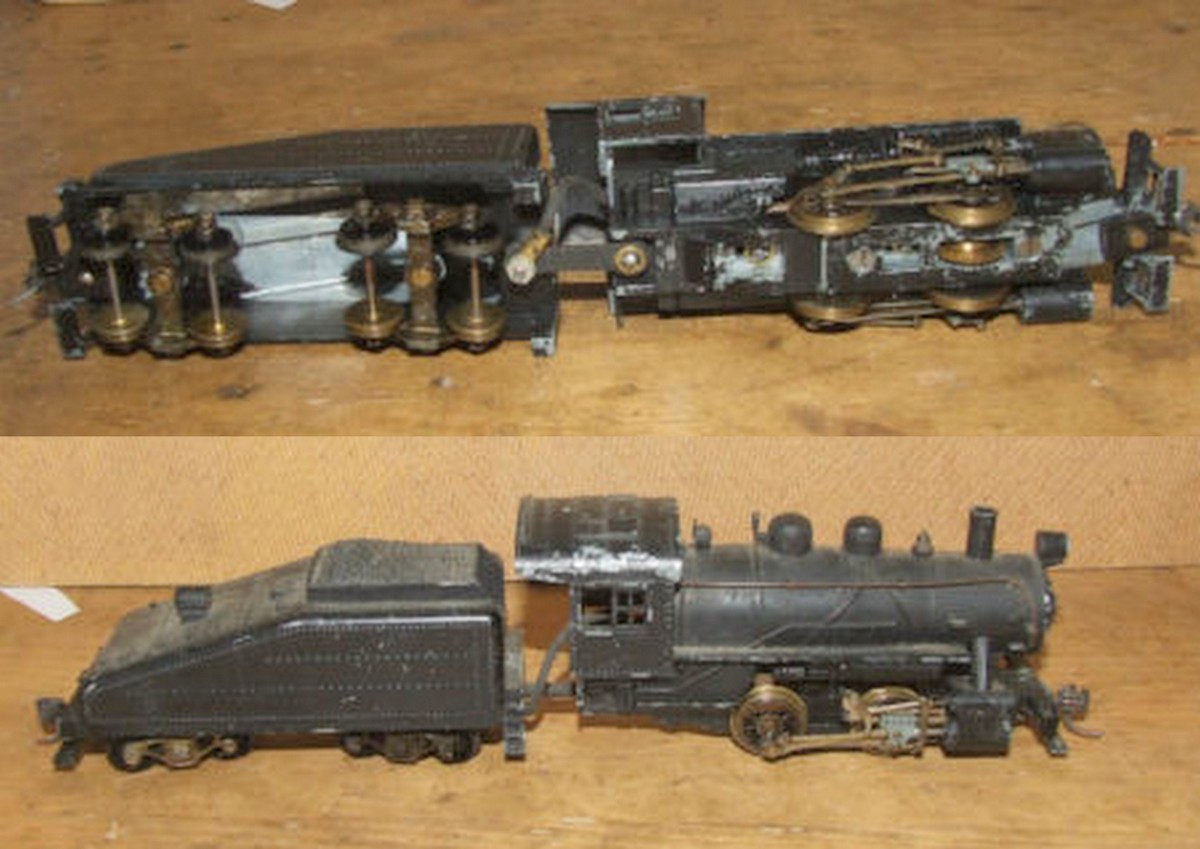

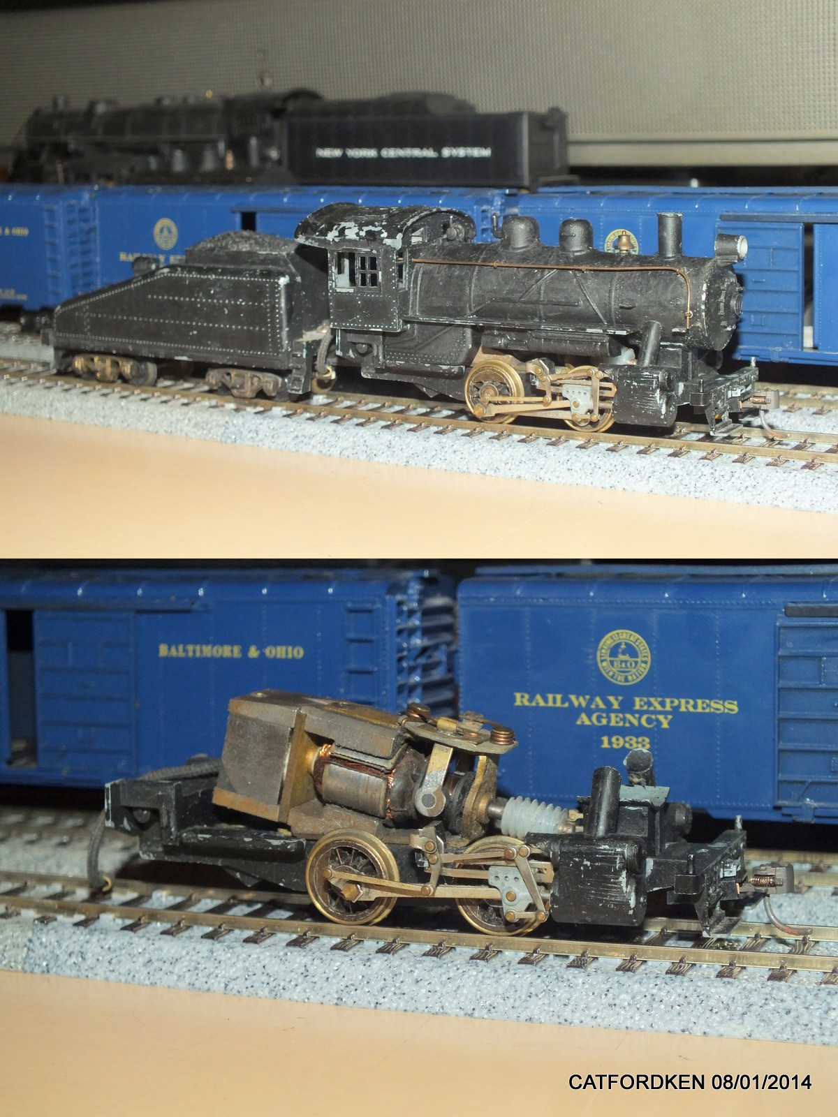

PICS AS PROMISED KEN
GOING TO STRIP THE BODY DOWN oops back to normal

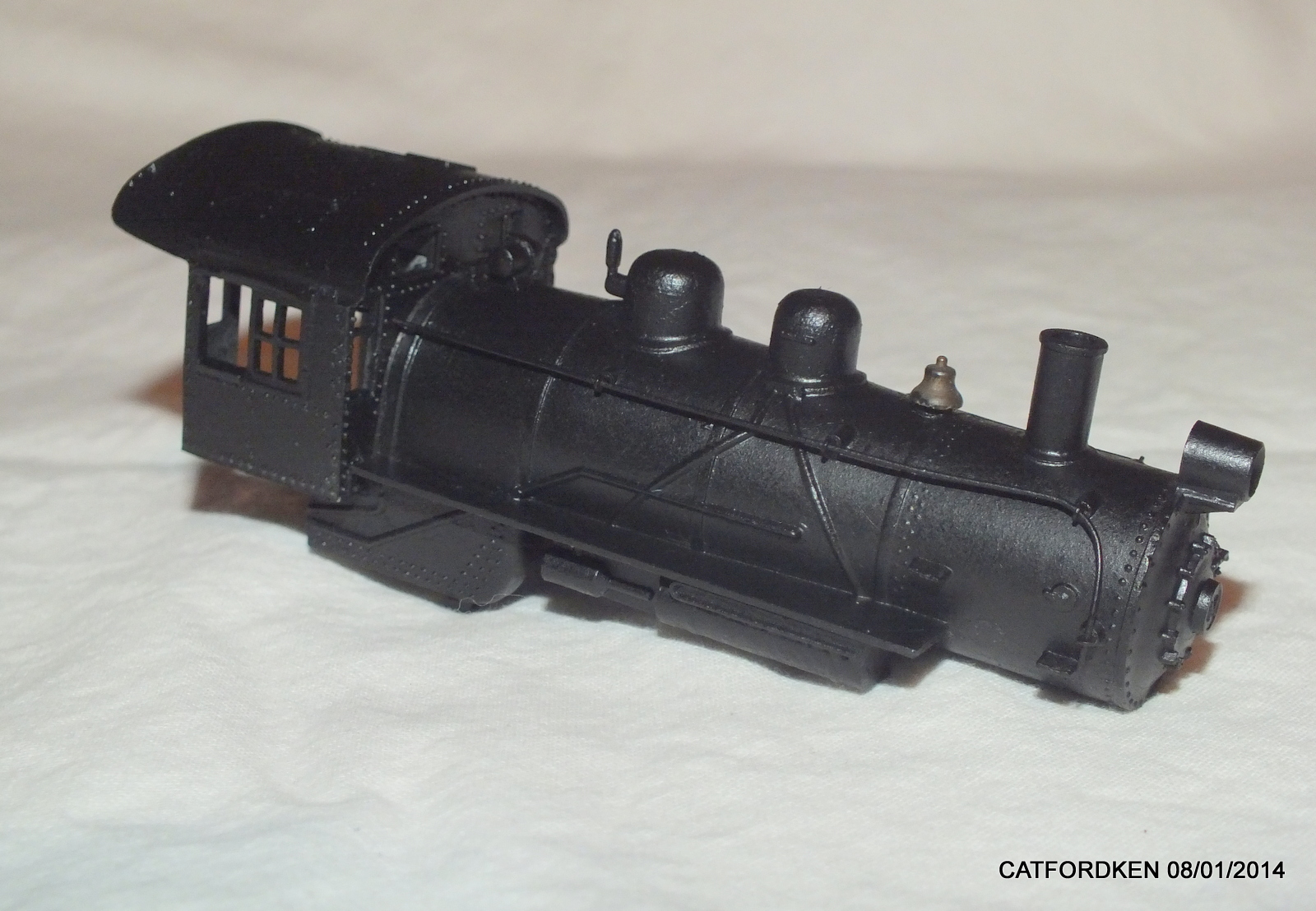

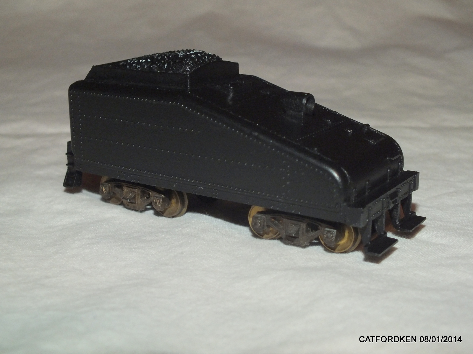

 Posted - January 09 2014 :  5:30:06 PM Link directly to this reply  Show Profile  Send catfordken a Yahoo! Message  Add catfordken to Buddylist
body/tender on its way to salvation ken

 Posted - January 09 2014 :  6:26:27 PM Link directly to this reply  Show Profile  Add richard p to Buddylist
Very nice job Ken. The engine does not look too new. Get a jewel for the lights and they will look 100% better.

 Posted - January 10 2014 :  01:12:53 AM Link directly to this reply  Show Profile  Add Barry to Buddylist
Lookin' good Ken. I'm glad you're posting these photos. Yeah Rich, those jewels do a heck of a lot. Sometimes, the one in my switcher makes me think it actually has a headlight.
 Posted - January 10 2014 :  10:40:14 AM Link directly to this reply  Show Profile  Send catfordken a Yahoo! Message  Add catfordken to Buddylist
hi Richard p&Barry thanks,the idea behind this painting was to improve what i already had,ie,not new or old,something in between and a bit oily, ken
i am sure i have a big six kit in box so did not what to do as i usually do

 Posted - January 10 2014 :  11:32:03 AM Link directly to this reply  Show Profile  Add Ray Marinaccio to Buddylist
Looks nice Ken. The way it should have in 1952.

 Posted - January 10 2014 :  2:44:35 PM Link directly to this reply  Show Profile  Add scsshaggy to Buddylist
Ken, I see you also repainted the scratched up cylinder jacket. Did you also trim brush along the right of way so it would not just get scratched up again?

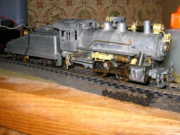

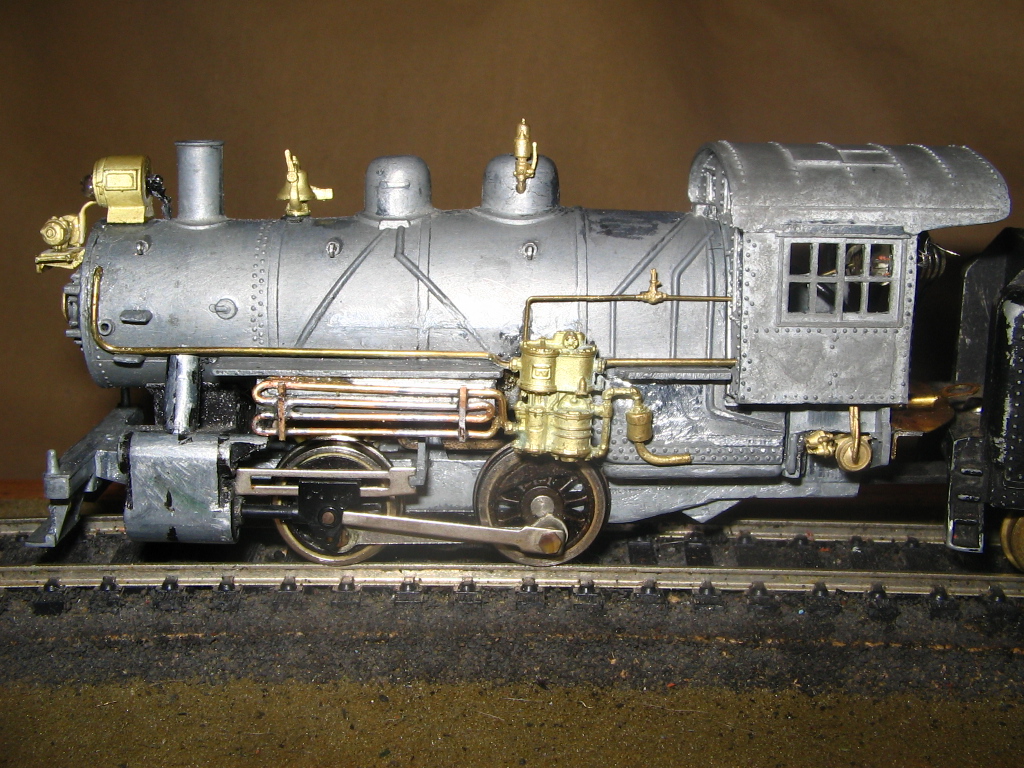

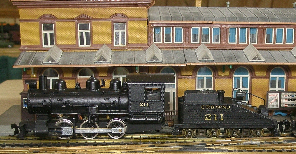

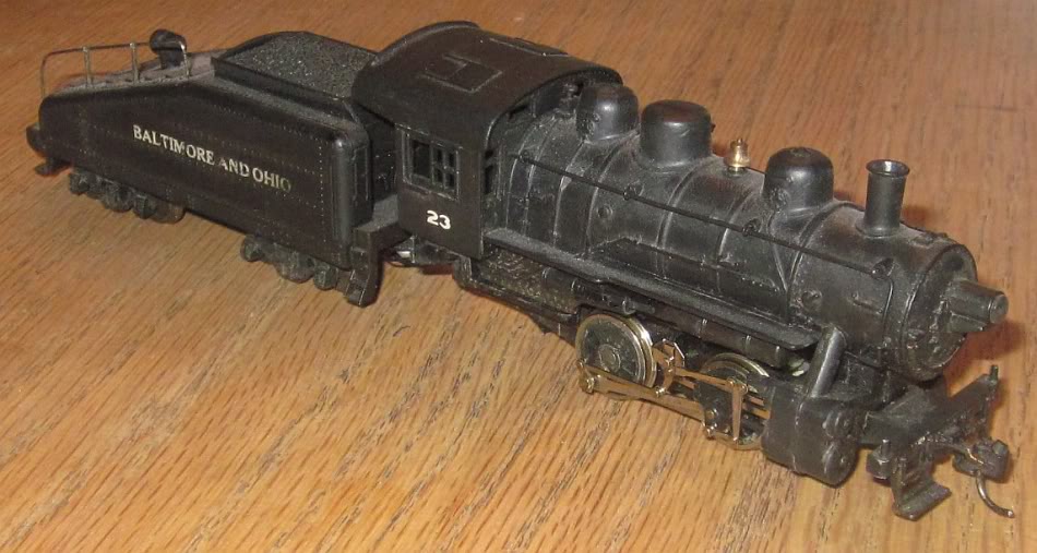

 Posted - January 10 2014 :  4:58:40 PM Link directly to this reply  Show Profile  Add Mustangs_n_Trains to Buddylist
Here is one repaired & detailed and then regrettably sold for ~$40 a while back:
I decides after that one, that was the last one I restore and detail just to sell. At least Auction Style.
I must have added $20 worth of brass castings & it included directional lighting from which I built the control panel using radio shack parts and stored it in the tender! Just filing and sanding the boiler took a few hours! I think I had ~6-8 hours into it if memory serves me correctly. That was like 4-5 years ago now, so maybe not...

Ken, are those brass trucks on the tender? Sean, that is some bunch of detail on that switcher; I'm wondering (since I remain pretty ignorant of the names of all the devices and mechanisms on steam locos yet, including cab-tender hook ups) . . . did most steam locomotives have a platform that facilitated movement between the cab and the tender?
 Posted - January 11 2014 :  12:18:19 PM Link directly to this reply  Show Profile  Send catfordken a Yahoo! Message  Add catfordken to Buddylist

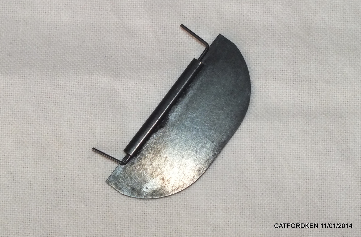

hi barry,brass on postive side plastic on negative side,the platform/cab deck plates are standard on most locomotives with tender ken
http://www.bowser-trains.com/images/Misc/Cal%20Scale/Cal-Scale-Steam-Loco-Parts2.jpg

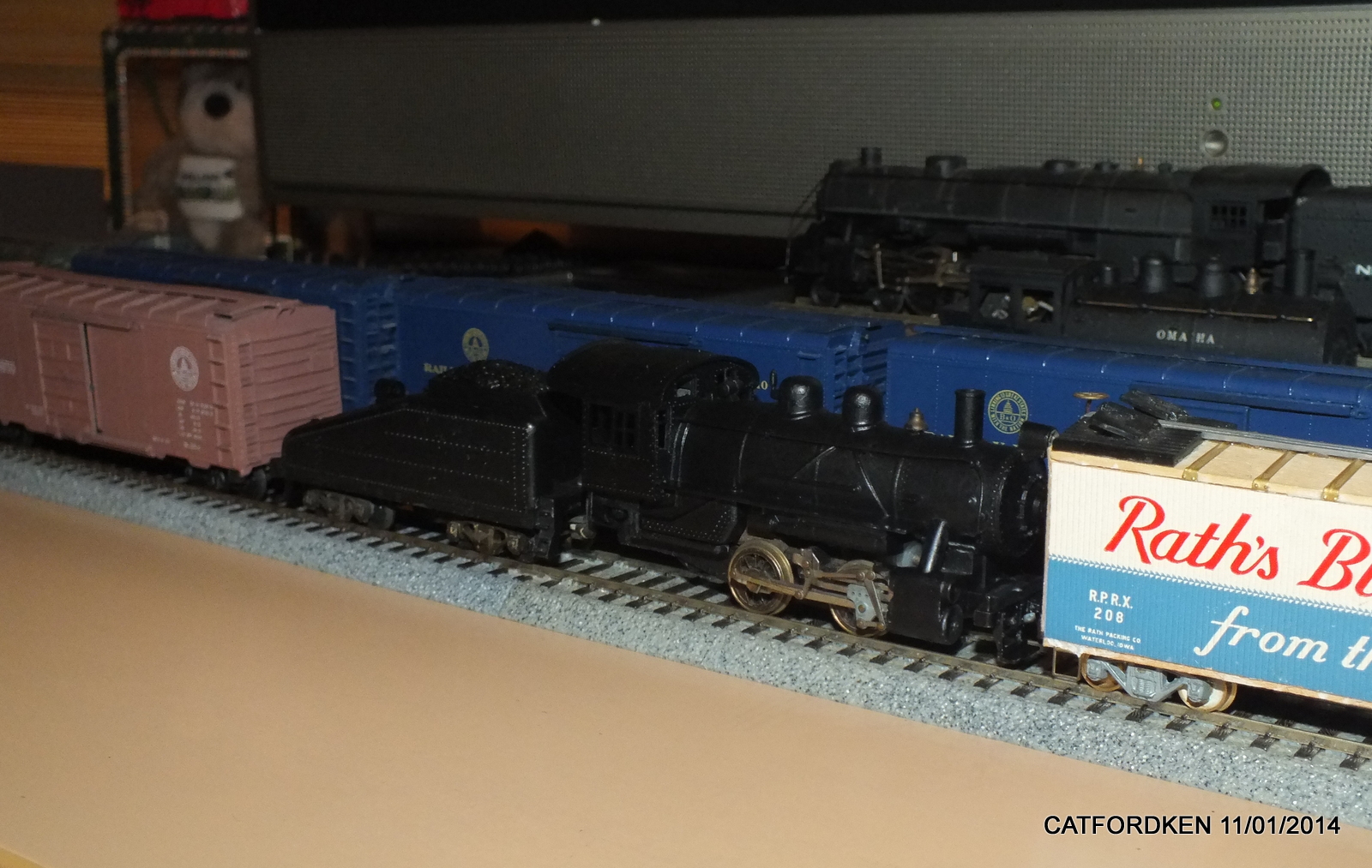

 Posted - January 11 2014 :  5:42:49 PM Link directly to this reply  Show Profile  Send catfordken a Yahoo! Message  Add catfordken to Buddylist
doing what shifters do best ken

 Posted - January 12 2014 :  03:00:18 AM Link directly to this reply  Show Profile  Add SCVR66 to Buddylist
You've had your shifter a good week and you use it more then I use my 5 shifters
1's really rare, 1s under restoration, but the other 3 are used when needed

Thanks for the link to the Bowser deck plate, Ken. I noticed that particular model is "hinged"; is that the way they were on many locomotives? Thanks, Barry
 Posted - January 13 2014 :  10:26:35 AM Link directly to this reply  Show Profile  Send catfordken a Yahoo! Message  Add catfordken to Buddylist
hi Barry,yes all tender locos had deck plates that were hinged to my knowledge ken

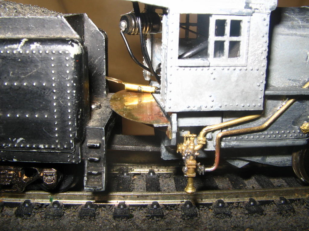

 Posted - January 13 2014 :  11:33:43 AM Link directly to this reply  Show Profile  Add Mustangs_n_Trains to Buddylist
hi barry,yes all tender locos had deck plates that were hinged to my knowledge ken
Originally posted by catfordken - January 13 2014 :  10:26:35 AM
The problem with using a hinged plate on most standard diecast models... The tender is usually charged from a different rail than the engine and having a hinged brass cab plate contacting both is sure to result in a short. The best thing to do is to not allow the hinge to operate freely and keep the deck stationary and above the tender deck somehow.
A support bracket is used pretty commonly for this.

hi sean,barry,i bought one as a template,then made duplicates of thin plastic sheeting,ken

 Posted - January 14 2014 :  1:28:07 PM Link directly to this reply  Show Profile  Add Barry to Buddylist
Thanks Ken, Sean, I will get a copy of that book. And it seems like a deck plate could be scratched out without too much trouble? It just never occurred to me; my thinking was that the tender needed to be much closer to the locomotive than most models depicted. Seems like a great detail item to add.
 Posted - January 14 2014 :  2:38:39 PM Link directly to this reply  Show Profile  Add scsshaggy to Buddylist
Regarding deck plates, one needs to watch out for a couple of things:
If your railroad has abrupt changes in grade, it's best to make the plate to hinge or flex. The one shown in this thread looks pretty rigid, so on a torture track, the rear of the engine might sometimes be lifted by the tender.
Also, a look at the tender trucks shows that something unusual is going on electrically in the example shown. Typically, the engine is grounded to the right rail and the tender to the left rail, so a brass deck plate would be a short circuit between a metal locomotive and a metal tender. In that case, a layer of plastic insulating the plate from either the engine or tender would help.
 Posted - January 15 2014 :  8:03:28 PM Link directly to this reply  Show Profile  Add Barry to Buddylist
Thanks Don. Regarding "something going on" with the tender trucks on the "example shown", are you talking about how it looks like the paints off on the corner like from overheating with a short? Or something like that? I was kind of thinking of just making one out of styrene or cardboard?
 Posted - January 15 2014 :  10:28:35 PM Link directly to this reply  Show Profile  Add scsshaggy to Buddylist
Originally posted by Barry - January 15 2014 :  8:03:28 PM
One truck picks up from the right rail and the other from the left. As originally designed, they pick up on the same side. It's possible that it has been modified so the tender is grounded to the same rail as the engine with the reversed truck insulated and supplying its power through a wire.
It's also possible that the truck is spun around accidentally and the tender is quite conventional and that the metal plate has some insulating material underneath it to prevent a short.
Personally, I like your approach of using styrene or cardboard and eliminating the electrical issue, entirely. I once added such a plate to a Mantua Hudson and made it out of photographic film. The material is springy enough that it flexes when the engine rises and falls relative to the tender.
