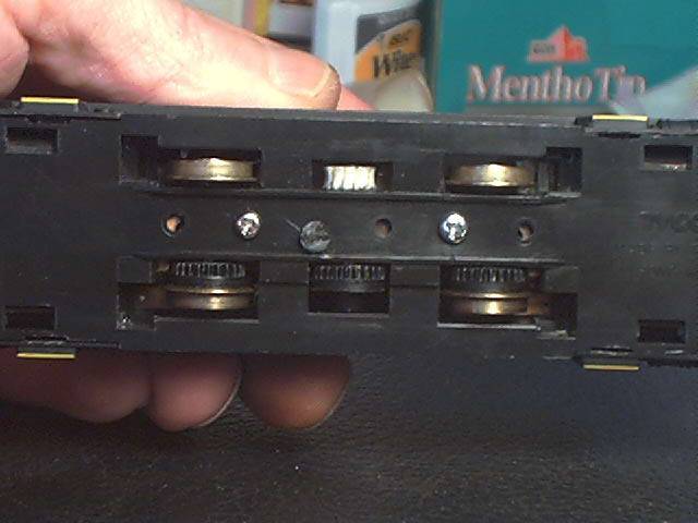

Tyco made PT drives for the trolleys and 4 wheel switchers That have the wheel sets you would need. As Nelson said, you would need to make wipers.
I have tried pick up shoes that ride on the rails, work if you can keep them adjusted properly.
Ray
Edited by - Ray Marinaccio on December 24 2013 1:10:44 PM
 Posted - December 24 2013 :  3:08:52 PM Link directly to this reply  Show Profile  Add NickelPlate759 to Buddylist

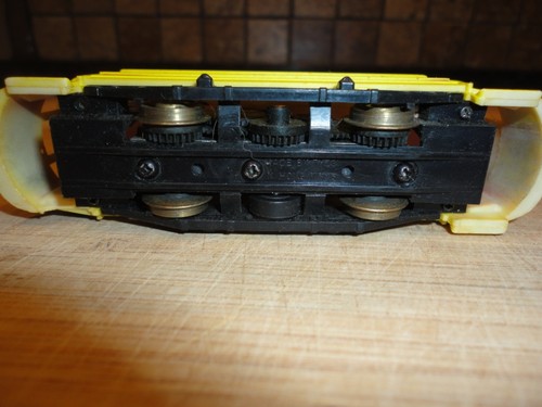

I forgot they had those wheels on the PT MDT's, and I own one. You would need 3 MDT's to get the 6 insulated wheels. You can see the wipers in Ray's shot which are mounted at either end of the frame and ride on the wheel treads.

Ray, is that a chewed up MU-2 axle gear holding in the center axle?
Originally posted by NickelPlate759 - December 24 2013 :  3:08:52 PM
It sure is. They are great for replacing the original cracked axle retainer.
