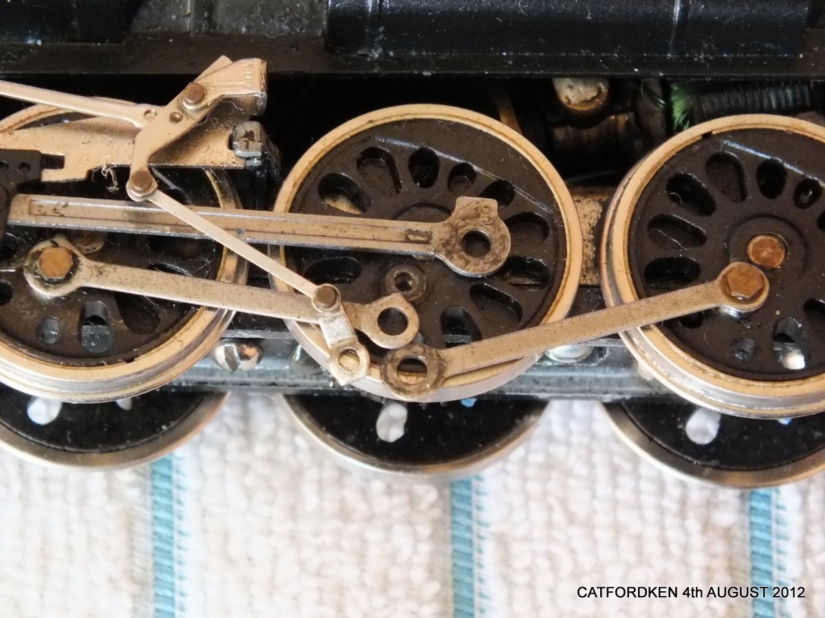

hi guys anyone got a spare part,number 6390 shouldered bushing,for using with the photo ken

 Posted - August 05 2012 :  1:48:57 PM Link directly to this reply  Show Profile  Add SCVR66 to Buddylist
You mean a crankpin and rivet?

 Posted - August 05 2012 :  2:08:54 PM Link directly to this reply  Show Profile  Send catfordken a Yahoo! Message  Add catfordken to Buddylist
no i mean what i said a shouldered bushing 6390 cheers ken

 Posted - August 05 2012 :  3:23:28 PM Link directly to this reply  Show Profile  Add SCVR66 to Buddylist
I see what you mean, a crankpin isnt much different from that

 Posted - August 05 2012 :  7:39:32 PM Link directly to this reply  Show Profile  Add Redneck Justin to Buddylist
PM sent Ken. I may have it.

 Posted - August 06 2012 :  02:30:21 AM Link directly to this reply  Show Profile  Add Erich to Buddylist
Hi Ken ! you can make this by yourself using two brass tubes! - Erich

 Posted - August 06 2012 :  6:10:19 PM Link directly to this reply  Show Profile  Send catfordken a Yahoo! Message  Add catfordken to Buddylist
thanks guys for all your help,found one ken

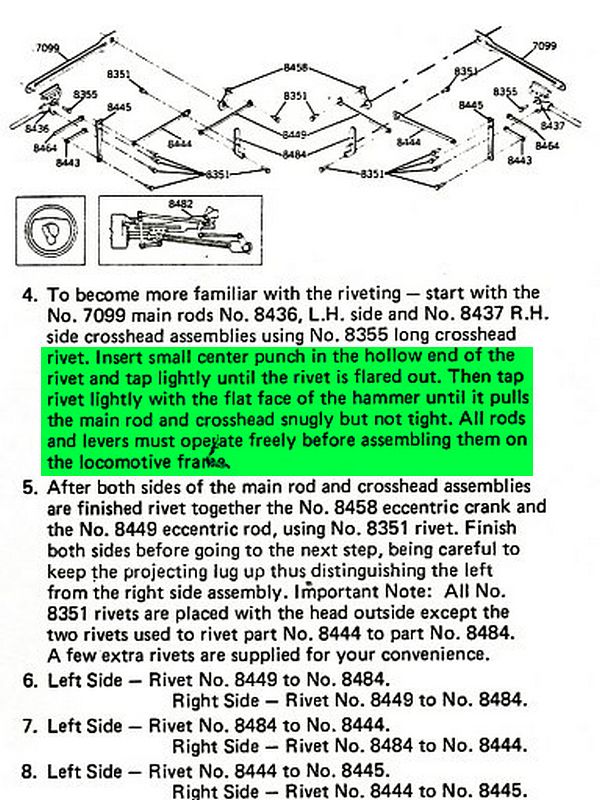

My pin keeps falling out. What is this part called and how to keep it from coming out? thank you..
 Country: USA  ~  Posts: 39  ~  Member Since: January 15 2011  ~  Last Visit: January 21 2014 Alert Moderator  Go To Top Of Page
 Posted - December 08 2013 :  3:53:20 PM Link directly to this reply  Show Profile  Add NickelPlate759 to Buddylist
That's a rivet. If it just pulled out of the links because it wasn't flared enough you can flare it on the back of the linkage with a punch or an awl, or any tool with a point (you'll have to take the valve gear off to work with it). If the flared portion broke off, then it's probably not long enough anymore and you need a new one.
Edit: Here are their riveting instructions.

RollTycoRoll
 Posted - January 15 2014 :  4:57:07 PM Link directly to this reply  Show Profile  Add RollTycoRoll to Buddylist
Thanks for sharing this Nickelplate! If anybody has any rivets let me know, ill buy them. Thanks
