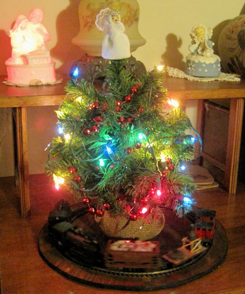

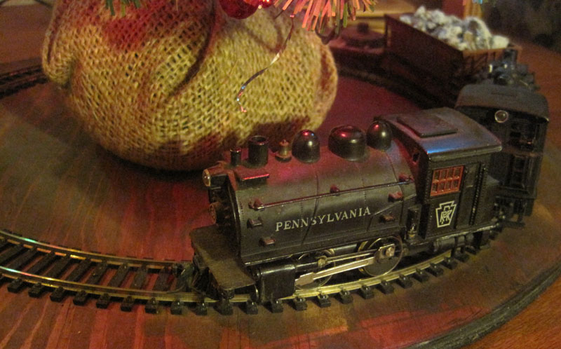

At some point, I figured out that an 0-4-0T could go around a really sharp curve, so I looped a 3 foot section of flex track around on itself and made a small loop around a small Christmas tree:
For a movie of the train going around:
https://vimeo.com/82349267
The "ore" in the ore jenny is a non-gem form of topaz known as sand crystals. I found those last month while digging topaz with a friend of mine who is a rock hound. They catch the light interestingly as the train passes under the Christmas lights.
I would like to see what other members have done with the link between Christmas and trains.

HOW on earth did you get that flex track to work??? I made a 10" circle last year with flex track, and it was very difficult. The joints wanted to spring out, so I soldered them together but it still wasn't a smooth joint. I wound up replacing that circle this year with Eldon track, which has factory curves in a very tight radius.

I'm more wondering how he got a Rivarossi docksider to run back to back well with an IHC Docksider

well Varney did advertize that the Dockside can go around tight circles
& you just proved it really does

Internally, they're both Rivarossi but one has had a shell transplant.
Originally posted by 59Chevy - December 19 2013 : 11:32:04 PM
When I nailed it down, I was able to push the joint to where it wouldn't kink.

The drivers were a dead giveaway that they were both Rivarossi (I think the transplanted shell is a Life-Like). Are they stock running at low voltage, or have they been regeared? They're running at a reasonable consistent speed.
I like the vertical boiler on the flat, and the 8-wheeled bobber.

They're stock running at low voltage. The fact that there are two raises the amperage to where it's easier for a throttle to precisely control. One engine alone would be more likely to go from 0 to 80 in 5 milliseconds.
The 8 wheel bobber is a chassis from tyco's usual streamlined caboose with a section cut out of the middle. To that is added a bobber shell scrounged off of a boom tender car. Both those parts were in a bagged assortment that the LHS imaginatively called a "Bag of Stuff."

whats funny about that 8 wheeled bobber is some rail lines really did convert old 4 wheel bobbers to 8 wheels
