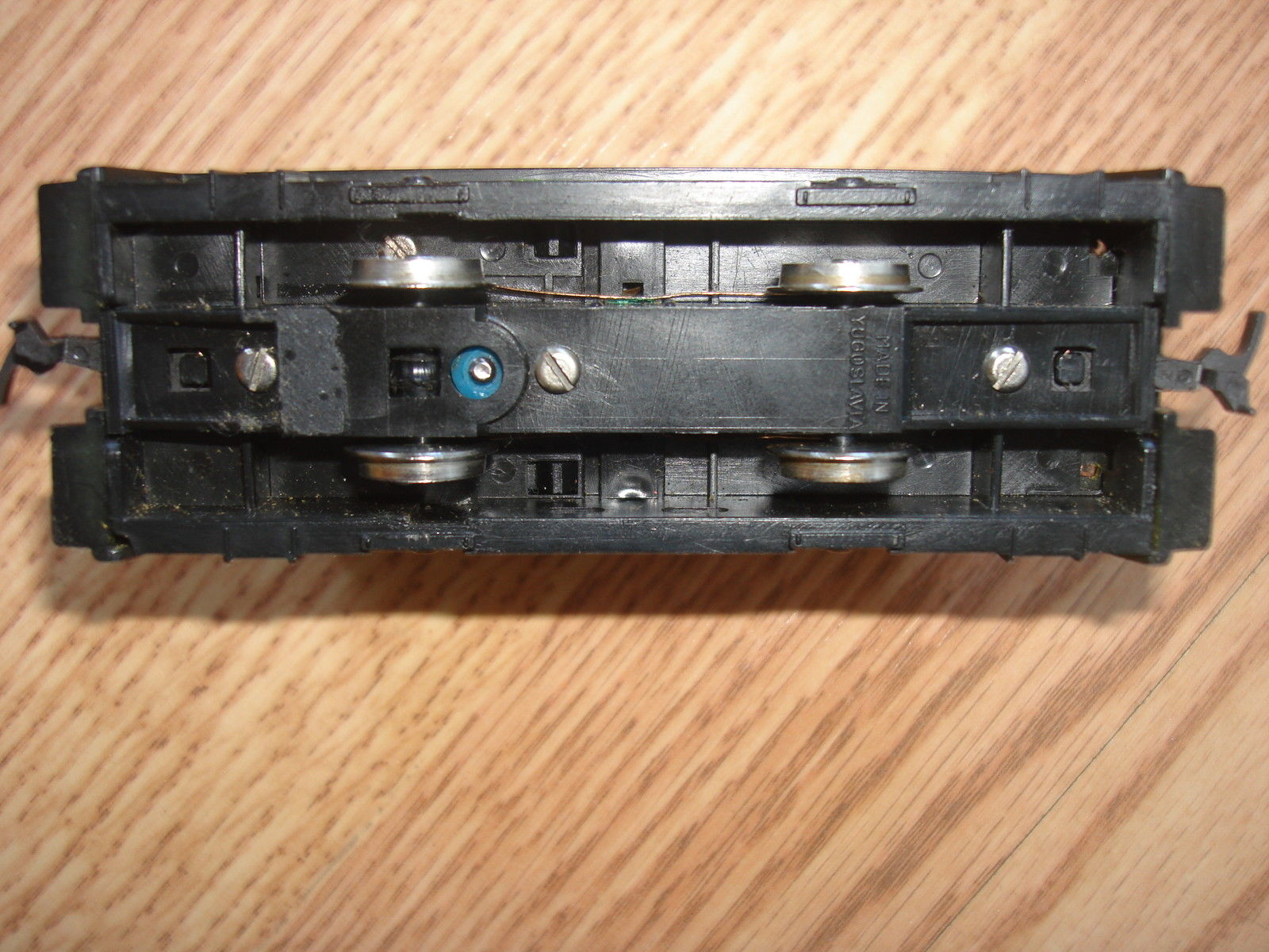

AHM made in Yugoslavia switcher. I only see one pickup. How does this work?

 Posted - December 19 2013 :  01:26:52 AM Link directly to this reply  Show Profile  Click to see EM-1's MSN Messenger address  Send EM-1 a Yahoo! Message  Add EM-1 to Buddylist
Mike,
Simple... it doesn't work, its actually missing one on the opposite side from the one seen......Have other loco's of the same to rob for parts? as that's pretty simply to remedy to get it running again!

Thanks a lot, EM-1, that's what I thought, but could not see in the pic. I can fix that.

 Posted - December 19 2013 :  01:49:00 AM Link directly to this reply  Show Profile  Add NickelPlate759 to Buddylist
I can just see the wiper behind the lower wheels. The upper wiper looks like it's riding the tread of the rear wheel.

Thanks, I think maybe I see a glimmer of lower wiper metal when the pic does a close-up. If I can get it cheap, I'll grab it. $7 on E-bay. Seller says motor is not connected to wheels, probably just a broken driveshaft. I expect I can fix that. It's a cute little switcher.

 Posted - December 19 2013 :  2:40:33 PM Link directly to this reply  Show Profile  Add NickelPlate759 to Buddylist
There's no drive shaft on these; the motor drives the axle directly through a worm. I see what the problem is now... the axle gear is stripped completely bare. A geared axle from any AHM Yugoslavian diesel with a vertical motor will fit.
