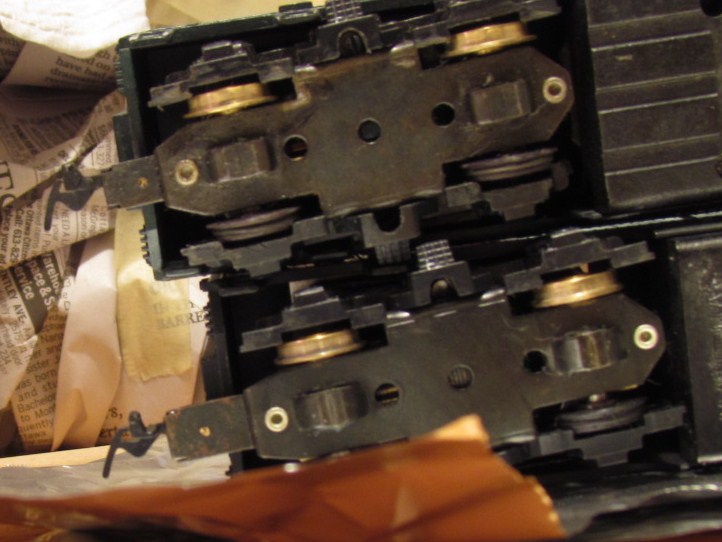

As far as I know, Tyco used three main styles of couplers. The only metal couplers were the loop and hook style which were phased out before the Red Box era started. In the earlier stages of the Red Box era Tyco used plastic horn hook couplers that were put under tension in the coupler pocket by a piece of wire. Later on they switched to a plastic horn hook which used the spring-tail. Other than the addition of the tail, these couplers were identical to the earlier ones and remained the same throughout the Brown Box era.
Here's an example of the two different Red Box era pockets. The top example is the earlier, small pocket.

Well, I looked through my collection of horn-hooks. All are plastic and have the integral spring, and most all have the larger, modern-type hole. Some have a small hole that I believe would work as is without those Kadee circular spacers. And the thing is, these couplers with the smaller hole - like the ones used in your Tycos - are also SHORTER. God only knows what I pulled them from
Looking at them and comparing them to the coupler box I have, and then using the photo Cheez posted of the smaller older boxes - I see no reason why they would not work.

That smaller coupler box that DaCheez pictured is it. Someone told me those where metal.

DaCheez,
Do I have permission to save that photo :) It tells all!

 Posted - December 20 2013 :  1:45:09 PM Link directly to this reply  Show Profile  Click to see DaCheez's MSN Messenger address  Add DaCheez to Buddylist
Be my guest!
