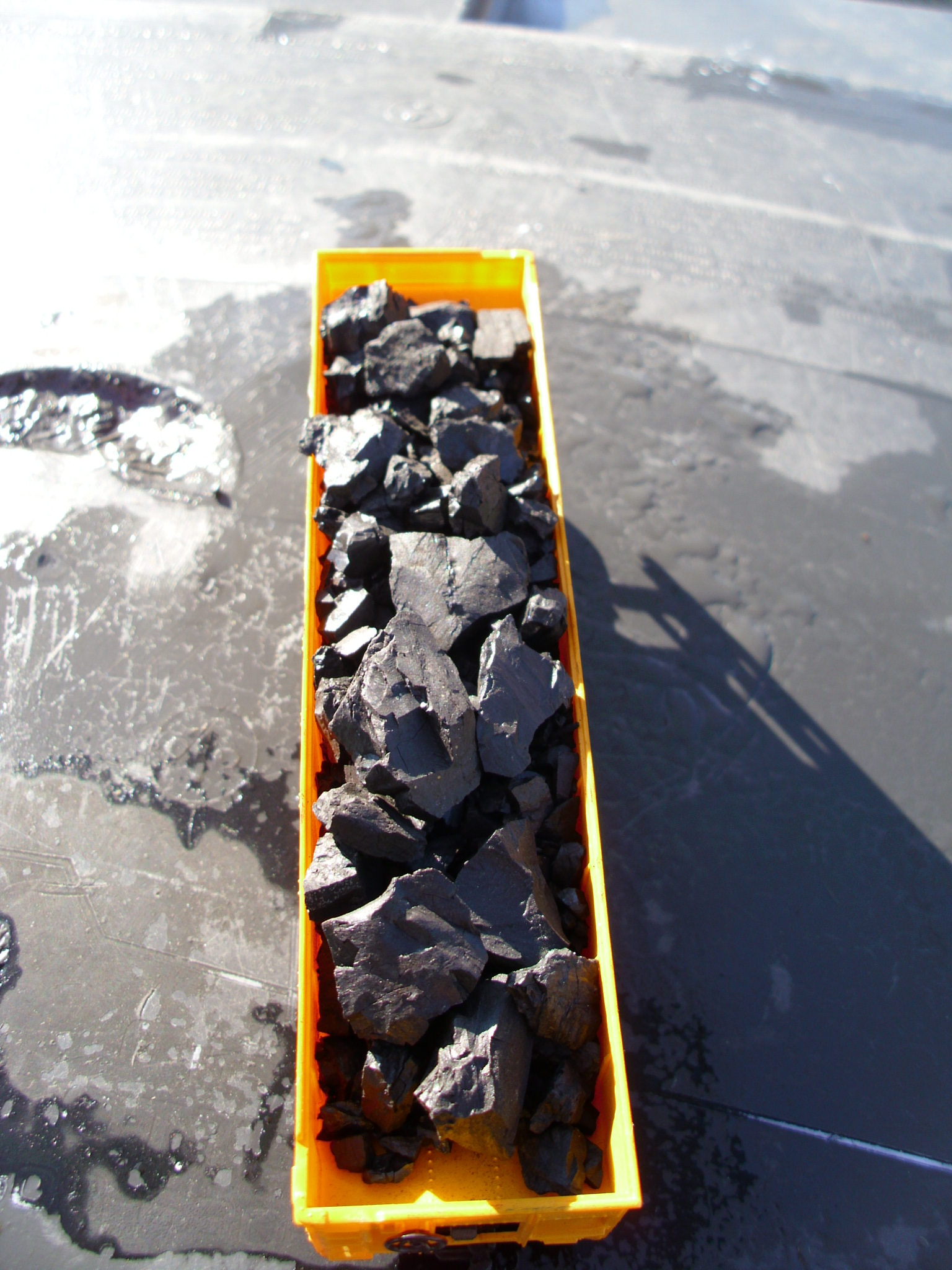

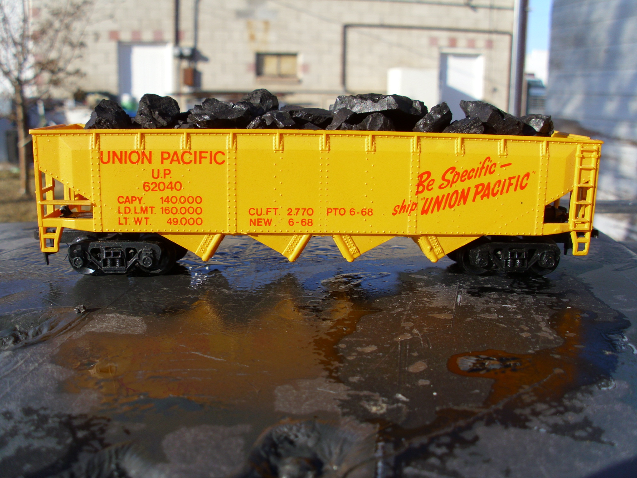

 Posted - December 13 2013 :  6:16:13 PM Link directly to this reply  Show Profile  Add microbusss to Buddylist
or you could use REAL coal
ok ok I KNOWS the pieces in the car are too large but this was set up as a example

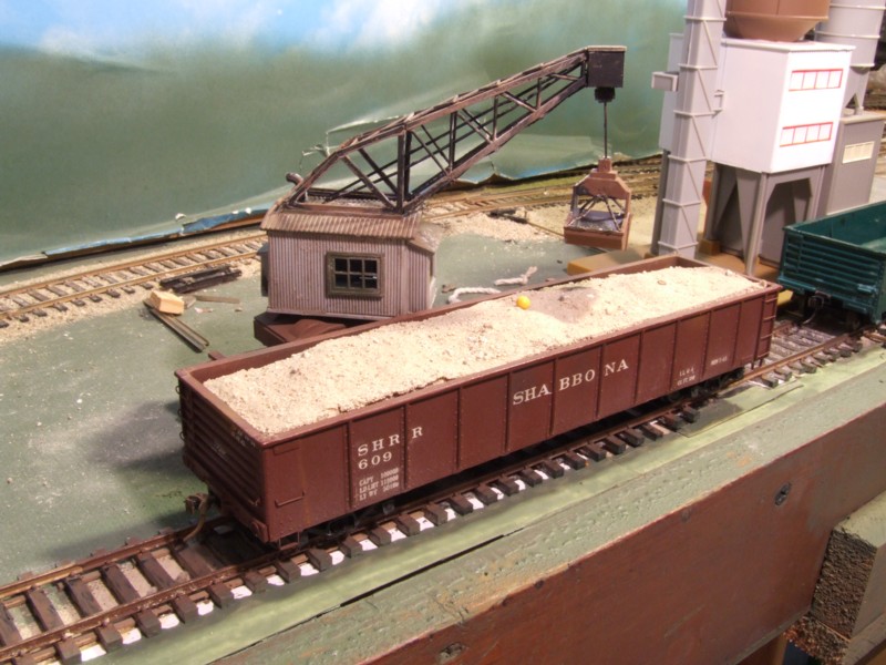

I used sifted gravel from the side of the road
This is a gondols load of gravel about to be unloaded at the concrete block factory. These loads are removed at this point and taken back by hand to their starting point, where they are put into another gon and shipped to the block factory
Originally posted by microbusss - December 13 2013 :  6:16:13 PM
Ben, I do use real coal (broken a lot smaller) and it looks pretty good. For hopper cars, I just fill them with loose coal and have not had to clean up too many messes. I have access to a coal pile and just sift the fines on the bottom through a screen mesh kitchen strainer, keeping what falls through. Then, I sift it again through plastic mosquito screen (finer mesh), keeping what doesn't fall through. This gives me a credible size for HO scale and not to much airborne coal dust.

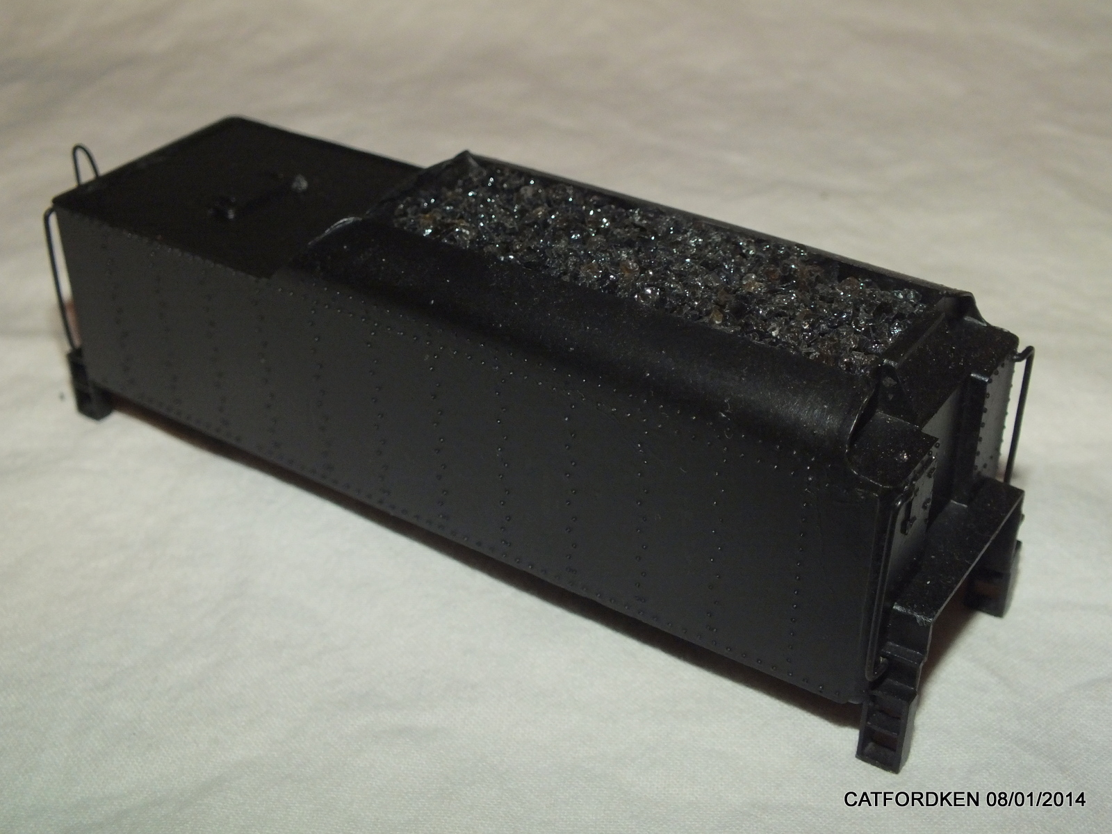

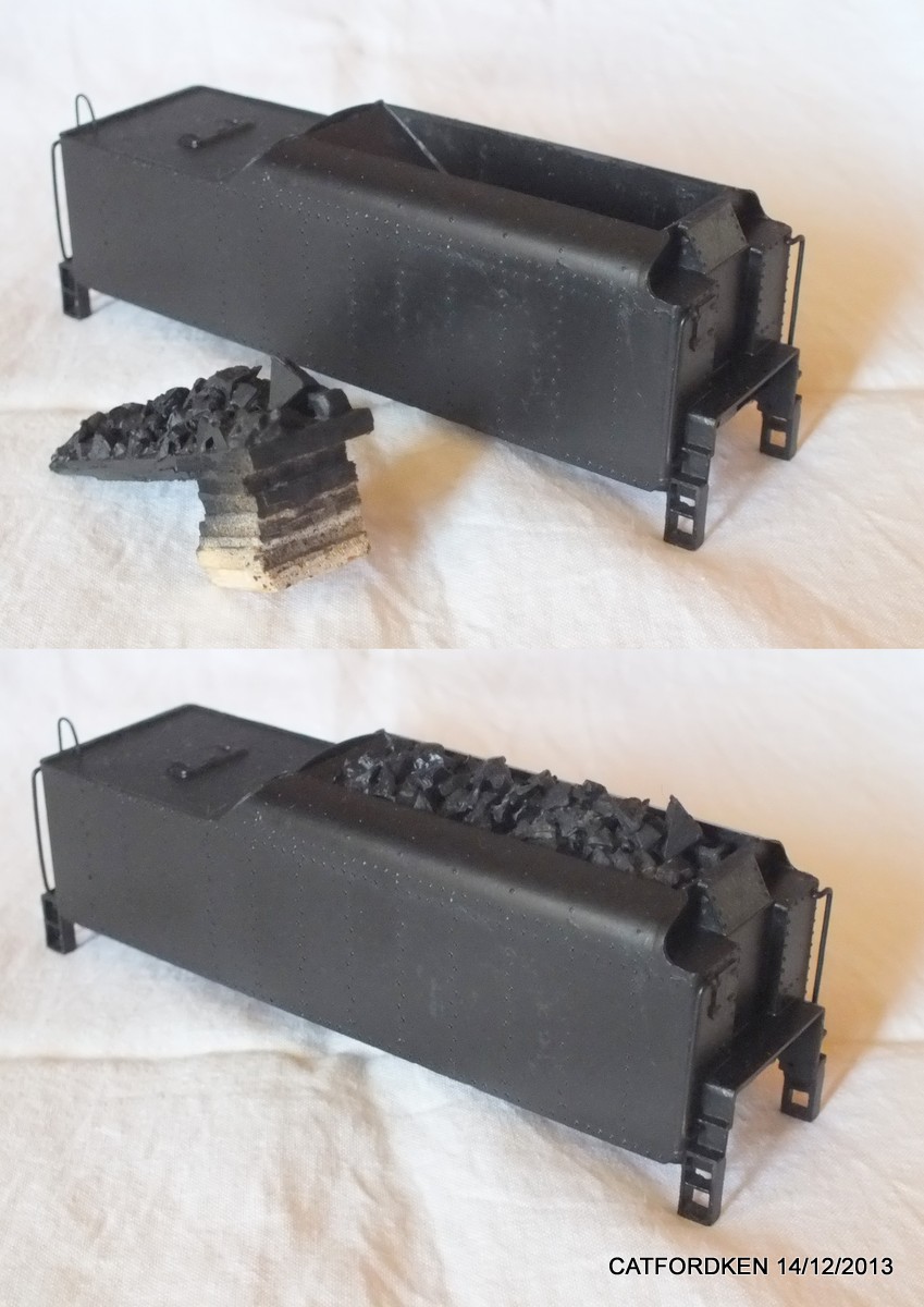

 Posted - December 14 2013 :  08:00:47 AM Link directly to this reply  Show Profile  Send catfordken a Yahoo! Message  Add catfordken to Buddylist
i use real coal,thats where good old fashioned hammers come in handy,ken
coal not crushed enough,but finished one will be
new coal load done
Edited by - catfordken on January 08 2014 7:15:01 PM

 Posted - December 14 2013 :  09:14:51 AM Link directly to this reply  Show Profile  Add String boB to Buddylist
Originally posted by catfordken - December 14 2013 :  08:00:47 AM
Boy, I'd hate to be the fireman that has to throw those clinkers in the firebox!

I noticed that the load of gravel I posted last night did not appear. Here it is again. The clamshell rane is an item I picked up on Ebay. I still want to string real "cable" fishline for the bucket, but it works for now. It was a little low for S scale, so I built a concrete "foam" base for it and mounted it on rails. It doesn't roll too well, but it doesn't have to.
This is the only load of gravel I have currently, but I want to do more so I can have some in the yard waiting to be unloaded. Then, when I don't feel like doing a full fledged operation, I can switch out sand cars. The remote manual switch linkage I use to throw the switch behind the batch tower may be visible in the photo as well. If not, I can post a photo of that if anybody's interested

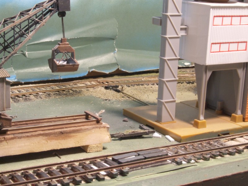

Nice looking crane set up "S"tring Bob. I also like the treatment on your rails; what did you do? Also, you're talkin' S scale. Is that like, the crane is S scale, but you're using it on an HO layout; or is the whole layout S scale? I like the corrugated sheathing on that crane. I wouldn't mind seeing more photos of that crane to be able to see how you set it up to roll on the track and such. Thanks. Barry

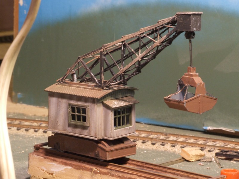

Bob that crane loader pictured here.......can you get a few better pictures of that clam-shell bucket? I'd love to be able to copy that for a few application I have for one!

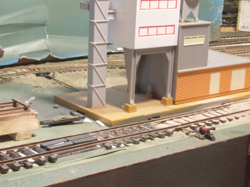

Barry, et. al.
I'll get some photos, but it may be tomorrow before I can get them posted. The crane is actually HO. I looked a long time for one more suitable for S scale before settling on this one.

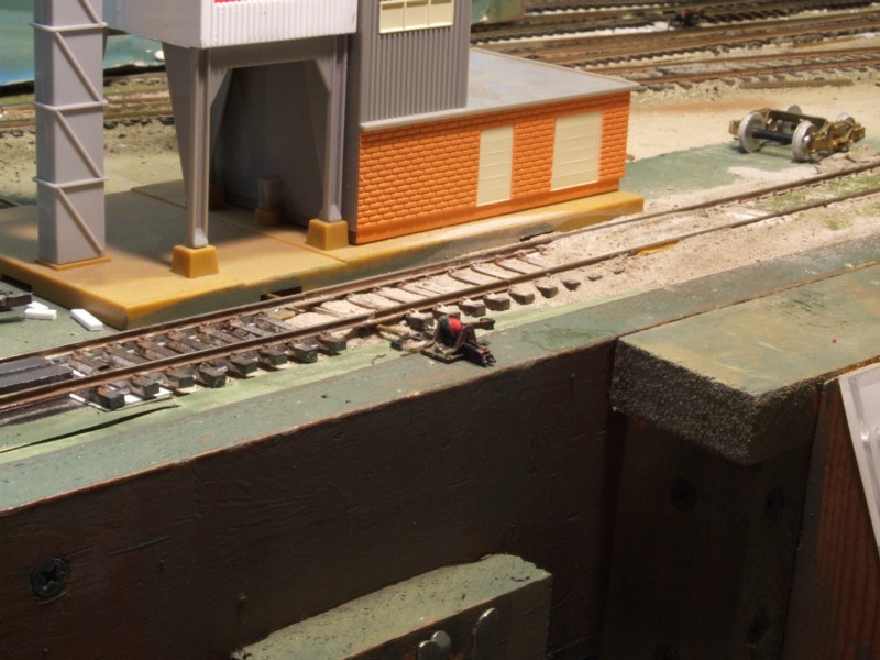

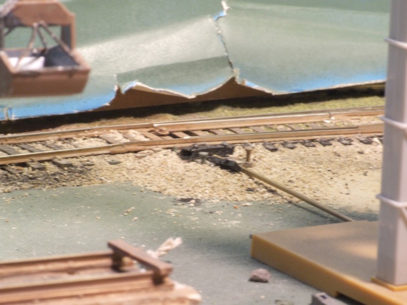

I'll take photos of my switch linkage that I use to throw the Scale Track Switch on the switch lead. It's location is such that I was risking tipping the crane over every time I threw it.
By the way, I'm using my Arc Soft photo editing program for the photos I post here, at least until I get a handle on Picasa, or something I can master.

 Posted - December 14 2013 :  11:29:21 PM Link directly to this reply  Show Profile  Click to see EM-1's MSN Messenger address  Send EM-1 a Yahoo! Message  Add EM-1 to Buddylist
Bob,
Yeah that's a Kibri crane isn't it? I know one of the over seas companies make it so..... Was in the Walthers book for a long time, and now, I'm not sure its even there.....
As for scale, fits right in to S scale, as that has got to be a REALLY BIG Clam shell for HO never mind a small one for S scale.....Looks great tho!

 Posted - December 15 2013 :  09:30:54 AM Link directly to this reply  Show Profile  Add String boB to Buddylist
Bob,
Originally posted by EM-1 - December 14 2013 :  11:29:21 PM
I photographed the crane at the block factory last night and I hope I can post them this morning
Well, I got two of them, I'll see if I can get the rest in another post

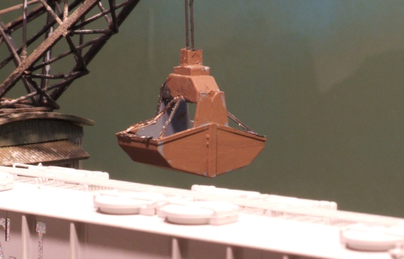

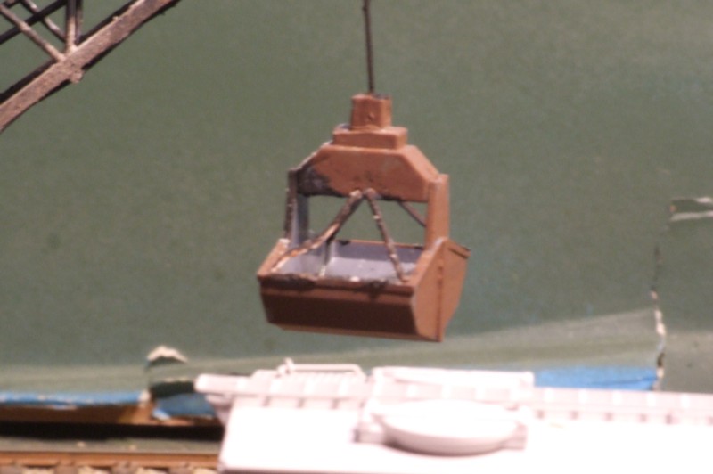

 Posted - December 15 2013 :  2:28:01 PM Link directly to this reply  Show Profile  Add String boB to Buddylist
[quote]Bob,
Well, I still can't upload the rest of the photos, at least right now. The crane is a Kibri, I guess, I don't know for sure. I would rather have had a boom crane like the photo that appeared here, but I couldn't find one like I wanted. I must have looked at this one for several weeks before biting on it. My next project is to find some thick black thread (or fishline) and add better rigging to it.
Still can't add more images. I'll come back later. As a matter of iinformation, I removed the quotes from the "S" in String Bob because that seemed to be affecting my ability to post photos. Now, I need to find out how I can post more than two or three at a time. Suggestions welcome - of course, it might help if I could type, too.
Originally posted by String boB - December 15 2013 :  2:28:01 PM
Hey, it's working! Image 1313a is the crane. Don't overlook the pigeon droppings on the overehang. I weathered the corrugated tin siding with acrylic paint from WalMart, using a dark brown and black to simulate wear and rust.
#1414a ahoows the switch linkage which runs beneath the batch tower to the Scale Track Switch
Thought it best to keep going while I was on a roll. The last three photos are of the Scale Track Switch rod control mechanism. I have used these in several places while constructing SHABBONA RR, with good success, using 1/16" brass tubing, .030 steel wire and Caboose Industries Low Stand switch throws
String Bob
 Country: USA  ~  Posts: 85  ~  Member Since: December 13 2013  ~  Last Visit: February 27 2014 Alert Moderator  Go To Top Of Page
 Posted - January 08 2014 :  7:47:27 PM Link directly to this reply  Show Profile  Add Barry to Buddylist
Cool scene and great photos stringbob and most certainly a cool looking crane.
