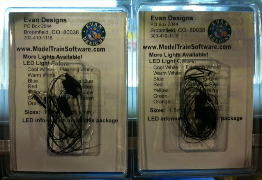

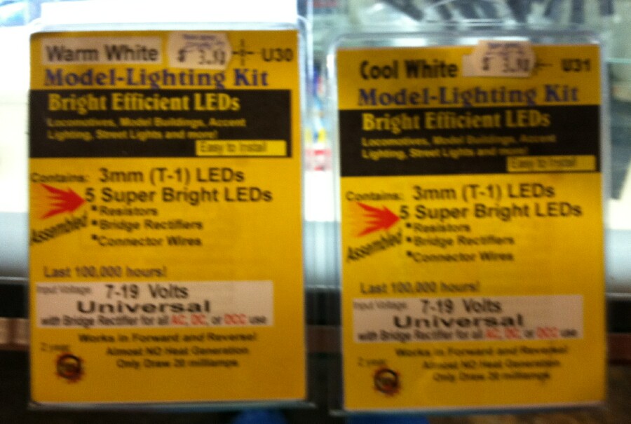

My hobby shop in Virginia started selling LED lights for locos, from bright whites to warm whites. What's neat about them is that they have integral resistor and diode pack, AND work in either forward or reverse mode. Can get them in 1, 1.5, 3, 5 mm sizes. About $4 each. I'm going to buy some for myself,and I'll post them on here when I do. I forget the name, but they come in blister packs of 5. Just wire them up and you're good to go.

 Posted - December 29 2013 :  09:27:42 AM Link directly to this reply  Show Profile  Send AMC_Gremlin_GT an AOL message  Send AMC_Gremlin_GT a Yahoo! Message  Add AMC_Gremlin_GT to Buddylist
Here's those LEDs I mentioned earlier in the post. These already come with resistors AND rectifiers built in, so you can use them for directional lighting. I don't think you can bypass the directional, so these are better for diesels I suppose. Anyway, the info is in the pictures, you can check out their website and find them. They're roughly $4 apiece, but like I said, they come with the resistor and rectifier already built into the harness. I installed a pair of normal whites into a Conrail diesel, and it looked great. I haven't seen all the color variations in person, so I can't tell you how "warm", blue white, etc. looks. But these are handy if you just want to wire in and go. And they come in size 1.8mm, 2, 3, 5, and maybe others.
