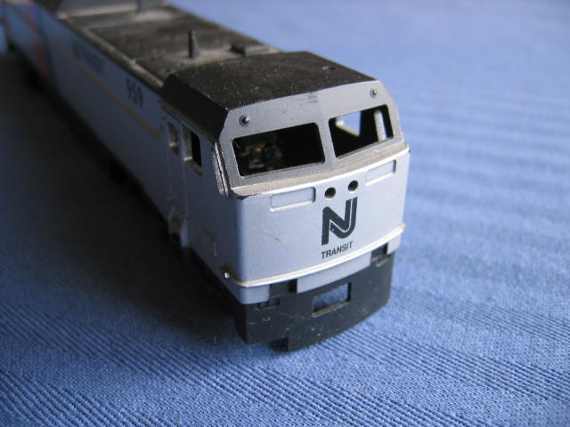

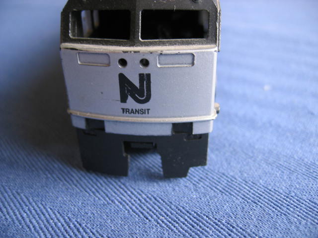

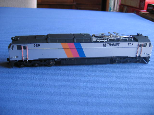

I bought this American GK NJ Transit E60CP Electric for $10 at a Pa. Merchant Square Mall Show.... Basically, it was a shell and a powered chassis. Both ends were damaged and it was missing a step on each side. This is a very rare engine. I have only seen two on Ebay and both sold for around $150. It took about two years to find an American GK Undecorated E60CP kit and two damaged Am GK E60CP shells on Ebay.

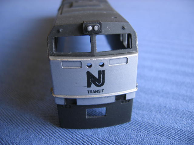

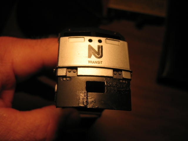

The front fender skirt at both ends was missing pieces out of it....

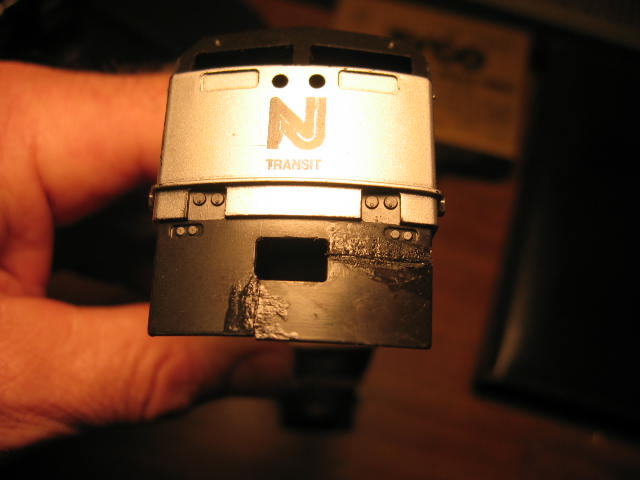

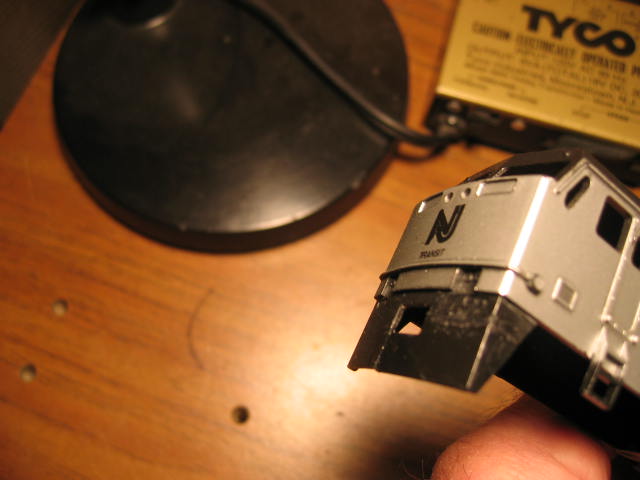

Using the damaged shells, I was able to cut pieces to fill in the damaged area's.
These were Crazy Glued in place and lightly sanded with an Emory board. There were two broken steps replaced with the steps from the donor shell.

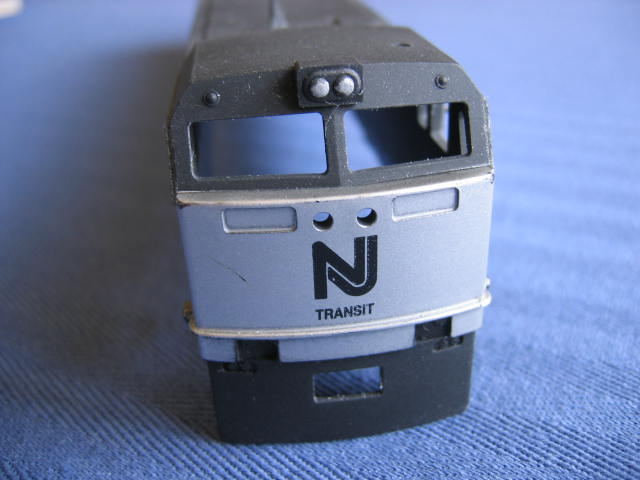

After smothing out both ends of the damaged skirt. The skirts and top of the shell was painted with a semi-gloss and then dull-coated so all of the black painted area's matched in color.

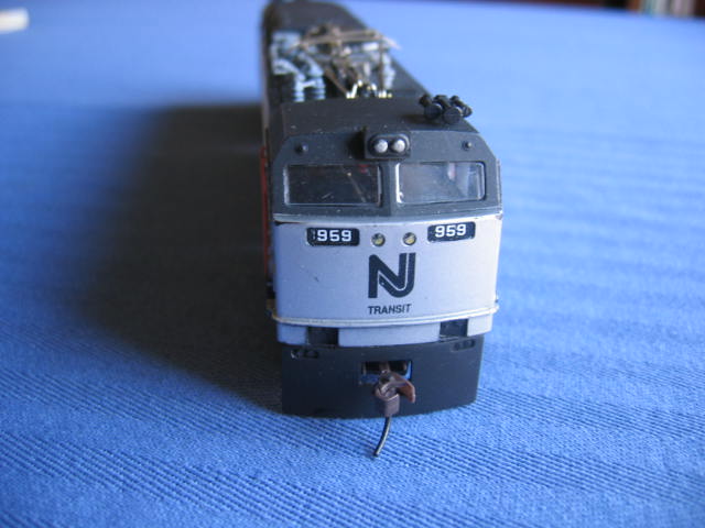

Once painted both ends looked like this....

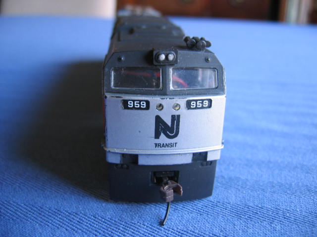

Then final detail pieces for the Pantographs and Electrical Insulators were added.

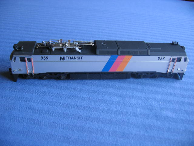

Also 2- 2mm LED light were installed in each nose. These are directional. All of the handrail were painted Mango Orange and dullcoated.

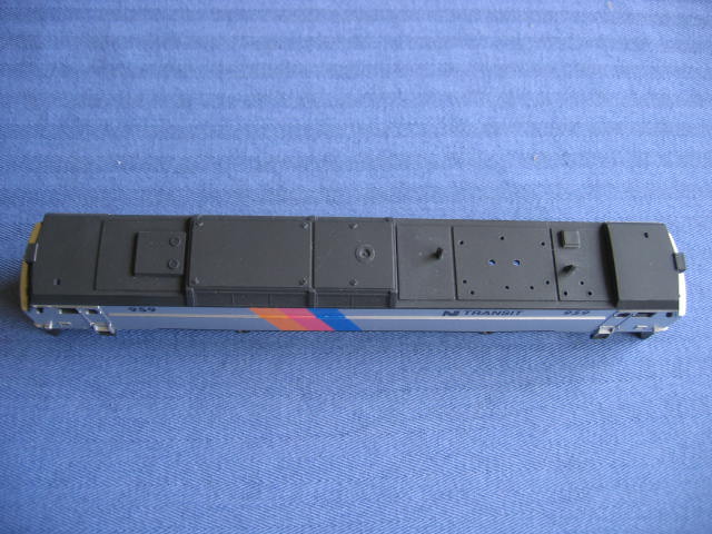

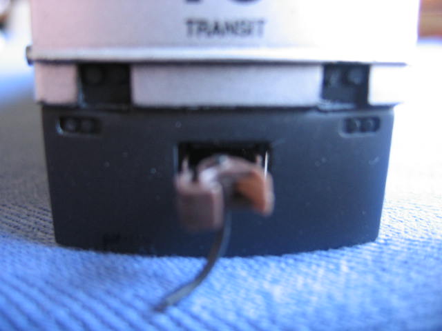

Then there was a disaster.... I was putting it back in the showcase and I bumped the glass door knocking off the smaller repaired piece. I tried fixing it again but it looked like crap. So... I completedly cut the damaged fender skirt off of the good shell and replaced it with one from one of the donor shells. Painted it and dullcoated it.
Only a small line is noticeable if one looks closely, between the shell and fender skirt.
This is a pic of the real #959 NJT E60CP...
