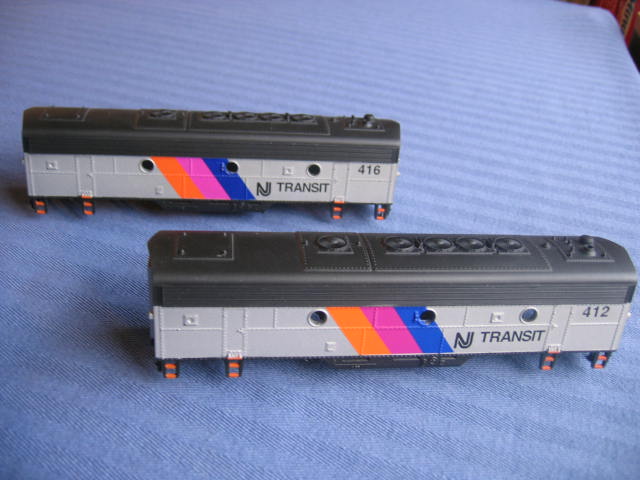

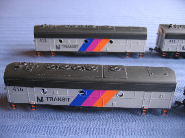

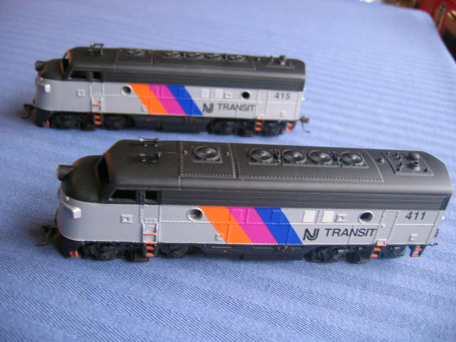

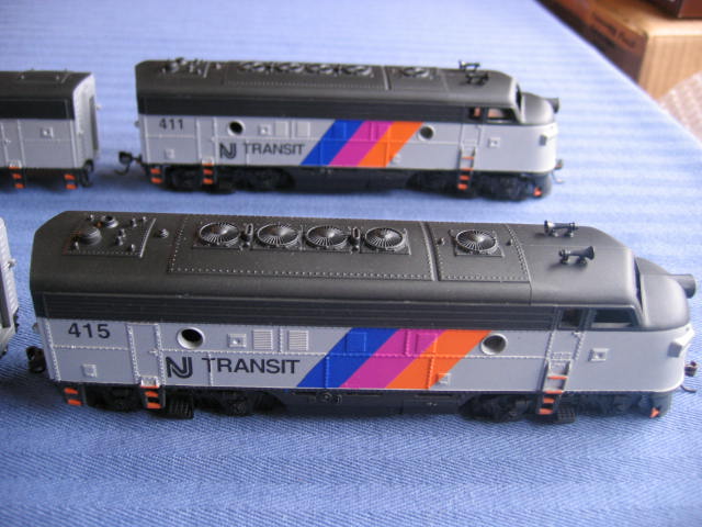

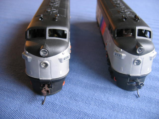

These took several tries before I got them right.... Never again....
I have to find a dummy chassis or powered chassis for the B Units....

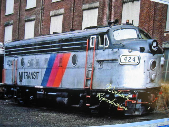

NJT never made a B Unit as far as I know.... They did have several F7 A Unit's on their roster.
Here is a pic of the real NJT F7 A Unit.....
My F7 A Units #411 & #415, F7 B Units #412 & #416

I use Testor's enamel paints. I also use Scotch Blue painter's tape fo rmasking the trin lines. Biggest problems: The tape pulls off some of the silver paint, therefore I have to re-shoot some sections. I used Microscale decals, including the stripes. Some shell I will have to use 2-3 sets of of the NJT Disco Stripes as they get air bubbles in them after putting on the decal set. Sometimes the ribbing and the rivets poke thru the decals. I have mastered taking a sliver of decal and covering the hole and blending it in. Everyonce in a while a silver fingerprint gets of the black top. Things happen like overspray, dirty paint npzzle contaminating a color, a finish spray is too dull, too glossy, some of the dullcoatings will get dirty from oils on your skin,.... The problem is I am a perfectionist.... If it doesn't meet my approval I do it over until it does. The Amtrak MoW #290 engine I did over 3x before it came out to my satisfaction.
TIP: One can remove the decals with clear cellophane tape before the covering the finished shell with a clear overcoat.
I did a perfect NJT IHC GG1 shell Black top/ the rest was Aluminum. Decals were perfect. I sprayed it with a semi-gloss finished. For some reason one of the NJT striped decals bubbled up and I had to strip the shell and I am it the process of doing it again. UGH!!!
