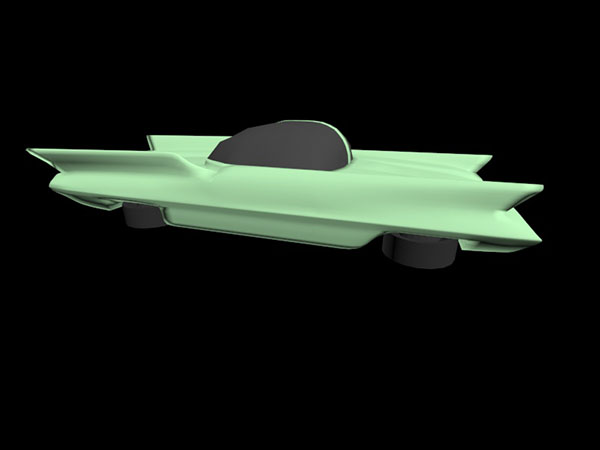

This may be a bit of an obscure question. Hopefully someone here has some ideas. What I'm trying to do is modify a few slotcar bodies to better fit the outer space theme on my layout. I'd like to chop the roofs off a couple of cars and replace them with a bubble canopy (think Jetsons).
Chopping the roof off should be easy...it's the bubble that is stumping me. If I could make the bubble clear that would be ideal. I've seen large scale models built by heating plexi-glass and then pressing it over a shaped mold before it cools. Maybe I could do the same with some thin plastic stock?
My fallback idea was to just make a small sphere out of styrofoam or papermache and then paint it to look like a windshield.
Opinions/suggestions?
This is sort of what I'm trying to do:

Ben, yes. That's a 3D model I made in college for a video game we were working on. It is based heavily off the Lincoln Futura, as you can tell. It was the best photographic example I had of what I'm trying to do.

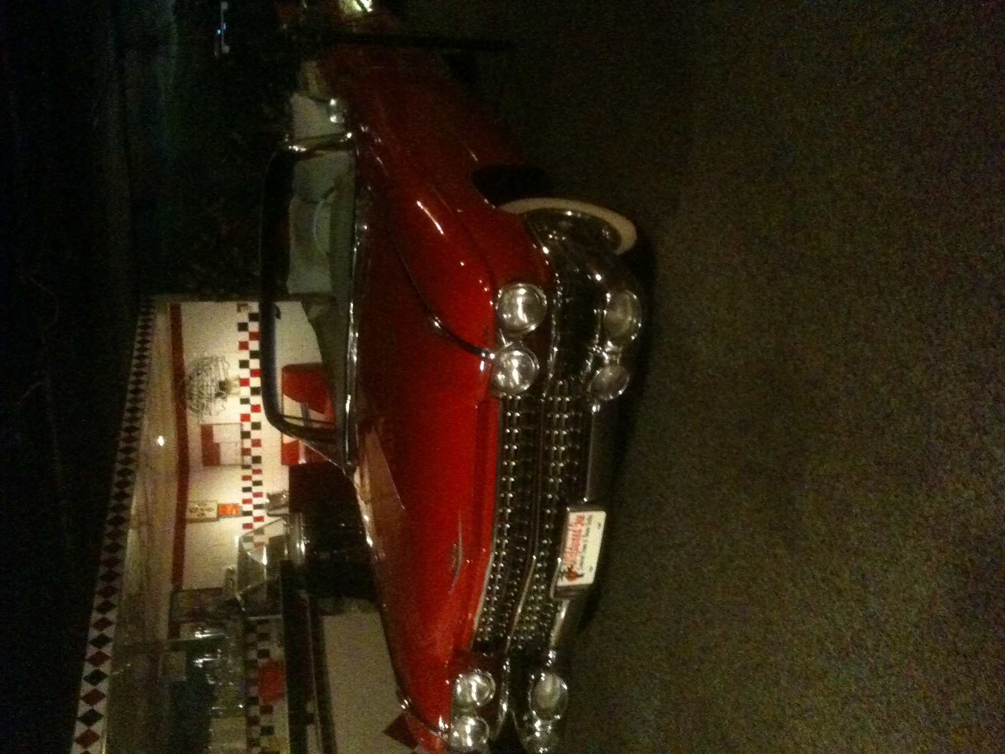

Speaking of bedroom furniture, I got to sleep in this 62 Cadillac Saturday night. It's in one room of a motel in Florence, Ky. The interior area is now a bed. The large room was of the 1960s theme. A lot of neat old antiques in the room...

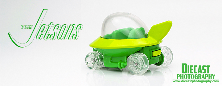

Oh, I forgot to mention - Hotwheels has just released the 2014 series, and the Jetsons car is one of them, in green. IT has a bubble canopy, but it's rather overlarge for even 1/64 scale cars. But there ya go....

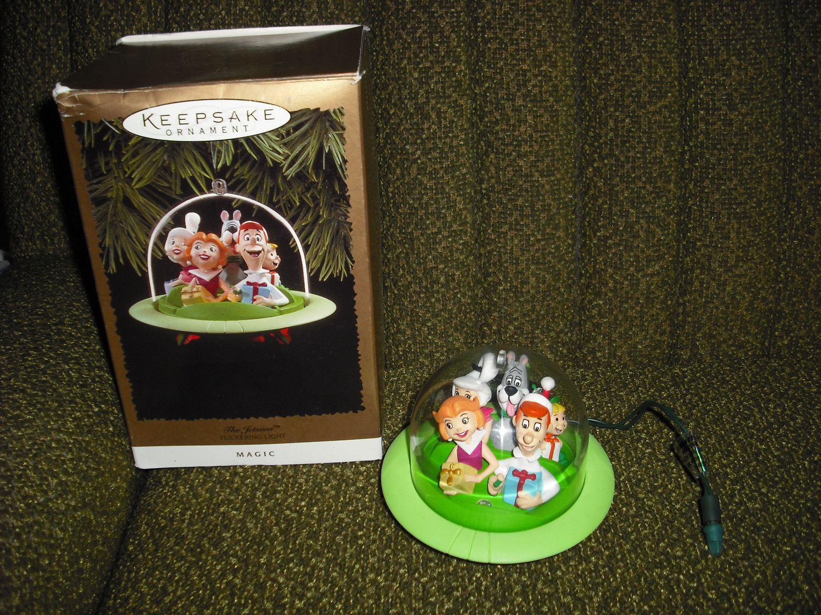

Would this work?

Here is the Hotwheels car Jerry was talking about...

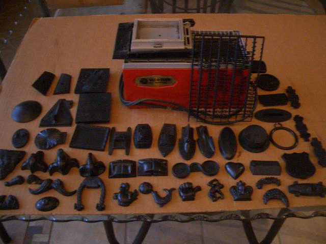

Barry, and others, so you all know.....I've been molding my own parts for years now...... I use a Medical type mold making process that works perfectly, EVERY time, with out the use of heat. BUT I have used Blow molding, and vacuum molding, and spin casting, and some others.....Even die-casting!
Look at my website, under "YTR Detail Part Molding" You'll see some of the parts, I make, and sell!

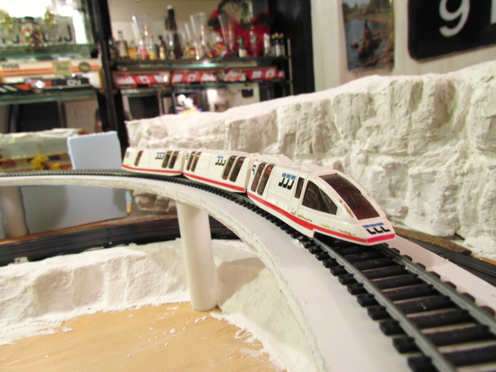

I am curious what kind of motive power and rolling stock would a space age layout use? got any pics?

So far it's going to be Tyco's Turbo Trains. I may build something else later on.
