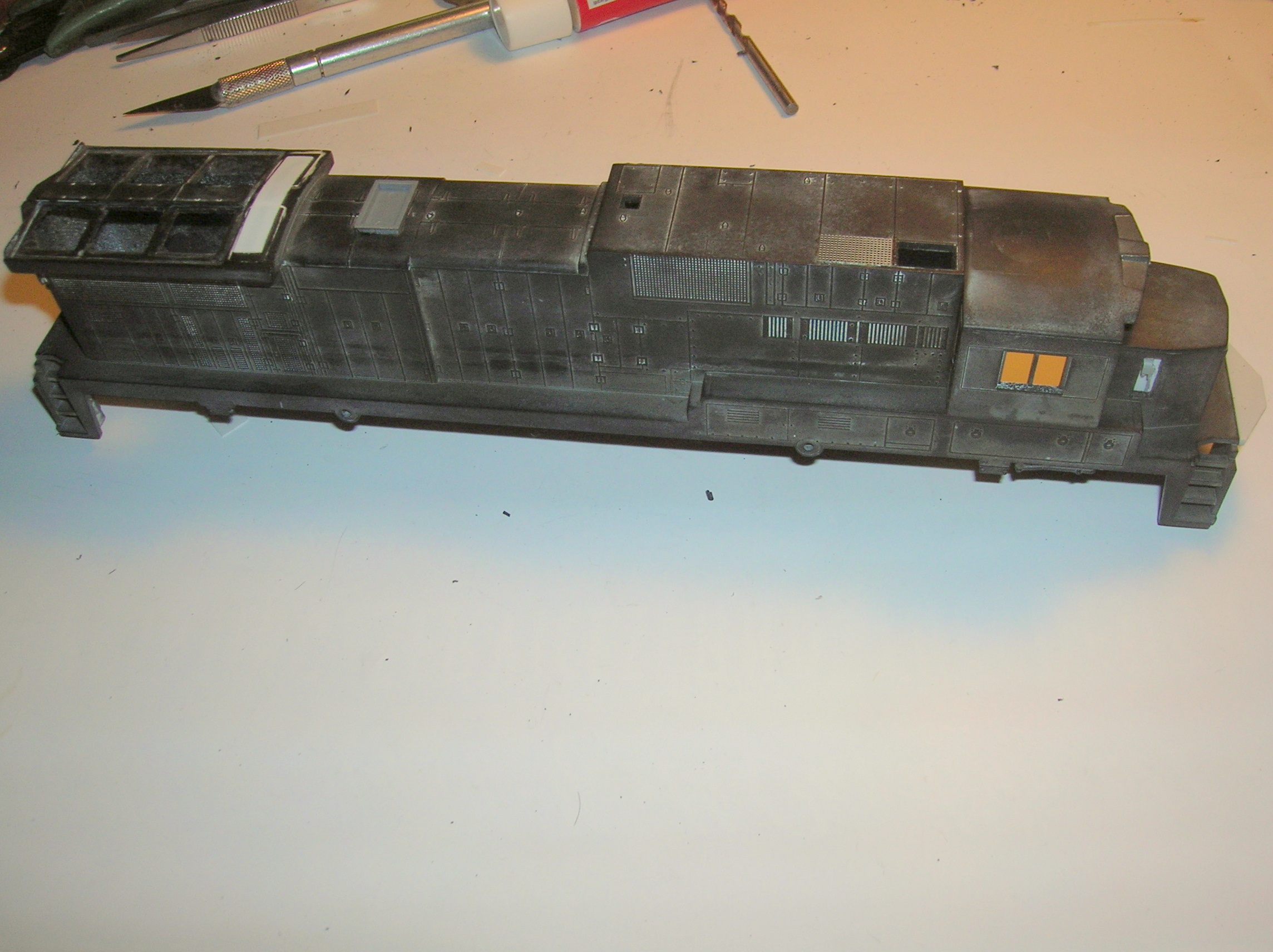

I use something called Chameleon. It's made to strip plastic models. I have not seen it harm any but, the stuff ain't cheap. Some TYCO paint falls off the model in sheets with this stuff, in about 20 minutes. Some paint are more stubborn.
Brake fluid does fine.
Easy Off oven cleaner has worked for me.
With any of these cleaners, I have found that as you try to rinse off the paint residue with water, the paint stripper is neutralized and some of the gooey paint re-adheres to the model. Scrubbing and dunking and scrubbing and dunking in the stripper is required for stubborn paint. Rinse with denatured alcohol helps. Be careful not to contaminate your stripper with the rinse.
P.S. I have some old tyco and athearn junker plastic shells that I use to test various paint strippers before I attempt it on a nice model.
A RailPower GE C32-8 before and after pictures. Two applications of Easy-Off.
Edited by - NC shortlines on October 17 2013 11:00:23 PM
