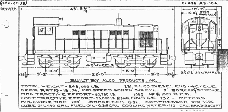

T6 Drawings are hard to find.
Hope This helps, John *********************************
Errors using inadequate data are much less than those using no data at all. <> Charles Babbage
 Posted - October 10 2013 :  12:12:57 AM Link directly to this reply  Show Profile  Click to see EM-1's MSN Messenger address  Send EM-1 a Yahoo! Message  Add EM-1 to Buddylist
John,
That's a good call! You know, looking at that diagram you may get away with a RS2 or RS-3 long hood, cut down, slightly to get the length to fit to a lower sill that's made custom to fit say an Athearn SW-7 or S-12 frame, with motor, trucks and even flywheels! I myself, have another trick to get a diagram....(Went to check, nothing their either!)
