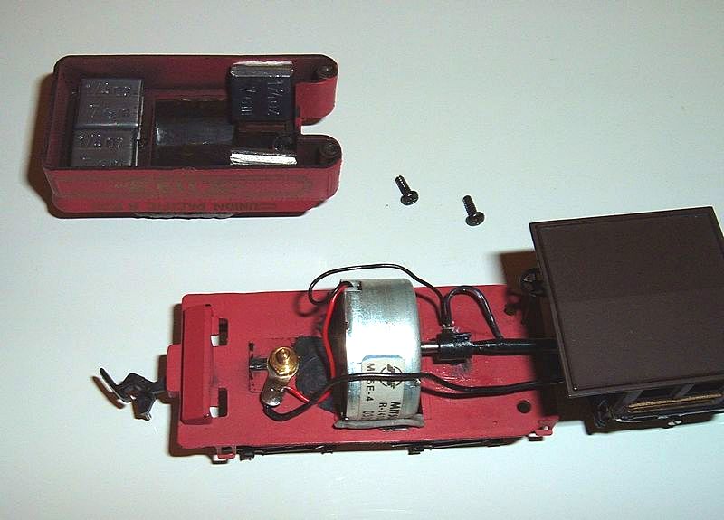

 Posted - September 23 2013 :  8:02:00 PM Link directly to this reply  Show Profile  Add NickelPlate759 to Buddylist
Here are a few iffy pictures of the repower and rewire I did on mine a few years ago.
This just shows the disk tray motor I used in the tender, but I also soldered a length of NWSL flex wire directly to the lead truck and ran it back to the tender so that everything is connected electrically, giving the loco a long electrical wheelbase. It no longer relies on just 2 wheels of the lead truck for one side of the bulb pickup, a dumb design if ever there was one.
The hard part was running the wire between the metal frame and the boiler shell... it's a very tight fit.

 Posted - September 23 2013 :  8:44:04 PM Link directly to this reply  Show Profile  Add NickelPlate759 to Buddylist
Robert, I didn't do anything to modify the existing tender pickup. I left the axle wipers as they were, so that 2 wheels on each truck pick up from opposite rails. You can see one side of the motor going to each of the truck screws, and this is reinforced by more solid loco pickup. Were the original wipers missing, or are you trying to make something like Harold's Kadee spring pickups? He just mounts those modified springs on top of the truck cross braces and runs a pickup wire to each one.
If I'm picturing it correctly, trying to get fancy with a wiper between the pickups and tender floor is needlessly complicated and a recipe for frustration with a tender of this size and weight.

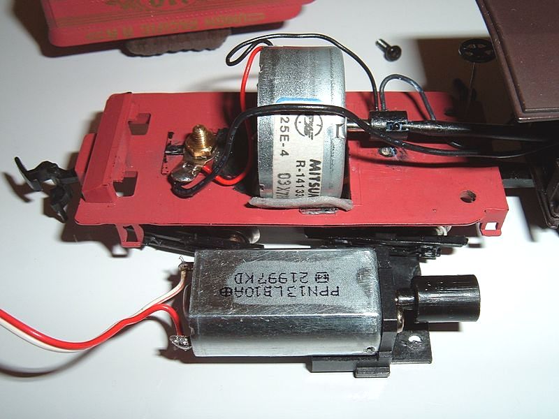

 Posted - September 25 2013 :  2:36:49 PM Link directly to this reply  Show Profile  Add NickelPlate759 to Buddylist
RB, just be sure to use stranded wire for lengths between loco and tender, and that it has enough flex. The solid stuff is fine where no flex is needed, and can even be an advantage if you want to make sure its stays put & out of the mechanism. Old electronics is a good source for small stranded wire.
Barry, yes, there is a huge difference in performance. The disk tray motor turned out to be a reasonable RPM, so it the 4-4-0 can crawl at a slow and steady speed. The only noise is from the worm inside the cab area, which I can't do anything about because Bachmann did a lousy job molding it.
The second photo shows the other more typical flat can I was considering for the job, but it was actually quite a bit faster and noisier. Since the original was a pancake motor, it also made the installation stupidly simple. Just two small pieces of double-sided outdoor tape, which is better than it sounds... it doesn't let go until you want it to, believe me. RC guys use similar stuff to mount servos.

 Country: USA  ~  Posts: 96  ~  Member Since: September 12 2013  ~  Last Visit: November 19 2013 Alert Moderator  Go To Top Of Page
 Posted - September 25 2013 :  5:14:10 PM Link directly to this reply  Show Profile  Click to see EM-1's MSN Messenger address  Send EM-1 a Yahoo! Message  Add EM-1 to Buddylist
Nelson,
That small can motor is an interesting little critter....where or what did that come from? Mount and all looks interesting.
This whole thread looks good tho, I like the way its going as far as the use of either of the motors....
I just been trying to figure out a way to get rid of that large shaft from the cab, to the tender... thinner, to be less seen!
 Posted - September 25 2013 :  6:21:50 PM Link directly to this reply  Show Profile  Add NickelPlate759 to Buddylist
John, it's been a long time, but the flat can was part of a disk drive, probably the tray loading motor.
 Posted - September 26 2013 :  12:20:21 AM Link directly to this reply  Show Profile  Click to see EM-1's MSN Messenger address  Send EM-1 a Yahoo! Message  Add EM-1 to Buddylist
do you remember the time frame and the model type it came out of?
I ask as I get stuff like that all the time to rip apart, and will keep my eyes out for the brand of machine, and the "era" with a time frame......See?
Good to know tho!
 Posted - September 26 2013 :  01:17:52 AM Link directly to this reply  Show Profile  Add NickelPlate759 to Buddylist
John,
Heck no. It's much more typical to find the pancake type I did use than a flat can. I have no idea what make or model it came from.
That size is used commonly in trunk mount CD changers; I know the one in my old car had a few in it. Since I never scrapped it, I have no idea what their voltage ranges and RPM's were. All Electronics was selling CD changer mechs like that a few years ago with various motors, but haven't in a while. Just keep looking.

Well, the 4-4-0 is beginning to look like it got caught in the crossfire in the Battle for Atlanta. Now, I need some tender truck sideframes to fix another SNAFU. If anybody's got any spares, give me a head's up.
I tried to run a wire to the lead pilot truck, ala' Nelson, but finally pulled it out. Bent the sander pipes in the process, so something else to repair. I'm going to see if I can't run the wire under the walkways in a way it won't be noticeable. Other than that, maybe I don't even need it, after some testing today that showed the drives I wired are actually grounded. More testing is in order.
I may be able to set the tender up so all wheels pickup current, and all locomotive wheels can serve as ground. That would give a long current wheelbase, with four wheels on the tender picking up current, and four wheels on the locomotive serving as a return. I redid the phosphor bronze pickup strips, and now have phosphor bronze spring wires doing the honors. Looks like a more stable arrangement, with much less problems with breakage, etc.
Right now, I set the project aside for the night. Guess I'll go up and watch the end of Little House on the Prairie with the wife.

Well, the 4-4-0 is still looking like it got caught the crossfire at the Battle for Atlanta. I still need a set tender truck sideframes (or trucks, preferably 2 pair so I can continue to mess up) to fix my latest unsolvable SNAFU. If anybody's got any spares, give me a head's up.
Otherwise, I may order a set of Kadee archbar trucks and turn my head when the locomotive goes by me so I don't see the discrepancy,
Also, received my $10.00 can motor from a seller on Ebay. This thing is so small I think I could put two in tandom in the 4-4-0 tender. I can't wait to try it out.
