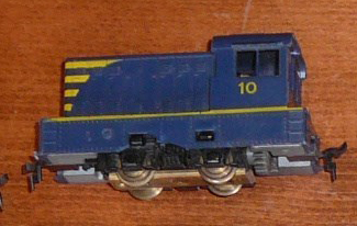

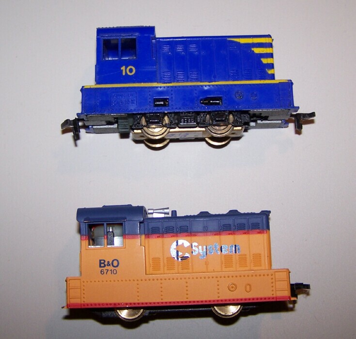

 Posted - August 16 2013 :  1:43:01 PM Link directly to this reply  Show Profile  Add artskull to Buddylist

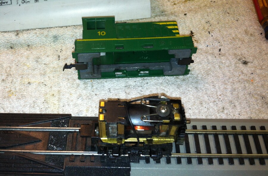

This is a photo of the Marx switcher in question. KILLED me that I had this guy 90% running and was just doing final cleaning when plastic inside near motor just snapped.
ArtSkull.com: Graphic Design & Illustration
 Country: USA  ~  Posts: 69  ~  Member Since: December 11 2012  ~  Last Visit: January 19 2020 Alert Moderator  Go To Top Of Page
 Posted - August 17 2013 :  09:10:19 AM Link directly to this reply  Show Profile  Send AMC_Gremlin_GT an AOL message  Send AMC_Gremlin_GT a Yahoo! Message  Add AMC_Gremlin_GT to Buddylist
This is a photo of the Marx switcher in question. KILLED me that I had this guy 90% running ... when plastic inside near motor just snapped.
Originally posted by artskull - August 16 2013 :  1:43:01 PM
Yeah, old age can really hurt the plastic parts. I think my Marx is actually like this blue one, too! I have a few others different colors as well. I'll check today sometime to see if I can find them, I'm pretty sure I have them easily findable for a change. Will let you know what I find out.

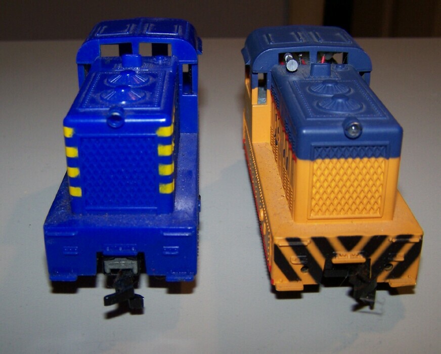

 Posted - August 26 2013 :  9:07:26 PM Link directly to this reply  Show Profile  Send AMC_Gremlin_GT an AOL message  Send AMC_Gremlin_GT a Yahoo! Message  Add AMC_Gremlin_GT to Buddylist

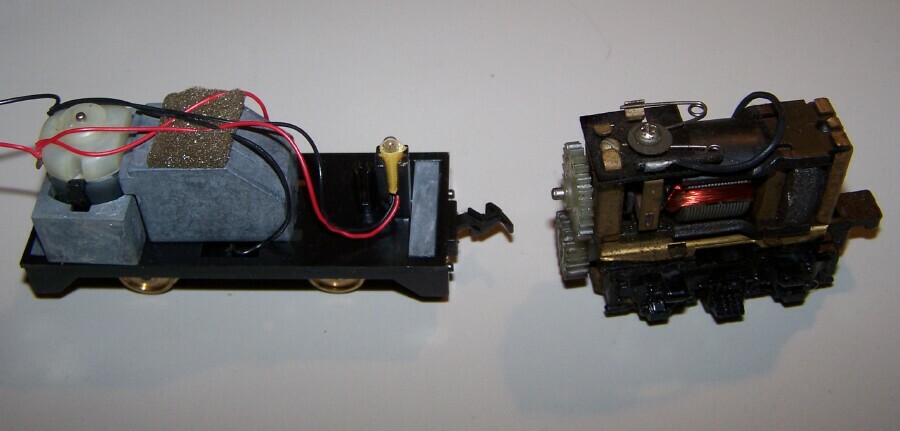

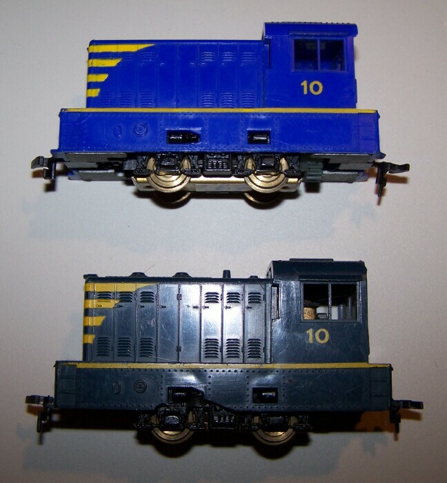

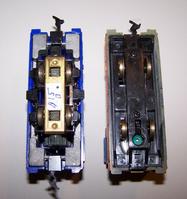

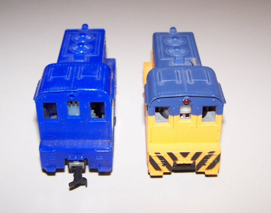

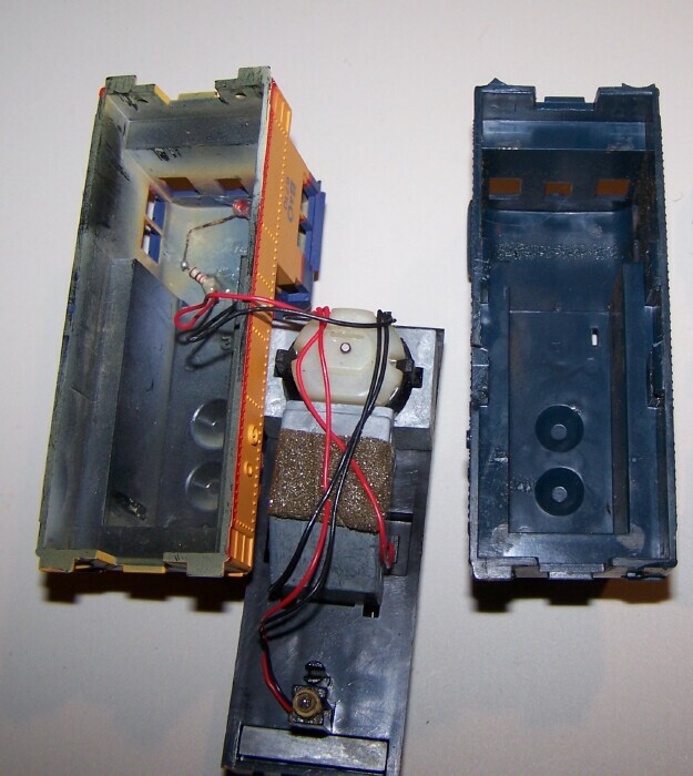

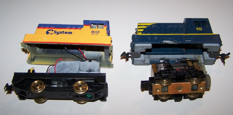

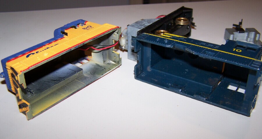

Ok, 'skully, here's what I've found out. Bottom line, might be compatible IF you do some shell mods. Not an exact 1 to 1 swap, unfortunately, but the inner dimensions are exact, if you are willing to trim some plastic and drill some holes in the ol' Marx shell to make the Porter unit fit, it should work. Here's the pictures...
Note that the Porter uses 4 holes, 2 front and rear, to mount power chassis, while the Marx uses HUGE plastic nubs on the sides to hold on the shell. Very different mounting systems.
As you can see, the side ribs on the Marx shell would have to be removed to allow the newer Porter chassis to slide up into the shell. And 4 holes drilled to accommodate the mounting plastic protrusions front and back. Not impossible, but will take some effort.
I used the broken chassis to remove the motor assembly, I didn't want to break the nice blue shell if I could help it. It was still a fight to get the power truck out!
If you have a broken shell already, I'd say go ahead and modify it for the newer power. Can't lose anything! And it would save a piece of history. That's what's fun about this hobby to me, you can modify antique stuff when it's broke, as no one else wants it anyway, and have fun with it still.
Hope this helped some, I only have maybe 3 Marx Hustlers ( I think I have a green one somewhere ... ), so I'm not planning on modifying any right now. Will keep them intact as possible. Any really edge-broken shells I'd modify in a heartbeat, though!

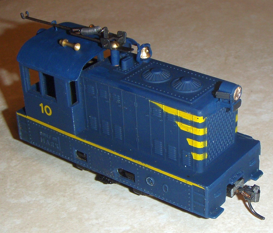

 Posted - August 26 2013 :  10:20:36 PM Link directly to this reply  Show Profile  Add shaygetz to Buddylist
Originally posted by AMC_Gremlin_GT - August 26 2013 :  9:07:26 PM
Yup...had a ball modifying my damaged one to look like a switcher set up to trip street signals on an electric interurban line...
 Posted - August 26 2013 :  11:19:26 PM Link directly to this reply  Show Profile  Add NickelPlate759 to Buddylist
That is really cool, Shay. Very clever. Looks like you got the pole from an AHM trolley.
 Posted - August 26 2013 :  11:56:03 PM Link directly to this reply  Show Profile  Add Redwoods to Buddylist
I really like that trolley pole, that's a neat idea.
 Country: USA  ~  Posts: 1093  ~  Member Since: July 07 2011  ~  Last Visit: November 12 2026 Alert Moderator  Go To Top Of Page
 Posted - August 27 2013 :  7:53:13 PM Link directly to this reply  Show Profile  Add shaygetz to Buddylist
thanks guys...yes, it's an AHM pole I had in the junk box. The SP had several switchers that did street work in parts of the Pacific Electric interurban route. They didn't actually draw juice, they tripped signals as they went about their business, making for a rather unique look.

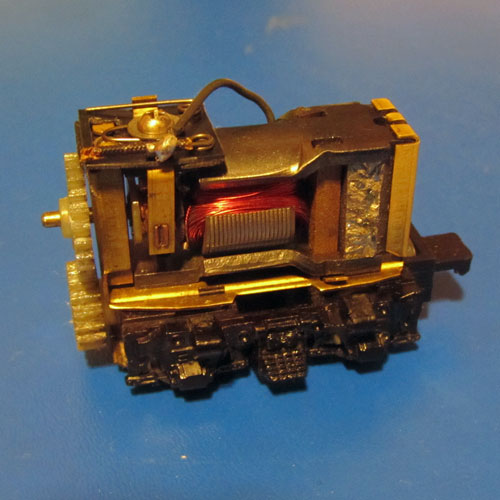

 Posted - December 05 2013 :  07:41:40 AM Link directly to this reply  Show Profile  Add artskull to Buddylist
So… I finally got replacement brush holder board, got it installed, and re-soldered wiring. Now the question is… what is the best lubricant to use on the gears. Any suggestions???

 Posted - December 13 2013 :  8:03:05 PM Link directly to this reply  Show Profile  Add artskull to Buddylist
I ended up using Labelle 106 grease for the plastic gears. It's only taken a year, but old #10 is up and running again. Just in time for Christmas! Thank you Tyco forum members for your help and inspiration in keeping motivated to complete this restoration.

Here is Marx switcher with replacement plate bought from vendor on ebay. I've lubed up the gears, cleaned the brushes but it doesn't seem to want to run. Anywhere on this old soldier that needs oiling? I've read enough on the forums that oil should not go near the brushes and commutator. Any pointers that I might have missed are appreciated.
 Posted - January 05 2014 :  3:14:52 PM Link directly to this reply  Show Profile  Send AMC_Gremlin_GT an AOL message  Send AMC_Gremlin_GT a Yahoo! Message  Add AMC_Gremlin_GT to Buddylist
Here is Marx switcher with replacement plate bought from vendor on ebay. ... but it doesn't seem to want to run. Any pointers that I might have missed are appreciated.
Originally posted by artskull - January 05 2014 :  1:37:06 PM
Ok, first question - are you trying to "run" it on the track as the test? My first test is ALWAYS jumper power directly to the brush arms, and see if the motor will run freely with direct power. if not, then you've got direct motor problems. If it runs fine with direct power applied to both brush arms, then the problem is with the pick-up, either frame ground or wire to other side, or the axles/wheels.
Sequence to test
1- direct power to brush arms , does it run freely YES or NO
- if YES, move on to 2
- if NO, check gaps in copper plates for crud buildup, or motor could have a bad / shorted armature winding
2 - apply power to wheels, does it run freely, YES or NO
- if YES, it must be good.
- if NO, try using a small slender metal rod on the power wire clip, and try to make contact with the contact that supplies power pick-up to the axles. Does it run better, YES or NO
- if YES, then the contact is not doing it's job, might be bent and not enough force on the wheel.
- if NO, the wheels could be dirty or oxidized, and need serious cleaning.
Only other problem it could be is that the magnet has lost some of it's charge, and can't make the power anymore. Also remember that this power truck is outside of it's shell, and no extra weight, it may not run by itself on track without additional weight to help it make rail contact for a good electrical connection. Some motors are so lightweight that they just won't run without the shell weight attached. Also are you using brass track or nickel-silver to test? Make sure the track is cleaned/shiny if brass, or it won't conduct properly. Brass oxidation is NON-conductive, nickel-silver track oxidation is conductive. So clean brass track is essential if you are using that.
