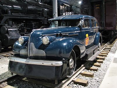

There's a railway museum about an hour from my house that has an old car ('39 Cadillac/Hudson/somethinglikethat) that had its rims/tires removed and was fitted with train wheels back in the day. I guess that wouldn't be considered a hi-railer, but it gives Justin's idea some plausibility
 Posted - August 05 2013 :  5:38:08 PM Link directly to this reply  Show Profile  Send catfordken a Yahoo! Message  Add catfordken to Buddylist
hi dacheez they are or were called rail inspection cars ken

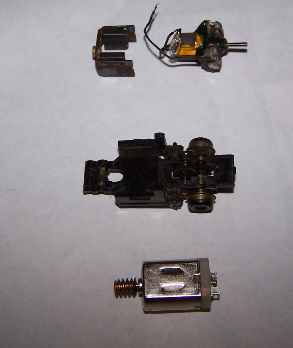

Having been bitten by the slot car bug again, I've been working on those, but this topic has caused me to start working on these older Bachmann Jeepsters as well. I took some to work yesterday, and I have found a replacement can motor at Radio Shack, 9v with 24,000 RPM no-load. REALLY runs smoothly! I powered it with a MRC power pack, and it stops accelerating about half-throttle, so I will probably add a resistor to keep the speed down, and not burn out the motor. :) I am trying to find my gear puller to remove the worm gear off the old motor, looks like the new one has the same diameter shaft, although a bit shorter. Should work OK, though. I've already modified the chassis of the Trackster, it should take this new can motor OK. It was only $4. It is worlds better than the original motor. I hope this works, would be awesome to get this DCCed with an N gauge Decoder, and run it at shows. Will keep plugging away at it.

Word from the wise. that motor, you bought at Radio Shack. go buy ALL of them that that local store has.. they have been discontinued! Radio Shack has become lame for electric parts. as they carry all pre-made stuff now......I used to buy my 12 VDC motors from there for $4.00 each, with good power, great speed, and a reasonable price....these same motors, have been gone from their product line for over 10 years now1 AND they have discontinued the whole motor line all together!!!!!

Well, if this project works, I'll be sucking up more of those little 9 volt motors for sure! I"m sure I can find more surplus online, but I just wanted something I could get my hands on quickly! My main problem now is getting the brass worm gear off the old Trackster motor without damaging it, as it's 2mm size, and that is TINY. I have a small press, but that pin broke last night, it was so stuck. I will take it to work and see if I can use our professional grade presses and find a tiny punch in the tooling bin to fit.
I modified the Jeepster chassis with a Dremel, had to remove most of the original rear motor hold-down plastic as the new motor is slightly longer. I "think" this is going to work, I hope so, this motor runs very smoothly, and should make the old Trackster a more viable operating accessory.
 Posted - August 17 2013 :  8:59:45 PM Link directly to this reply  Show Profile  Send AMC_Gremlin_GT an AOL message  Send AMC_Gremlin_GT a Yahoo! Message  Add AMC_Gremlin_GT to Buddylist
Well, I went on a 2nd job interview today, and also went by work to try to get this worm gear off the Bachmann motor shaft with some professional presses. I found my good Pinion removal tool friday night thankfully, in my Project tray, with the steel plate, and with that and a good piece of tooling, I was able to finally remove the worm gear. Fits like a glove on the Radio Shack motor!, Shaft is shorter, but I don't think it's gonna budge anyway, it's at least half-way on. Next step is more chassis plastic mods, I have to remove a plastic shoulder to move the motor backwards more to center on top of the axle gear. Once that is done, I can set the motor in place permanently. Maybe by the end of the week I'll have this thing running and operating on the track. I think the major hassle is over, the gear switch. Now it's just fitment, placement, and wiring. Here's a few pictures of the pieces as they are now.

Well, it's better than just about anything on the market I've seen, but the steel in the press pin is weak, it broke when I was trying to press the shaft out. However that tapered plate is a MUST HAVE to get behind the gear, worm or otherwise, as that is GOOD steel! Cost me $35 I think for the whole tool, and worth it, as I had to use that plate, and a professional grade press pin to get the worm off the shaft. I just put the plate and motor on a vise, and used a hammer and a good steel press pin insert bit to drive the motor off the worm gear. I also bought a "battery terminal" type gear puller , but the arm teeth are not angled correctly and will slip off the gears, and can damage the teeth, which is why I like this slide-plate type, it can't move once it's in the groove, and it's flat, so it sits flush behind the gear. the press bits are the weakness, but the plate is a must-have. No one else makes it quite like this one. I'd recommend it despite the pin breakage.
 Posted - August 20 2013 :  9:26:50 PM Link directly to this reply  Show Profile  Add NickelPlate759 to Buddylist
Now that you mention it, I see the busted press pin. They're available on eBay for as little $17 w/ free shipping, so I'll probably spring for one. I just hope the pin lasts. As you said, the backing plate is almost the most important part and can be used across a vise, or even as an insert for one of the NWSL pullers. Why NWSL uses a flexible aluminum box with a soft steel backing plate is beyond me.
 Posted - August 21 2013 :  03:49:32 AM Link directly to this reply  Show Profile  Click to see EM-1's MSN Messenger address  Send EM-1 a Yahoo! Message  Add EM-1 to Buddylist
Not to make you guys sick......
I actually machine made my own version of that same sort of puller, AND press! Thing is, that pin.....ought to have been made out of something strong, I choose to use gun barrel steel.....Hardened, and awe-fully stiff..... was a bugger to machine tho, but I got it, BUT, I did NOT machine this, in my own shop........I made this tool about 6 or 7 years ago, in a place I worked at lunch time, when I was painting logging equipment......I made a lot of tools for my own shop, in that shop too.......And it didn't cost me a small fortune to do it either......Although, $35, for that pictured press is a good price, and it looks to be a really good tool, and well made, otherwise, who makes that tool Jerry? Not sure I know of that one as I may even invest in another one in the future as I'm not sure ole "HMC" will allow me to use their metal shop at lunch time anymore Altho, with George, (my ole supervisor), may let me LOL, you never know with him!
 Posted - August 22 2013 :  05:22:53 AM Link directly to this reply  Show Profile  Add NickelPlate759 to Buddylist
Actually I think that's called the V plate, and the ones included with the NWSL pullers are pathetically soft. You might as well cut a V into a slice of American cheese and try to brace a gear against that.
I know plenty of guys have made a new puller frame by cutting off a section of square steel tubing, giving it much greater rigidity. Of late I just clamp the puller in my machine vise to keep the box from flexing.
