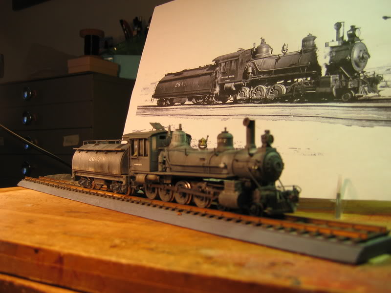

Sometimes you gotta make do with what you got.
 Posted - July 22 2013 :  5:34:10 PM Link directly to this reply  Show Profile  Click to see EM-1's MSN Messenger address  Send EM-1 a Yahoo! Message  Add EM-1 to Buddylist
DAMN that's close Mike! You build that?!!!!!!!

Unfortunately no. It was just an example I stumbled across.
 Posted - July 23 2013 :  02:10:00 AM Link directly to this reply  Show Profile  Add Barry to Buddylist
That is fine! Are you gonna tell me that's a Tyco-Mantua?

Sure is. Certain of it.
 Posted - July 23 2013 :  12:24:57 PM Link directly to this reply  Show Profile  Add Barry to Buddylist
I would really enjoy seeing more pictures of that to check out what the builder did to detail that so fine. I did find the following note on Rogers 4-8-0 locomotives . . .

http://cs.trains.com/mrr/f/88/p/136284/1528846.aspx#1528846
Here you go.
 Posted - July 24 2013 :  12:40:40 AM Link directly to this reply  Show Profile  Add Barry to Buddylist
Thanks Switcher. I checked that page out. Would have been fun to see a photo story about his rebuild. I dug that crane that he powered with the tender.

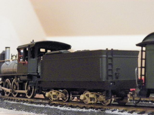

So to my limited eye, it looks like you sort of added an extra 'front end clip'; cut a 2-8-0 framed just behind the pilot (or so) and then cut another just behind the front drivers and then put those together? Or something like that? That's pretty bold. Have you had it running? Then I guess you have to mess with the side rods? Keep the photos coming if this is a work in progress. The wheels match up real nice. I dig seeing what folks do with these Tyco-Mantua steamers. Some amazing things. And . . . I guess as long as your talking 10 wheelers, I'll add a photo of the tender of a Mantua 4-6-0 that I just put new trucks on. The trucks are from Precision Scale Co. ($11.50). I hadn't intended to get brass; just wanted to try some new trucks on the tender to improve electric flow. No other changes and I'm able to operate the loco 10 to 15 miles per hour slower (by the transformer for whatever the heck that means; looks good anyway). I should paint them black, but I'm kinda gettin' off on the brass look. They were work, though. You have to clean them up a bit (stuff in the holes with like a 1/16 bit) and then assemble them while making sure not to send that little spring flying across the carpet.
 Posted - July 26 2013 :  02:34:15 AM Link directly to this reply  Show Profile  Add NickelPlate759 to Buddylist

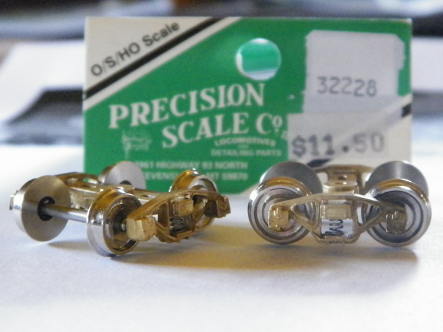

Barry, I like the way that 10 wheeler is looking, and the new PSC trucks look great, though they may be too modern for a loco of that era. I'd go with archbars if your LHS has them.
I would also consider axle wipers to reinforce the electrical path, because you don't want the springs to become the only conductor, which can happen when the bolster comes out of contact with the sideframe. It can heat them up and collapse them, especially under heavy load or a short.

Thanks for the tip Big Boy. I'm still pretty ignorant about what equipment goes with what on the detail side of things such as which trucks are supposed to be used with specific era. I mean I have some basic ideas like passenger trucks don't go on a freight car. I'll check those arch bars out. And I need to learn more about the business of axle wipers. It's always something isn't it. I think you can put more time in building an HO locomotive than the real thing.

Edit: here's a Model Railroader guide to freight truck types. I just saved a copy myself.
http://mrr.trains.com/~/media/import/files/pdf/4/c/c/mr_pi_5-06_freightcartrucks.ashx

Thanks Nelson. I'll check that out before I buy any more trucks.
