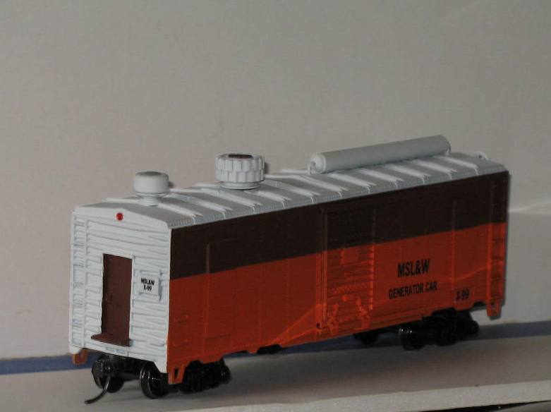

The front end has a scratch-built door and frame (although the idea is copied from other better modelers than I) to allow in-use access from the locomotive, as this car travels directly behind in transit. The door handle is .25 steel wire.

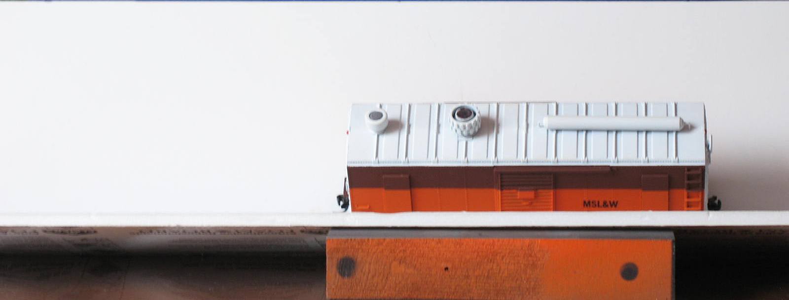

The roof cylinder may represent a cooling system, but I am not sure. I made it with two larger decorator jewels sanded round and glued to th ends of a styrene pipe, with .25 steel wire representing the plumbing lines. The larger vent is the exhaust from the generator inside the car, made from a lego-type toy tire and wheel; the smaller vent is an inlet for fresh air to the generator. The reason for the louvers and wire screen is to provide sufficient passive airflow for cooling inside a steel boxcar, which might get a bit hot with an engine running in it.
The small jewel at the roof crown is meant to represent an indicator light, so the engineer can check visually to see if the car is "on" when moving. There is an identical light at the other end.

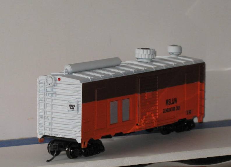

The screen is made from .80 copper mesh, applied from the interior with a frame on the outside. The two louvers on each side are made from .030 clapboard styrene. I originally was going to place them in cut-outs of the car wall, but felt that would compromise the structural integrity of the car.
I painted the ends and roof white to make this car stand out and not be confused with other Sioux Lake equipment, due to it's special use as a power car head end unit.

What did you use for the ventilators? The bottom most picture, with those "windows" are those filled in with screen? They look like some sort of side vent.....yes? no?

The louvers are Evergreen #4031 clapboard siding (.30 inch spacing). I had some wider clapboard, but looking at the drawing and the Nevada car image ( prior post on this project), the wider stuff did not look appropriate, so I got narrower siding.
