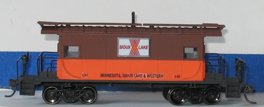

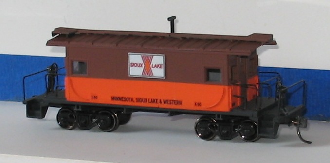

I saw a number of transfer cabooses advertised and found that the purchase threhold was a but high. I realized I had several duplicate Athearn cabooses acquired from various swap meets, so I figured I would try my hand at my first attempt at merging two separate car bodies to make my own.

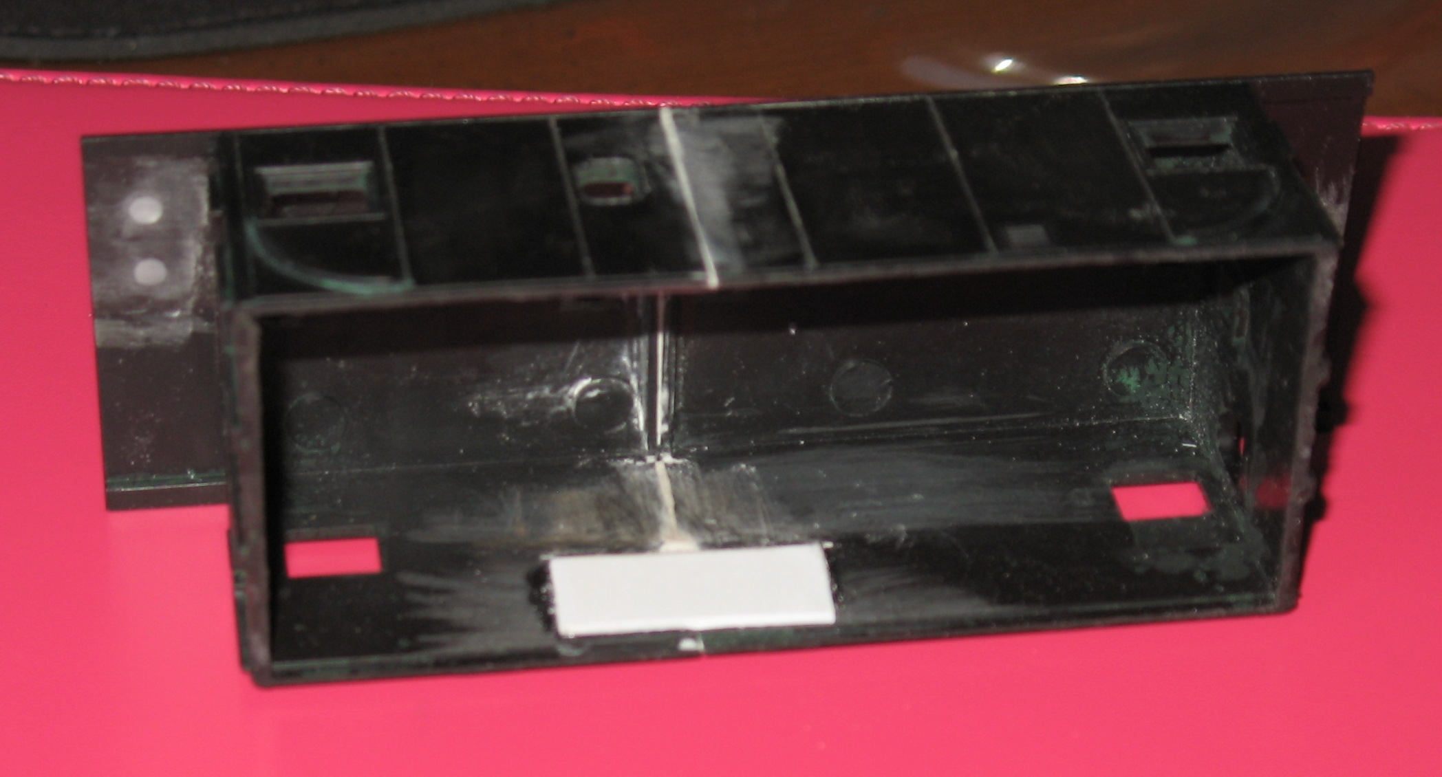

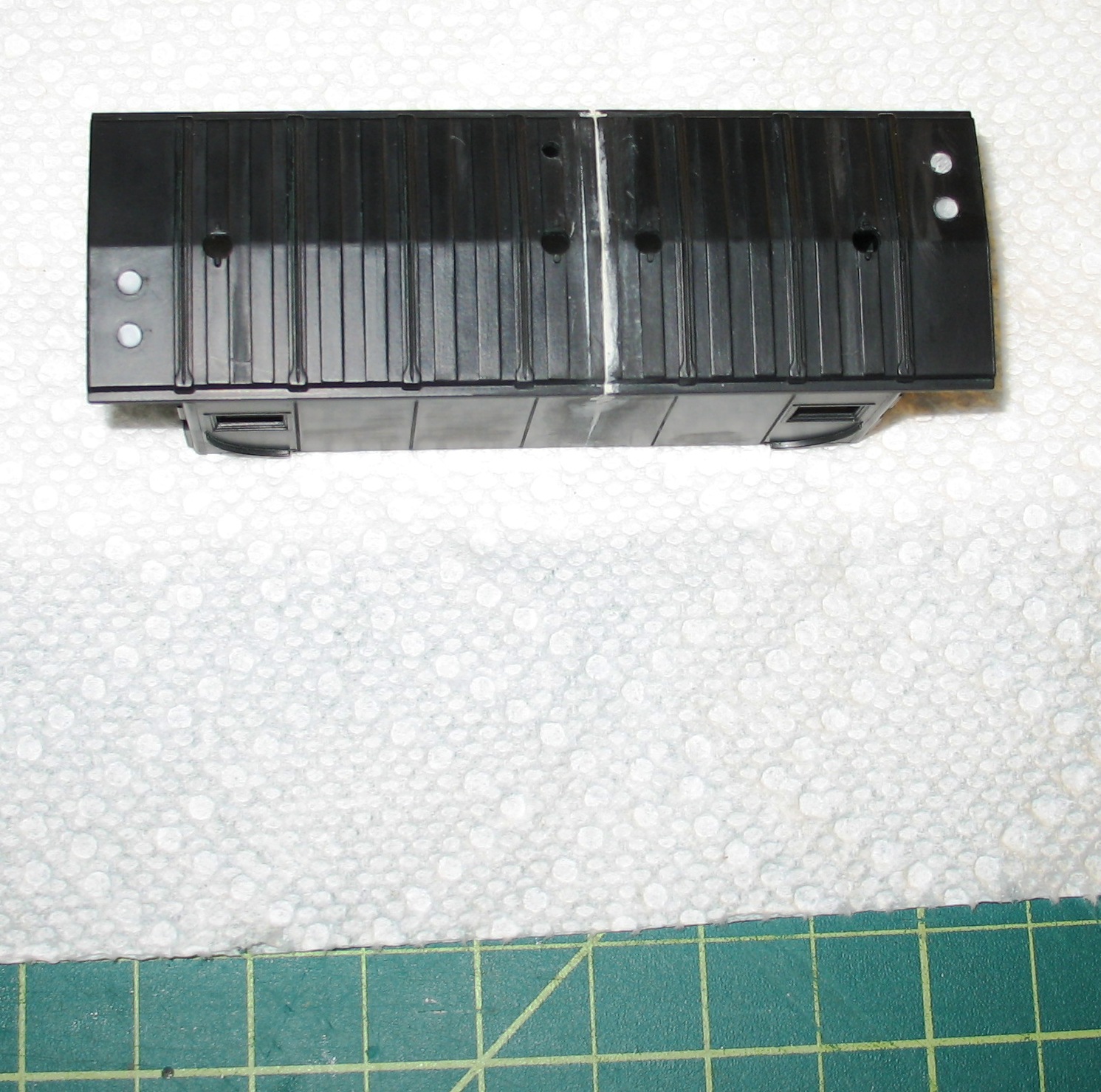

I used a masking tape line to identify the midpoints on each car, then used a Zona saw (the one with the wood handle) to cut each where marked.
I used a piece of scrap plastic glued in as a reinforcement on each side, then used Squadron white putty as my filler, sanding and refilling twice to ensure a smooth fit.
I was originally planning to solder phosphor bronze wire into a set of side & end railings, but realized I was working with very small pieces and chickened out in favor of .020 steel wire in a novel railing arrangement.
Glazed the windows, weighted the car to NMRA recommendations, painted it for my Sioux Lake railroad and glued red jewel pieces to small styrene tube ends for safety lights over each door.
This one sat on the bench for 2 months while I dithered about the railings, but now it is ready for yard crew transfer action.

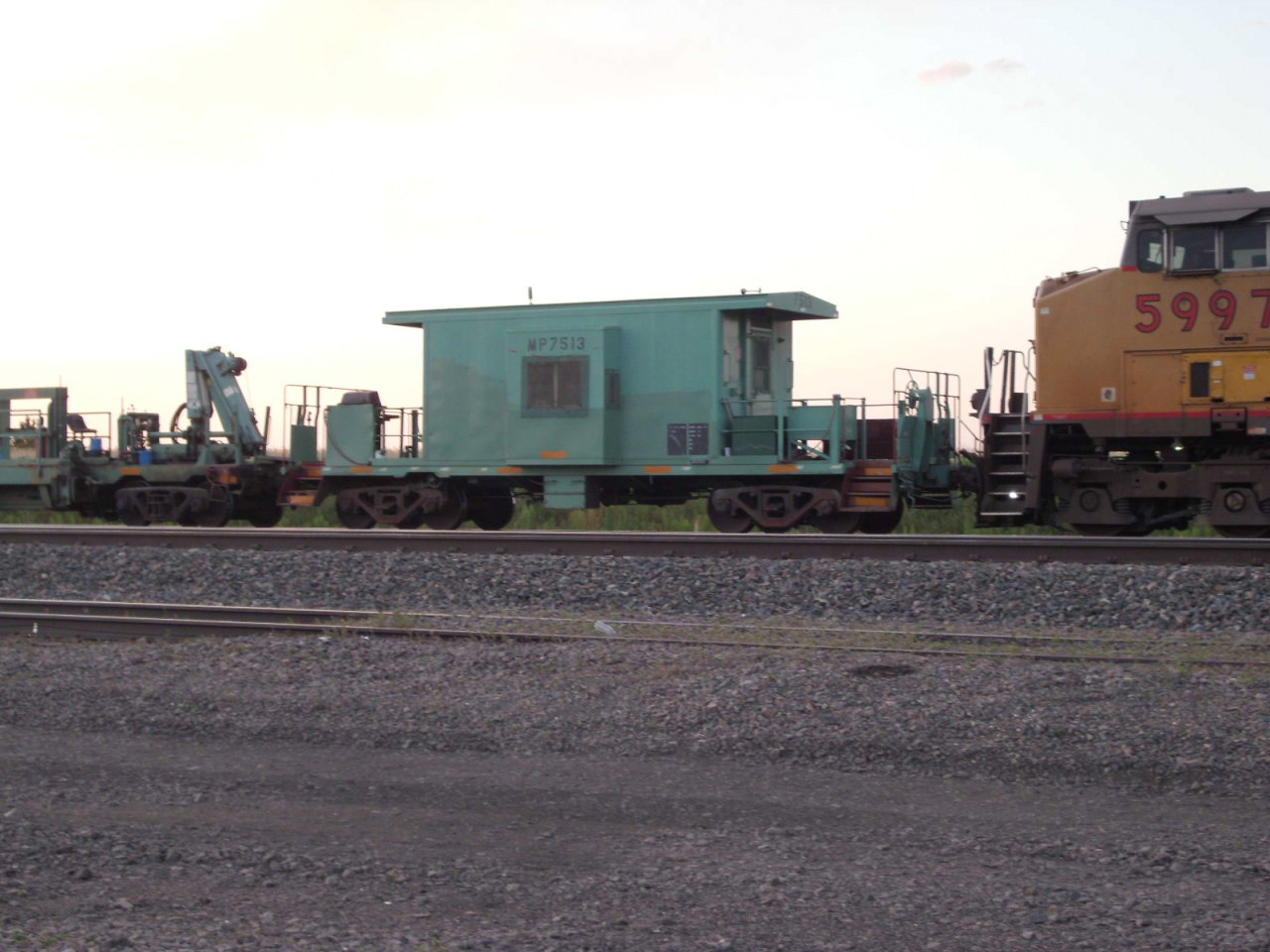

 Posted - July 14 2013 :  2:22:22 PM Link directly to this reply  Show Profile  Add microbusss to Buddylist
Here you go, EM-1
See the BBQ grill on the left?
This was on a UP ballast train & there were cabooses on each end
