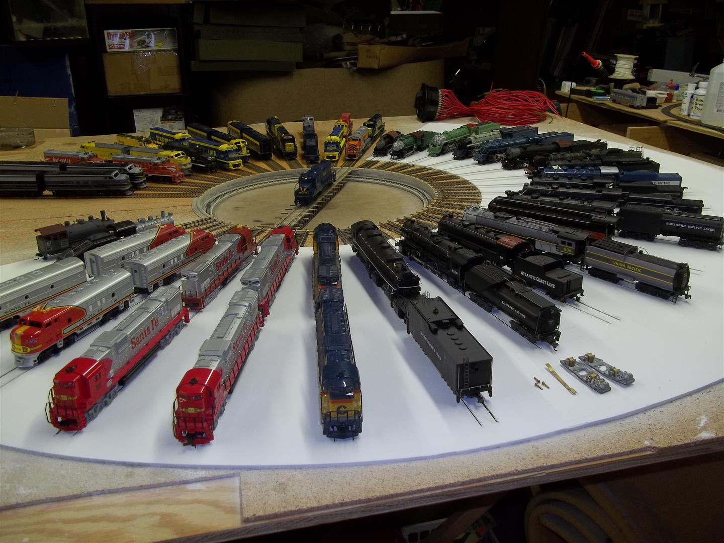

I wanted to share a couple of pictures of my turntable and roundhouse stalls as they are at present. It is a Diamond Scale 134' girder turntable with 36 engine stalls (20 roundhouse stalls), three leads for the inbound and outbound tracks, and one lead for the back shop. The first wall of the roundhouse is pretty well completed, but the roundhouse is on hold for my winter project. I was going to use the NYRS indexing system, but I happened to find a 40 position double pole rotary switch. Along with an MRC transformer and a couple more double pole switches, I can control the polarity, turntable speed and indexing just fine.
Oh yeah, I thought I would show off some of my locomotive rooster.

Looks like you are a heavy hitter in the train game.
What is the NYRS indexing system?

Wow, that's going to be a massive roundhouse. I really like that turntable.

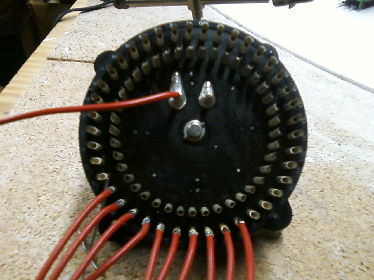

I just noticed the rotary switch in the background. Are the wires color coded?

Now THATS impressive! The roundhouse scratchbuilt?

* Well it looks great to me to. Is there, or will there be a layout tied into it for running the locomotives. Good luck with everything.

It is a nice turntable, but there is still a lot of fine tuning and detail work to finish on it. I wanted a big turntable to be handle the large locomotives. The EM1, Allegheny, Big Boy, and Challenger sized locos are on my bucket list, so we are gonna have to have room for them. lol
Here is the switch. At the moment I only have the power leads soldered in place, and I may hook all the common wires up to a separate bus bar. I experimented on one of the positions and discovered that I can run a power lead off both poles and not have a short internally. I was pondering having an indicator light of some sort for each stall or lead track for identification when that particular track is selected, to help the operator know which track they have selected.
The roundhouse will be scratch built, with the exterior details being from Grandt Line. I was going to do a full blown interior (and that may happen in the future), but at the present I am wanting a place to park the steam locomotives to keep the dust off of them. So I may just mock up a quick card stock structure for them.
Yes it will be attached to my "empire layout" The room is 24 x 29 and it has been deemed the "train room". I have some things in there to contend with (as we always do), so I will not be able to use the entire space, but a very large portion of it will be for the big layout. Directly behind this table is the next layout section that will be attached to this one. Overall the locomotive facilities will be approximately 6' x 14' and will allow some room at the end for leading off to the rest of the layout. This will be one of the peninsulas on the layout.

Yea, yea, yea, the round house is very sweet and all that, but the first thing I seen was that Western Pacific GP20!!! It's the last TYCO geep I need.... How long have you been building this?

Just enlarged the pictures those Chessie C-630's are AWESOME! I WILL have me a set of them.....Just because they're Chessie and they are older "High-Nose" diesels!
Whats the cab owner ship ICC tag on those? C&O?

You mean I got a rare loco in that Western Pacific? I picked it up off ebay a month ago for $25. I just thought it was a really nice looking loco and though it would be a nice addition to the fleet. It does have a slight blemish on the top of it, you have to be pretty close to it in order to see the blemish, it runs really well though.

Yes John, they are owned by the C&O, and they carry the usual #1102 road number. The one closest to the turntable is a Mantua/Tyco and has metal handrails, it has a loose sideframe on the front truck, but we'll get that replaced soon. The other is a Tyco with plastic handrails, which I will get replaced with metal handrails. They both run well and still look pretty good! I need to get more of them, but they tend to be commanding some high prices as of late. So we'll just keep looking for now.

I started this project back in the winter of 1994 and 1995, just after I lost my son in a car accident. I worked on it for about six months and then just lost all interest in model railroading. At that time I was going to model in fine scale, what a flippin' nightmare that became. I discovered that fine scale was too much intricacy for me. The tables sat in my workshop/ junk room covered in everything imaginable.
Last summer I uncovered the table behind this one in order to set up a loop of track to test new loco purchases. I spent last winter working on the design and the first sidewall of the roundhouse. Then it came to the point of needing the turntable accessible to check the length and sizing of the wall I had built. I spent two weeks carefully uncovering the turmtable, praying for no damage.
Once I had it uncovered and cleaned, I found that I had built the wall longer then what the individual stalls were. The wall was built to the length I would need for the bigger articulated locos, the tracks could only handle locos up to a 2-10-2. I was lucky that not all of the stall tracks had been covered in plaster, and I could modify the length to compensate for the bigger locos. Six of the stalls will hold the bigger locos, the rest of the stalls will leave me some open floor space to allow me to detail the interior if I choose to do that later.
The track is code 83 Walters/Shinohara, I have a another 12-15 pieces of flextrack left, along with a few double crossovers and other turnouts that will be used on the next section that will be the lead into this one to hold the water. coal, sand, and diesel facilities. I am wishing that I would have done this in code 100, the tolerances are very close to not working when it comes to combination of the plaster and the larger flanges of the wheels. But with some patience and perseverance, it works great.
