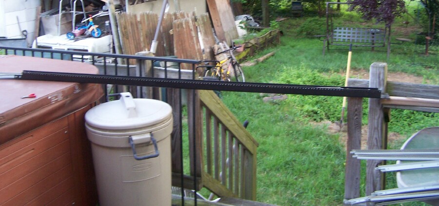

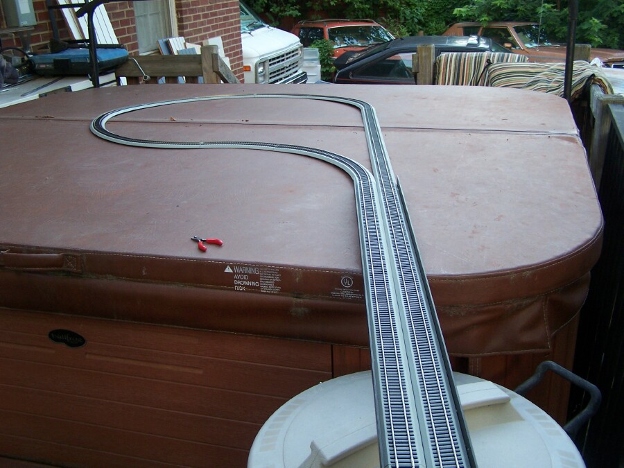

Being a consummate packrat, I have totally filled up my basement to the point I can't put a layout in. Been busy cleaning it out last year and this year, I've got major pathways now, but still more stuff than will allow enough room for a layout. SO, I came up with a solution, at least for now, that will allow me train operations during good weather. I salvaged some computer cabinet C-channel from my wife's office when they had to clean out an office, and mucho computer racks had been left behind. I got quite a bit of useable stuff!
Anyway, one issue with the C channel was width. I thought about using flex-track, but decided, being an outdoor railroad, that I would use EasyTrack by Bachmann for ease of set-up and tear-down. It will be a modular removable layout hanging off the outer edges of the deck railing. My goal is to have an L-shaped "layout", but will probably start off with a Dogbone style to get it up and running quickly. That said, the Easytrack was slightly too wide with both pieces in the channel. I needed a router for plastic. I hit on something at work, we have a small drill press, and I also have used Roto-Zip bits to cut plastic parts. I thought, hmm, all I need is a backstop to slide the track against, and it should be stable enough to rout the edge. I had an L-shaped 2 foot metal support bracket that was 1/4 inch thick, so would not give. I C-clamped it to the drill press at one end, pivoted the bracket until the track was just getting notched about 1/16th of an inch. Then I locked down the C-clamp and zipped away! Worked as well as I'd hoped, I just took it slow, and doing the 36" long pieces I'd bought at my LHS, I did 3 at first, took them home, and trial-fit them. I was hoping I'd only have to do one track side, but looked like it would need 1/8th off total. So , when I flipped another one around with the routed edges outward, the pair fit fine. Ok, have to mill them ALL now, not just half. Took the other 9 pieces to work, and got them done this week during slack time and break. Tonight is my first set-up attempt. I improperly braced the "bridge", and while I was trying to put the loop on, it slid off the brace, tilted up, and crashed to the deck. Bent up 4 of the rail joiners. BOTHER! said Pooh-man. Got out 4 more straights, and this time pulled the bridge over to the railing and it had a secure set point.
Back to the loop. Got it set in place, and hooked it all up. Nice! I won't be running it on the hot tub, I intend to run it on the outside of the railing, but since I COULD, I may come up with a method to run it across the deck table as well. But it would be out of the way on the outside railing, and I could still get off the deck by the side stairs. I will need some substantial brackets, I think flowerbox brackets should hold well enough. I may have to shim or adjust, but shouldn't be a big issue there. At any rate , here's my design and photos of the actual track set up outside tonight.
