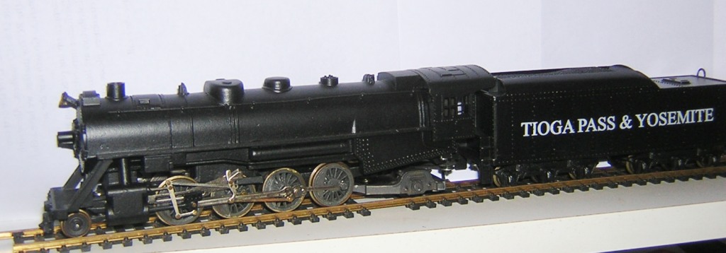

This is the latest Mantua Mikado. Unlettered as of now. Front mount bell, version 2 with gearbox screwed to frame. Friend was cleaning out junk, found it and gave it to me.

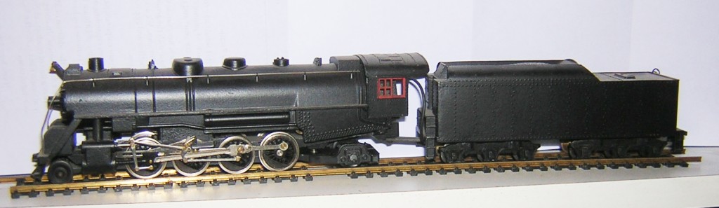

This is my first Mantua Mikado. We got it from family friends in, oh, 1960 after they'd outgrown it. We literally ran the rods off it. I replaced them and axle bearings in mid-60's. Odd, because it's a metal cab, metal tender, version 2 with a headlight. None of my others are drilled for it. And I didn't do it! Bell mounted on top of boiler.

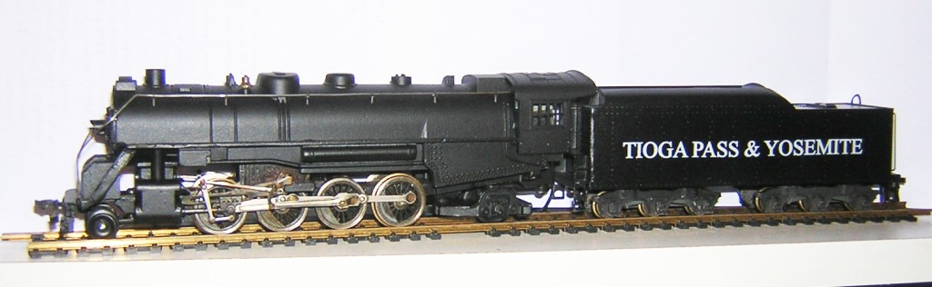

The second one I got. From someone on a Yahoo group. Frame had gone bad, they had tried to make a Version 3 frame fit a Version 2, and I think they gave up.
I finished it. It has a modified Version 3 frame with the Version 2 gearbox screwed down to the frame. I actually plugged all the extra holes with steel 2-56 ready rod, locktited in, filed flush, glass beaded and painted. Metal tender, cab, just like the other two. Smokebox mounted bell.
They all run very nice. One day, I'll triple head them on the local club layout.

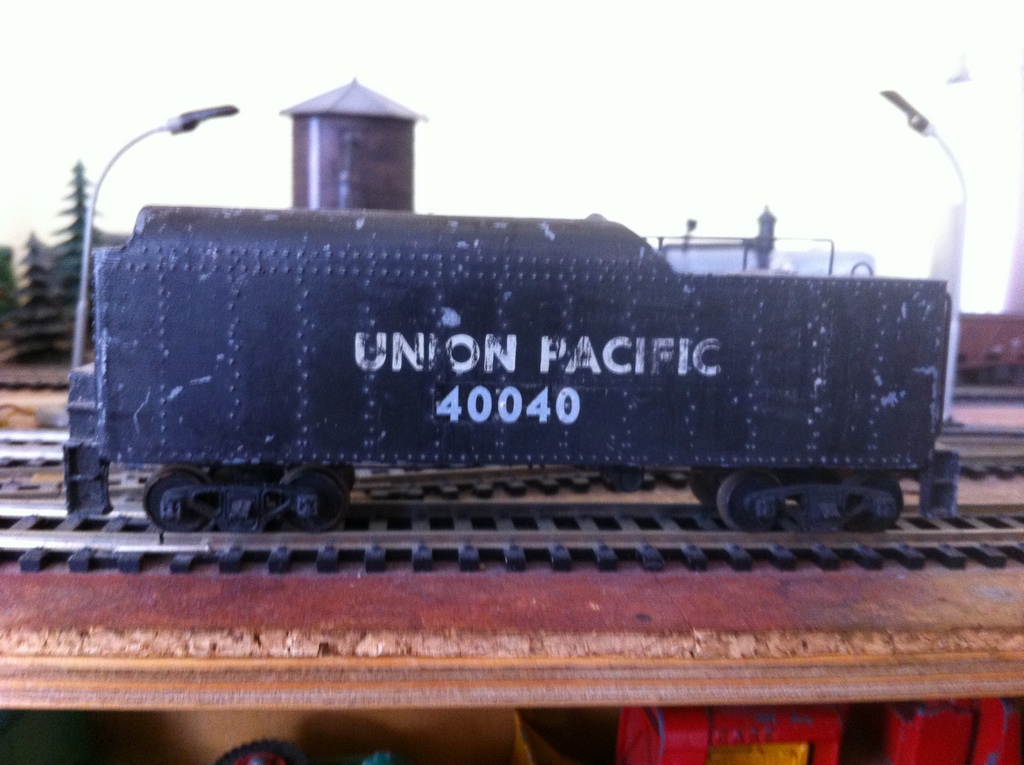

got this 4 axle diecast tender, think its from a very early mike! _ Erich
