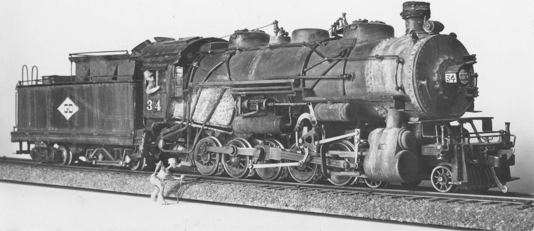

Thanks Tommy! Got some ideas and love John Allen's #34 4-10-0,just be to expensive to chase after the Varney parts he used!
 Posted - April 10 2013 :  5:41:54 PM Link directly to this reply  Show Profile  Add Redwoods to Buddylist
That's one of my favorites too.
It's the epitome of brutish helper power. I can't wait to see yours.
