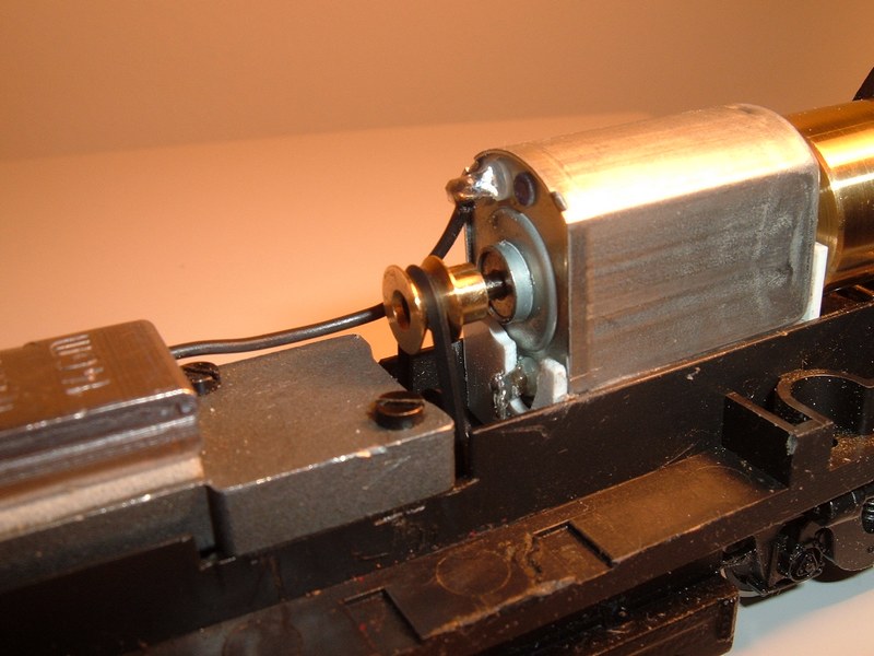

 Posted - March 24 2013 :  5:02:40 PM Link directly to this reply  Show Profile  Add NickelPlate759 to Buddylist
A typical flat can is difficult to squeeze into one of these because of where the gearbox is, which tends to restrict it to a cab mounted pancake type like the original. A disk drive motor will work, but may not hold up under a lot of use.
The tank drive in these is a cheaper version of the drive in Rivarossi's U25C. I repowered one with a small can and pulleys, and the shortest drive belt I've ever come across salvaged from some old electronics.
A thin O-ring might do the trick as well.

I bet I got those belts! They're used in CDROM's as a ejector drive.
