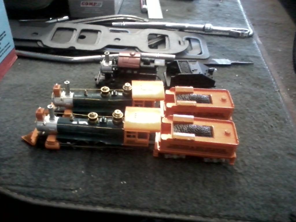

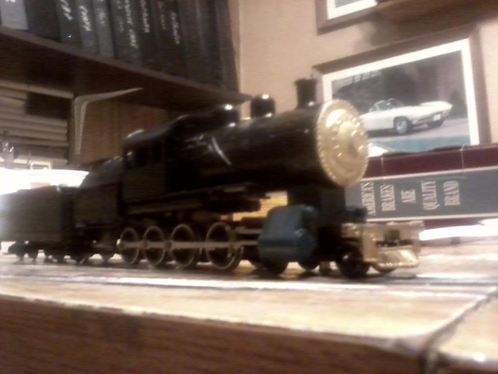

I've been kept busy these last few months. During that time i have acquired 2 tyco 4-8-0's and a Mantua yardgoat 0-4-0. After acquiring these engines, i've had no inclination to bother looking for more motive power. Well, anyway, I also had a Mantua Camelback boiler and tender sitting around, saving them for a 2-10-0 camel. I got fed up with looking for a 2-10-0 chassis and/or trying to making one. All of which led to me getting the 4-8-0's.
Construction is going well so far. Boiler being partly mounted to the chassis, new drawbar made, motor running as best as I can get it to, a set of tyco 0-8-0 cylinders cut to be angled inwards and to raise the boiler up. And now it is the long wait for parts. For weight, i'll be using heavy 3/4" nuts, stuffing the boiler with them. I'll be experimenting with nutserts for the front part of the engine to mount it since I have rear taking care of. If that plan fails, I can always stuff the steam chest full of epoxy putty and the drill afterwards to give the screw that holds the pilot truck something to bite into and hold. Will be adding pictures soon.

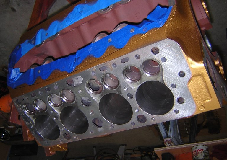

Like it so far! Must be building a V8, I see intake manifold gaskets!

My dad is an Oldsmobile guy and we have a couple V8's in the works. A 455, a 425, and a 318. I might be wrong about the 425 though, but they are all Olds.

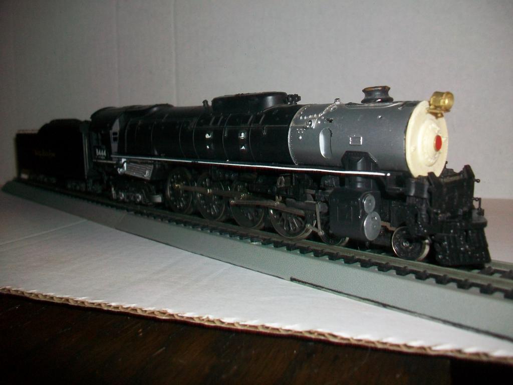

I've been busy with this engine and giving up on finding a Rivarossi 844 boiler front.

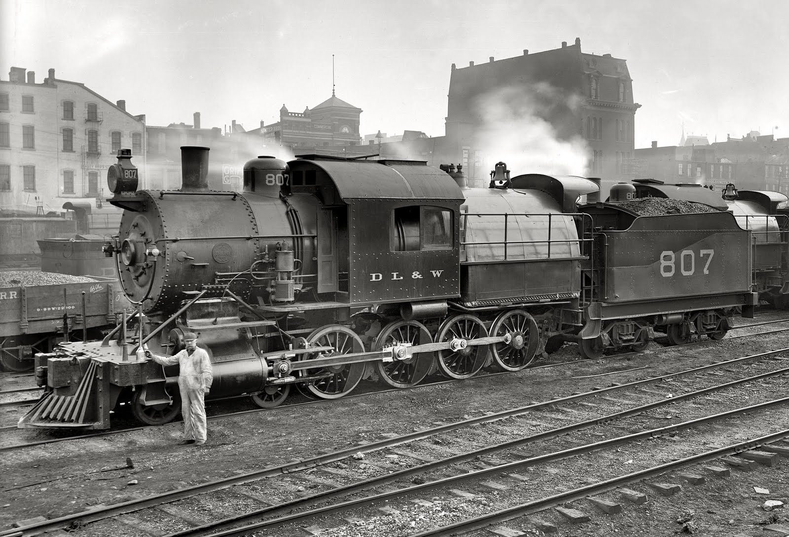

could not help but post this beautiful quality shot of a 4-8-0 camelback ken
Originally posted by LGLrr845 - March 23 2013 :  11:16:22 AM
The Rivarossi 4-8-4 FEF is or well seems to be the more difficult steamer by Rivarossi to find parts for! But, that boiler front you got there, looks VERY familiar!

Great picture, Ken. Interesting to see the tapered connecting rods. I wonder what the large blocks are on either side of the front coupler... for shoving duties, perhaps?
 Posted - March 25 2013 :  08:32:55 AM Link directly to this reply  Show Profile  Add toptrain to Buddylist
Originally posted by catfordken - March 24 2013 :  9:03:16 PM

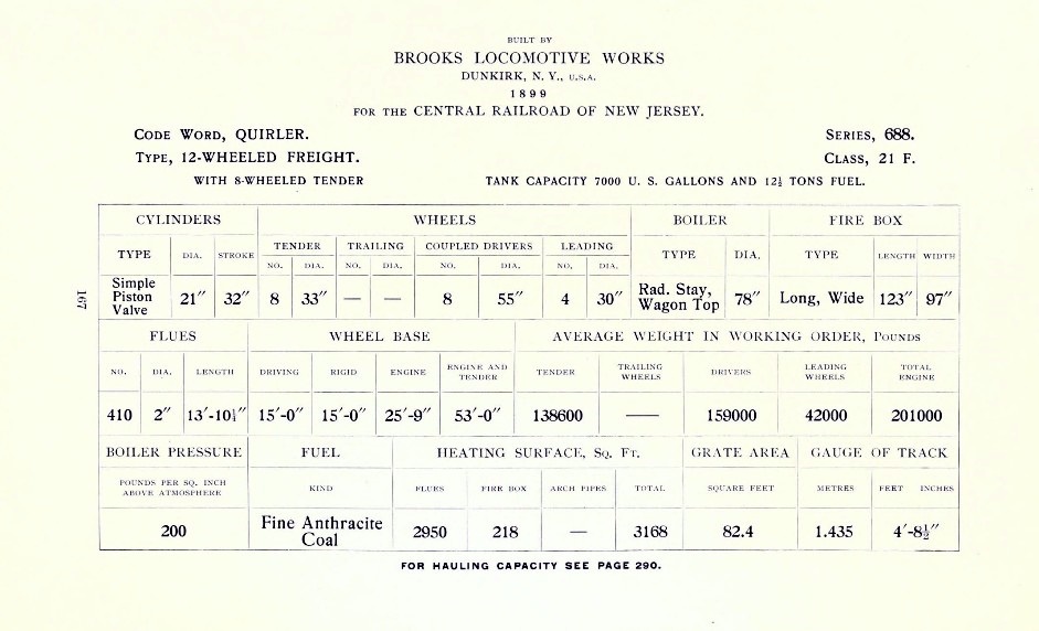

Ken ; The Lackawanna mastodon is almost the twin to the CNJ K1. You can easily see it is a Brooks built loco. Slanted cylinders with the inside Joy valve gear. The standard cab, and tender. The tender is the same shape as on the real Casey Jones loco. Tho I think larger. Rivarossi made their model with this tender.
Here aare the Brooks specks for the CNJ K1
Edited by - toptrain on March 25 2013 08:37:53 AM

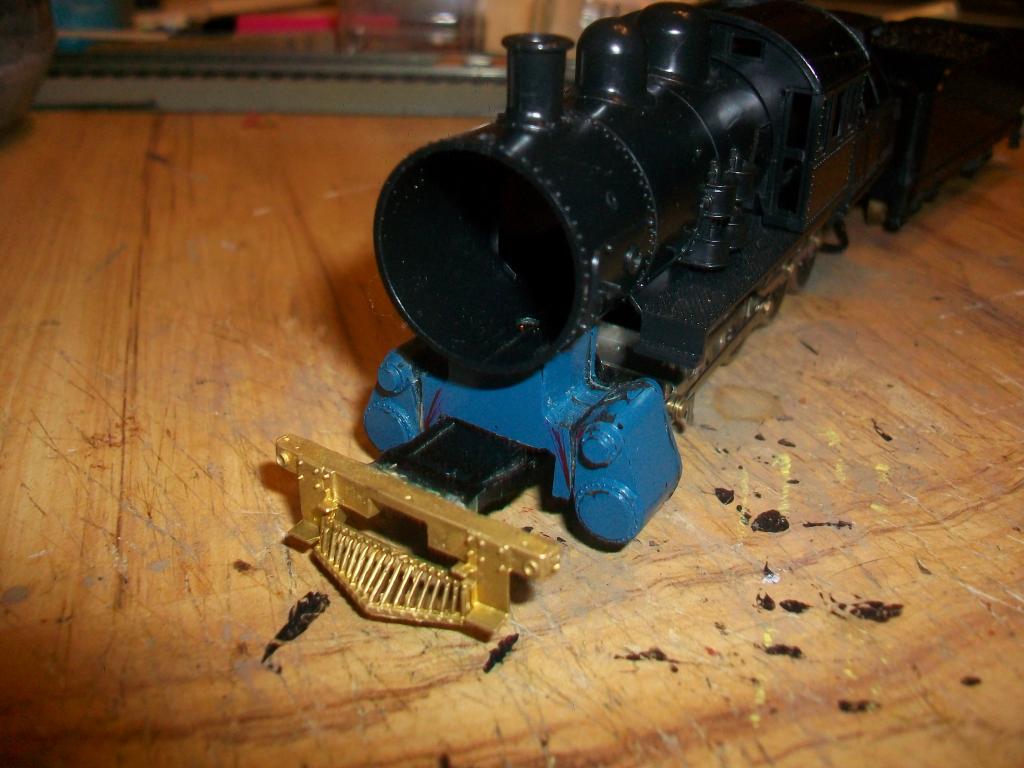

PARTS! GLORIOUS PARTS! and i need more.....
 Posted - March 31 2013 :  11:08:33 PM Link directly to this reply  Show Profile  Click to see EM-1's MSN Messenger address  Send EM-1 a Yahoo! Message  Add EM-1 to Buddylist
Mike,
Nice work! I'd love to find a set of the Camelback parts to add to a 2-8-0 to make into a B&O E-19a! I got the complete loco, but the Camelback parts are evading me!

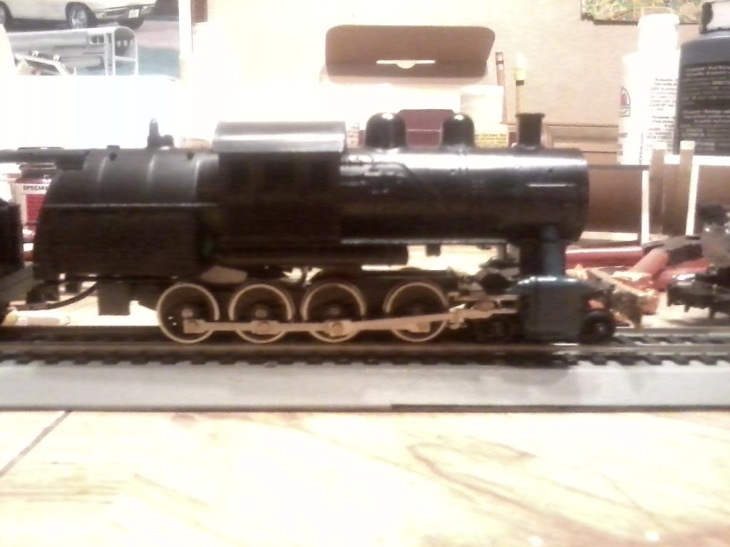

The motor isn't as good as I want it to be. I finally got the boiler mounted in place, weight added (and there's tons of space for more), and ready for details and painting. Anyone know of where I can get some can motors?

Got motors coming in and more parts. I'm also looking around for more weight, the engine is too light, needs to be heavier. The engine was running smoother when I had my hand on it, so I need at least a half pound more of weight. With the smaller can motor inside the engine, I can stuff more weight.

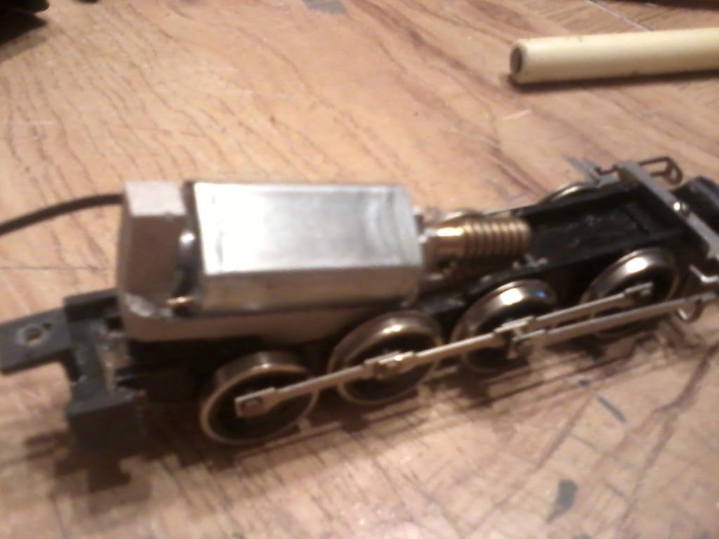

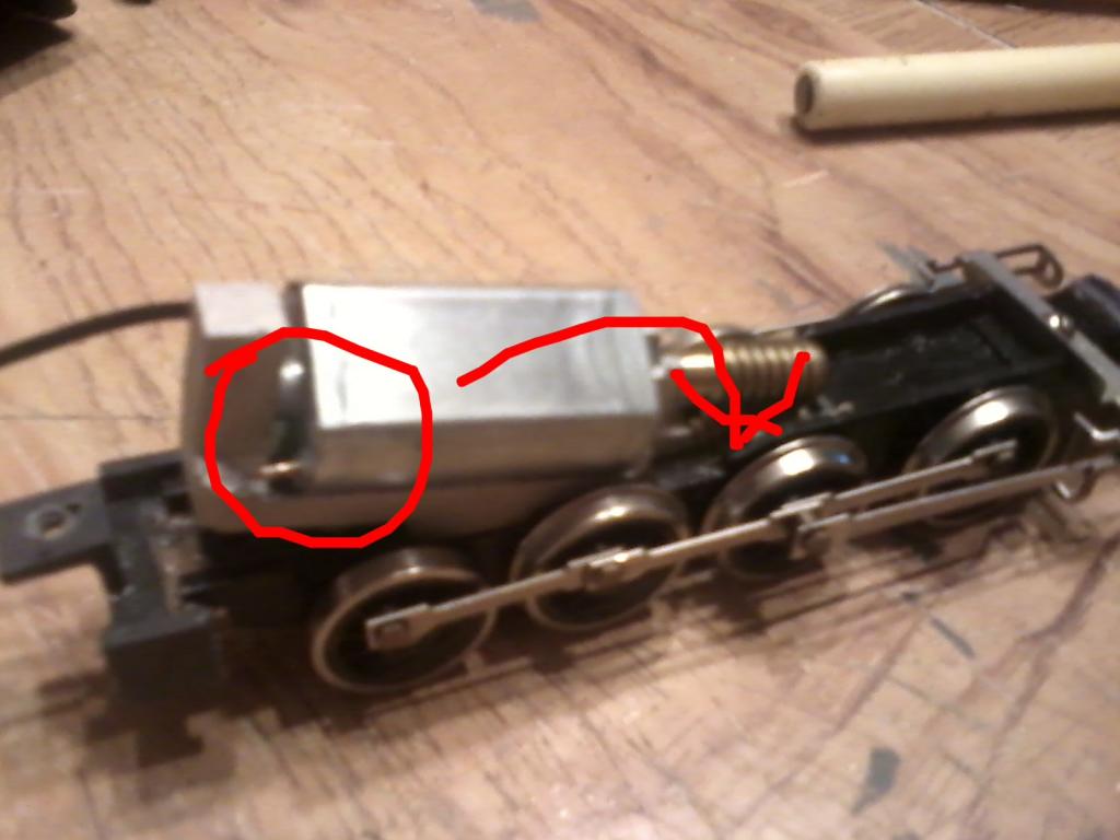

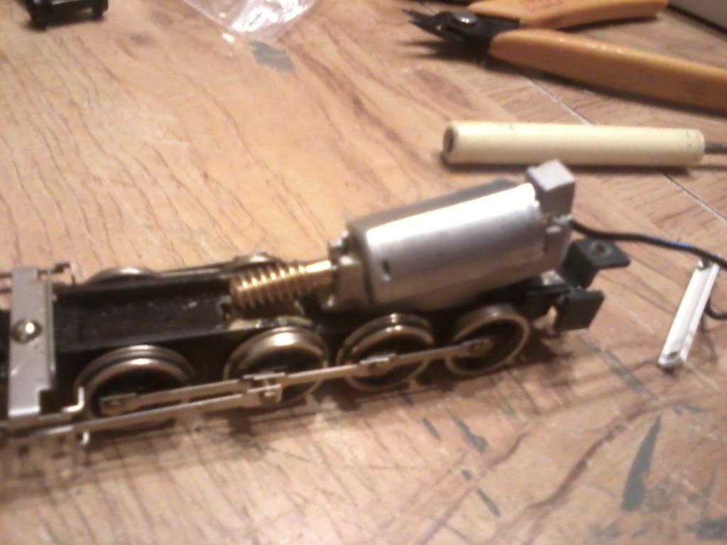

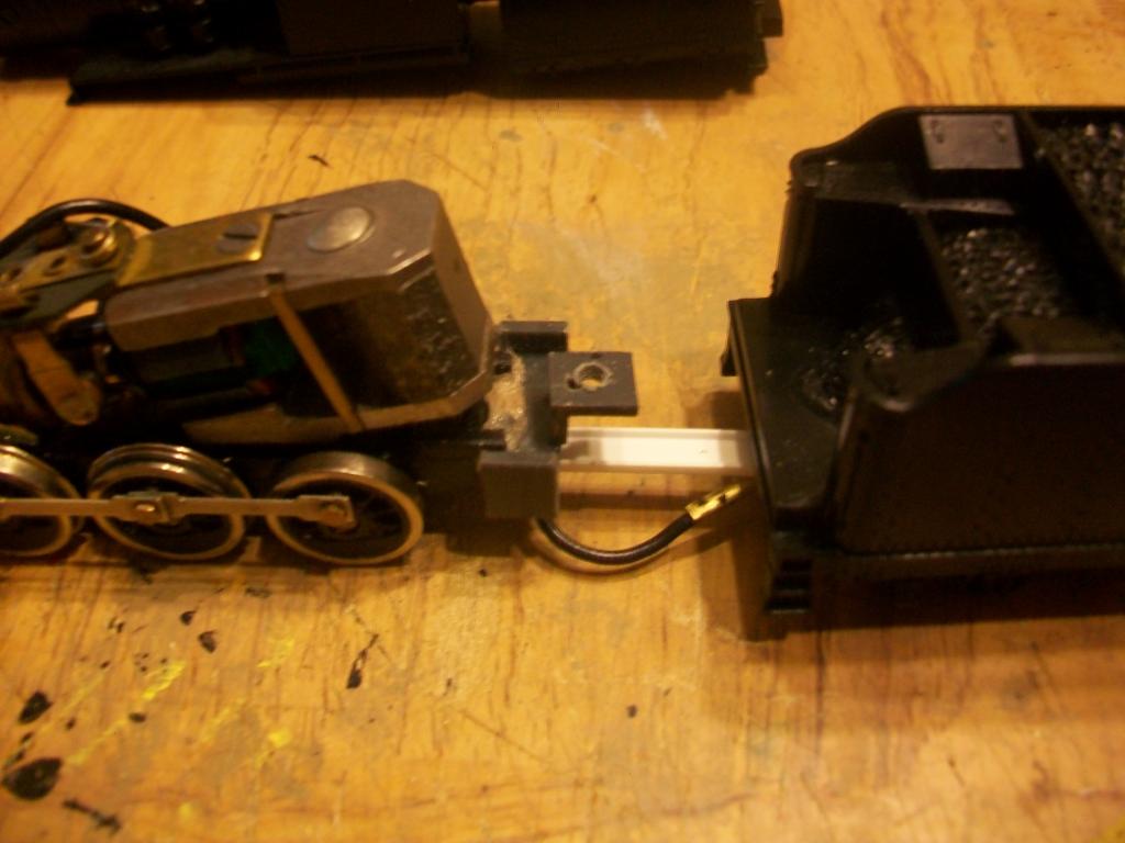

New Motor Installed
Other side
And now, where do i solder the other wire to? Directly to the frame i suppose but it isn't quite often I do this and the last time i did it I forgot which engine I did it to.
Edited by - LGLrr845 on April 17 2013 4:38:03 PM
 Posted - April 17 2013 :  9:52:39 PM Link directly to this reply  Show Profile  Add NickelPlate759 to Buddylist
You can't solder to zamac. Use an existing screw or drill and tap a hole in the frame for a 2-56 screw to fasten a lug to the frame.

Cool, i should have this engine running by tomorrow morning! I just need more weight and details added.
 Posted - April 17 2013 :  11:49:45 PM Link directly to this reply  Show Profile  Add NickelPlate759 to Buddylist
Come to think of it, you could drill & tap the screw hole in the rear of the motor mount so it's inconspicuous. There would be no need to unscrew the lead from the frame when removing the motor. I think some of Yardbird Trains motors were set up that way.

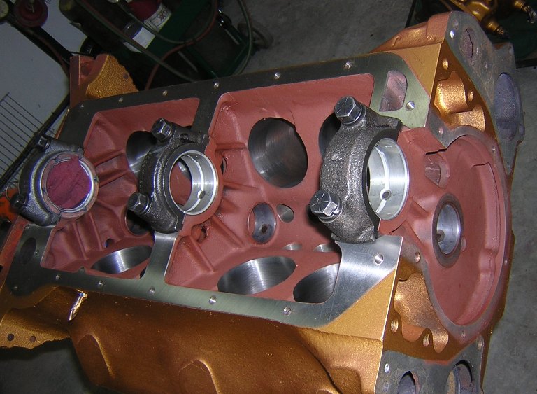

Originally posted by LGLrr845 - March 22 2013 :  3:38:03 PM

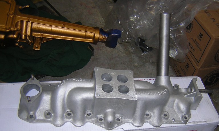

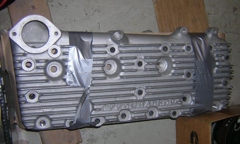

I know it ain't Tyco, nor Olds, but it IS a REAL V-8.
LGLrr845
MantuaAvatar
 Posted - May 24 2013 :  11:49:11 PM Link directly to this reply  Show Profile  Add LGLrr845 to Buddylist
Oh, Offenhauser! You gonna put it in a midget racer?
 Posted - May 24 2013 :  11:53:21 PM Link directly to this reply  Show Profile  Add Redneck Justin to Buddylist
Now we're talking! Gotta love those flat heads! Is that a 8BA or a 59BA?

8BA. Merc crank, 255 base, bored 120 over, ported and relieved, stainless valves, 3-ring pistons, Offy heads and 4BBL inlet manifold. Mallory distributor.
That is going back into my 1949 Willys Wagon Street Rod when the quarters get finished.
Always a 2WD, now with Ford 8" and Mustang II front end.
This is what it used to look like. We have a T-Bird tilt column, not sure anymore what seats are in it or what we're going to use.
This is the inlet manifold. Been on this car for.........almost 30 years. 390CFM Holley.
