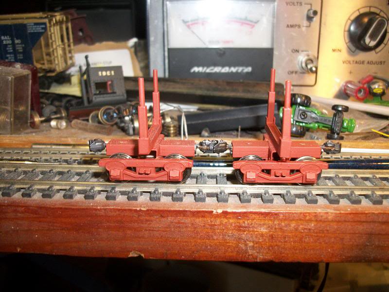

A little brass stock, tubes, and solid square rod and a bit of solder and flux, and you can make something a bit close to the Kadee models, but, older looking for a year gone by? Sure, its a logging railroad, they never had brand new equipment all the time anyway, so.....
With the plastic TYCO trucks, you got this:
If you look the Kadee couplers are burried inside square tubing thats the same inside diameter of that of a Kadee coupler box, WHICH, allows me to stuff the coupler, and a draft gear box, inside the brass tubing, then it was marked from the outside to be drilled and taped for screws. The top of the inside of this box, has one extra thickness of brass shim stock to give a bit more "meat" for the tap to hold 2-56 threads in and try to prevent stripping out of the threads....REMEMBER, it is brass after-all!

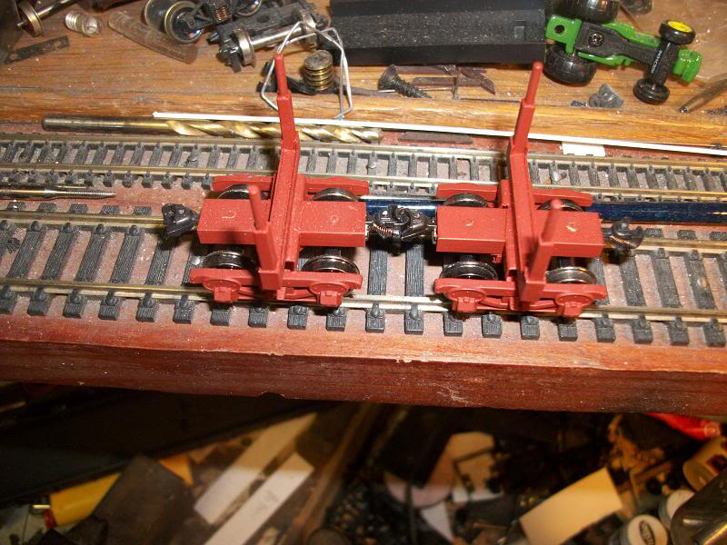

This frame of the log "bunks" are bolted to the truck. NOW, you'll be enlightened as to why I said both, plastic and metal trucks above! See, the mounting of the bunks to the trucks?
This picture shows that the log bunks made of brass construction were bolted to the plastic truck. THIS "Disconnect car" will NEVER be loaded with logs........why? Well this is an unloaded model and can't, these "carriages" have to swivel UNDER the logs, OR atleast the bunks do....At least to allow the carto traverse through curves in the track if these don't swivel it will derail the car!
These type cars will be hastely detailed, beat up and look terrible as to be the "uncovered" disconnects.....to hide all this, and such and look somewhat realistic. NOW on the metal trucks, this WILL NOT appear the same, the metal trucks, will have the bunk to swivel above the truck frame, to have logs mounted in the bunks and chained down like my other log cars have had done to them.

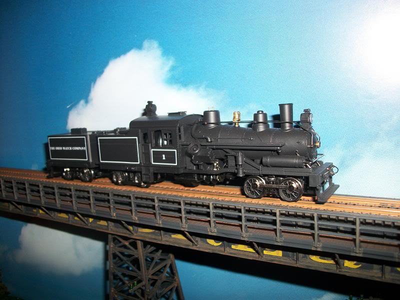

I'm working on a series of custom made brass items for this train to see what can or can't be done to make realistic looking log cars. I have a Shay and a Heisler to make trains for, and maybe an upcomming Climax from MDC Roundhouse....(This one is pending) the 2 for sure are my 'Rossi Heisler:
And then, my Bachmann Spectrum Shay:

you know, if you drilled and tapped a 2-56 in the center of the bunks....you could make them swivel, just a thought
 Posted - October 25 2013 :  10:00:08 PM Link directly to this reply  Show Profile  Click to see EM-1's MSN Messenger address  Send EM-1 a Yahoo! Message  Add EM-1 to Buddylist
Thanks Barry.....A bit of work,......BUT turned out VERY well!
Ray, nope wouldn't work! The trucks.... were BROKEN! And made from slippery machine plastic....I was avid to see if it could be used....NOW, I've got unbroken plastic ones so.....PLUS the metal ones to use!
