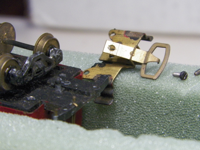

Hello, My name is Barry. I'm new to this forum. I have a few Mantua and Tyco-Mantua locomotives and I most recently got a brass Mantua caboose. I would like to convert the couplers to either horn hook or Kadee type (something so this caboose can actually be pulled). So . . . I'm hoping to find some ideas here. I do plan on working with this caboose; getting all the bent brass back straight. Thank you. Barry

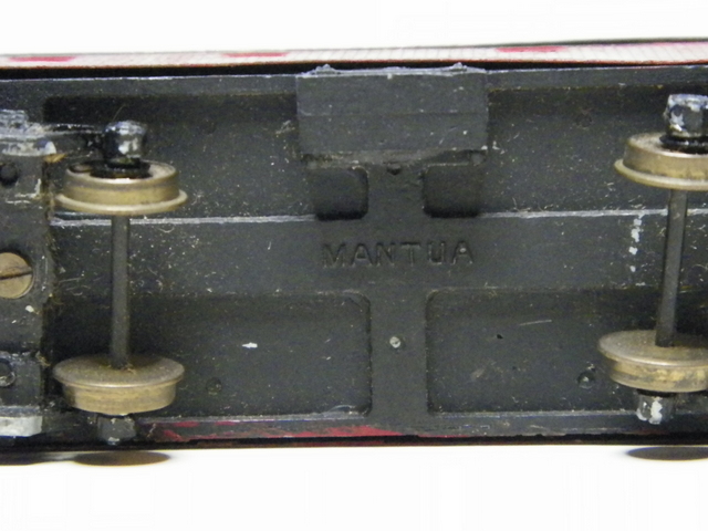

 Posted - March 17 2013 :  3:08:10 PM Link directly to this reply  Show Profile  Add Barry to Buddylist
Thanks Shaygetz. Do you have a photo of the bottom? Did you have to cut off the original mounting pin for the old style coupler? (What's the proper name for those old style couplers?). Lots of questions. Thanks again. Barry

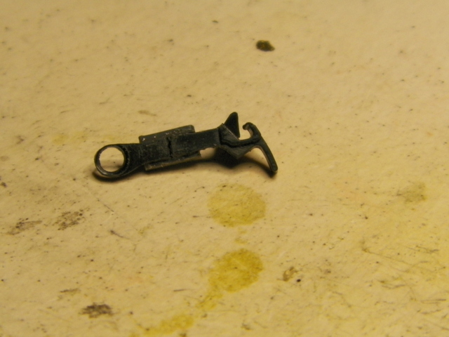

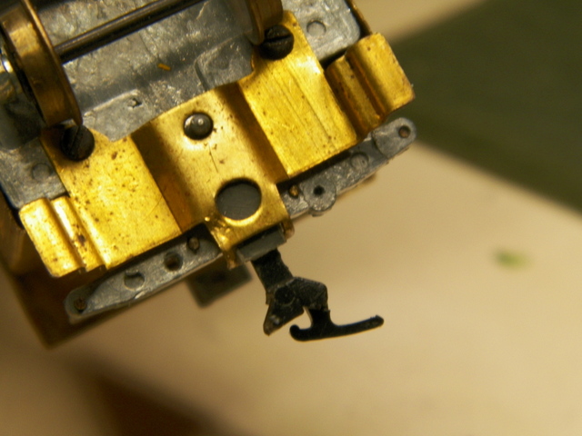

 Posted - March 20 2013 :  01:46:31 AM Link directly to this reply  Show Profile  Add Barry to Buddylist

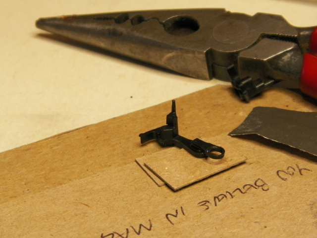

Well I didn't want to cut any original pieces so I'm temporarily going to use a coupler that I sistered on a piece to for length. I purposely laid one on top of the other to get the thickness needed for the original coupler box. The paint came off and the dents have come out pretty well.

those pliers a little big for the project at hand?? just kidding!!

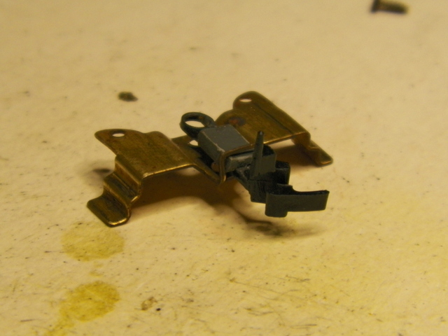

Sorry I haven't gotten back to you. It appears I used a longer shanked Kadee, a pair of #26s, that I placed on the stock pin and sprung with a #5 spring. The camera is not cooperating...

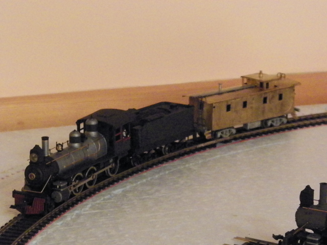

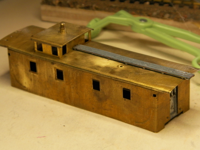

 Posted - March 21 2013 :  12:53:22 AM Link directly to this reply  Show Profile  Add Barry to Buddylist

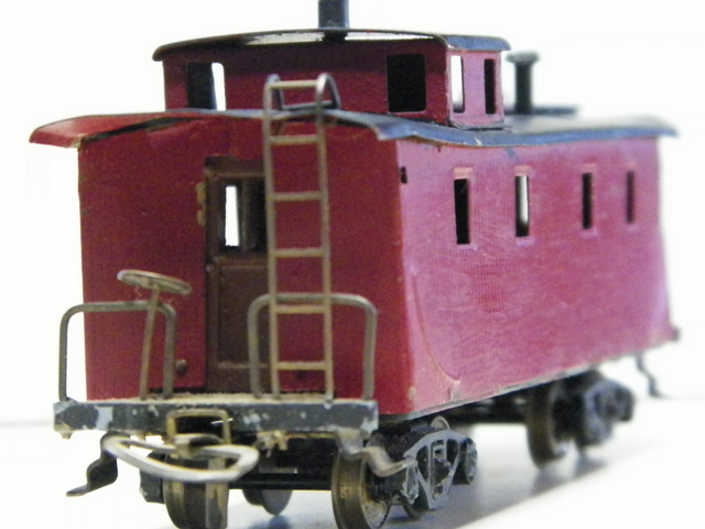

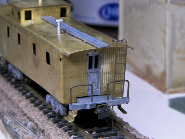

Thanks for the info on the kadee 26's and the hook and loop term. Yeah, I just got back into this a few months ago and I'm realizing I need a whole different set of tools. The brass don't look too bad. You can really see it wasn't much compared to some of the brass cabooses they make these days. Although, I like the history; thinking that it's like at least 50 years old. hoseeker dot net has them in some of the catalogs in their literature; maybe shaygetz knows? I didn't get the dents out as well as I would have liked to, but I did get to watch it be pulled around by my Tyco-Mantua Rogers 4-6-0. And I'm glad I took pictures of it before I messed with it. I think there is something to be said about just leaving antique pieces alone and not messing with them. Anyway, here's a couple of photos.
blaneo
B&O Switcher
 Posted - March 21 2013 :  09:27:53 AM Link directly to this reply  Show Profile  Add blaneo to Buddylist
I like it. I think you did a great job fixing and cleaning it up. A little tweaking here and there, and possibly some fresh paint to highlight the details and I think you would have an excellent looking caboose.
