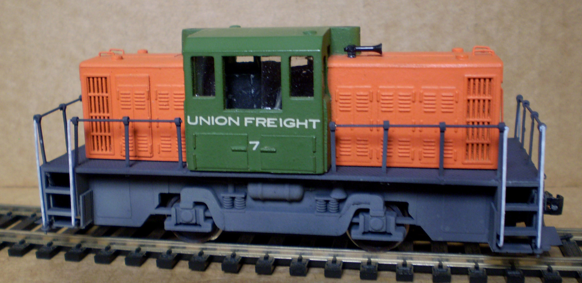

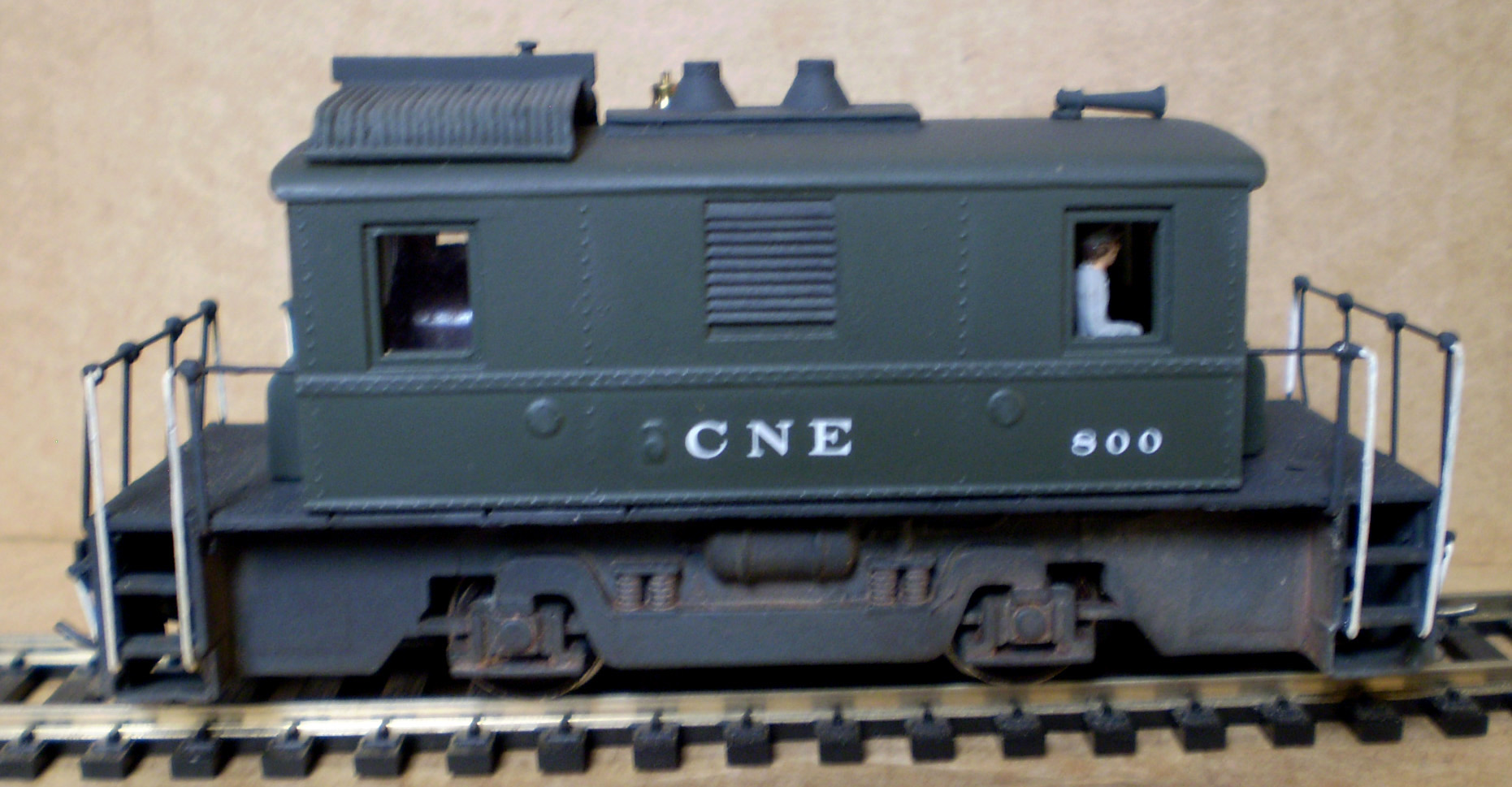

These are three conversions I've done over the years. The 2-6-0 is based on the Mantua Little Six. I added a can motor, pilot deck, and pilot wheels as well as detail parts. The Box Cab is a Cary/Bowser shell mounted on an AHM Center Cab frame and mechanism with Athearn stanchions and handrails added. The Union Freight is another AHM Center Cab with Athearn stanchons and handrails.

I especially like the boxcab and the steam engine. All the details on them look great!

Awesome work, Cary! Those little AHM Center Cabs do make great project starting points, as a few other members have shown. The bottom picture looks so good it make me want to get out the cutters and and add some Athearn stanchions to my own.

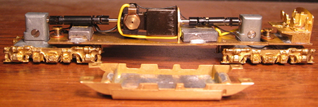

here is mine, not pretty but shes a work in progress...

The loco is a great runner once you get it finished. Well worth the effort!

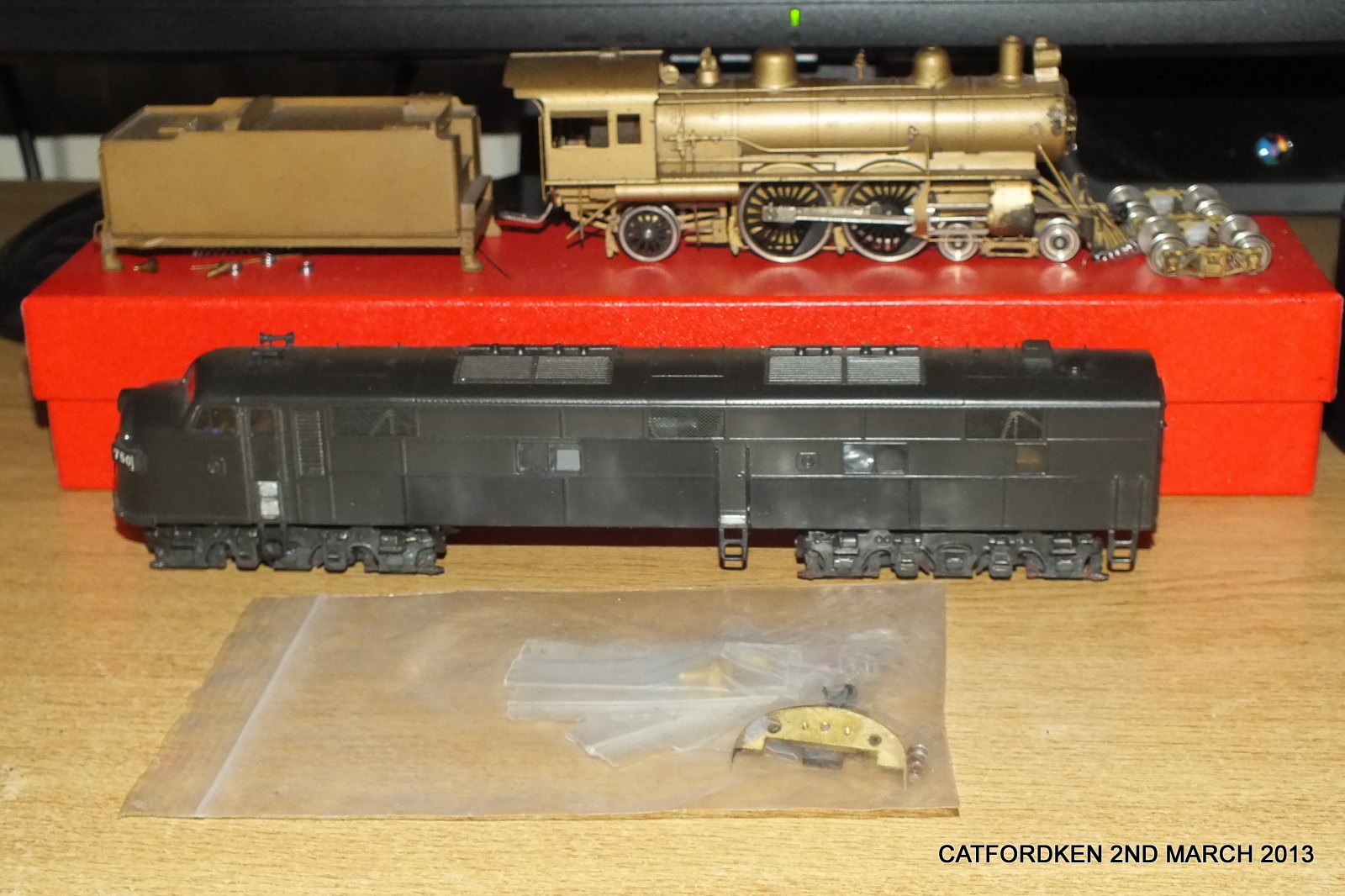

my loco this week is a samhongsa e8a the only one used by the sp&s no 750,ken

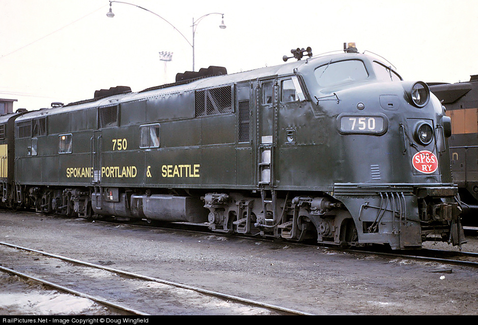

the real thing
am missing the fuel tank part,which i think will be the hardest thing i will ever find,such a shame

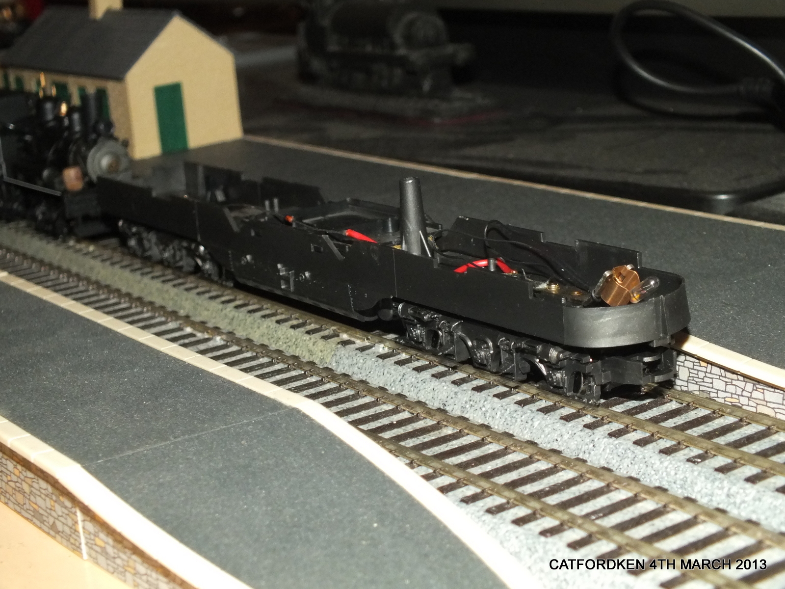

anyone who sees or has a tank for this loco will pay a good price,but i can see me having to make one ken

E8a Fuel tanks
could you use a modified set from a Tyco E7? Maybe order 2 FT/F7 Bachmann tanks and splice them and cut the trim from an F-Unit body.?
Regrards
 Posted - March 04 2013 :  5:36:36 PM Link directly to this reply  Show Profile  Add NickelPlate759 to Buddylist
Ken, if you can tolerate plastic, the fuel tank from the Model Power / Roco E-units is easily removed. It's just a friction fit on the frame.
You could spray it gold.
 Posted - March 04 2013 :  5:42:13 PM Link directly to this reply  Show Profile  Send catfordken a Yahoo! Message  Add catfordken to Buddylist
hi mate sounds like a standby plan thanks,thought i had one but its a lifelike i think ken
