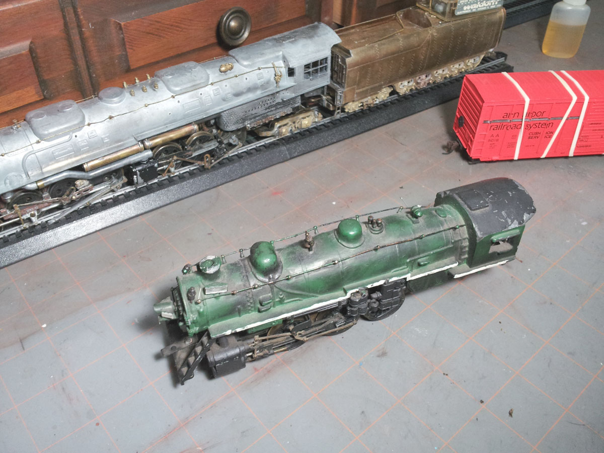

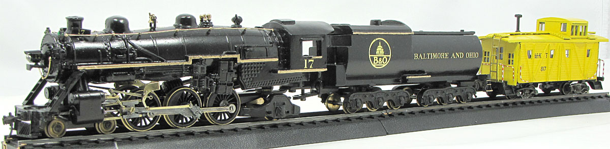

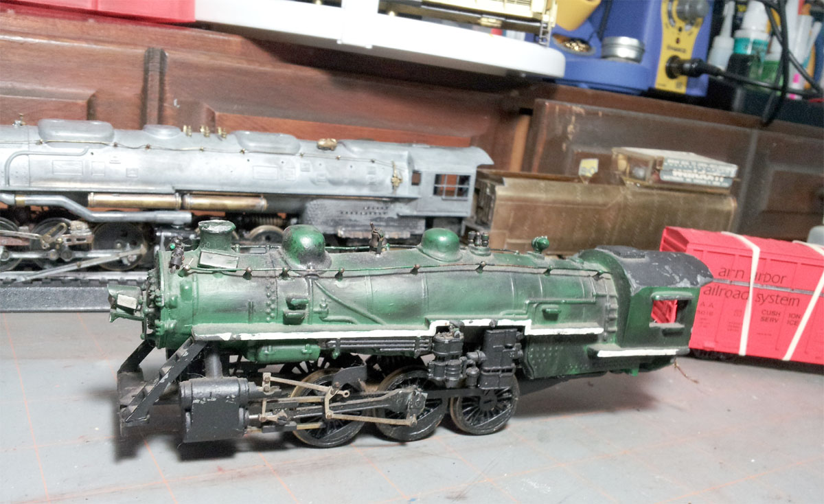

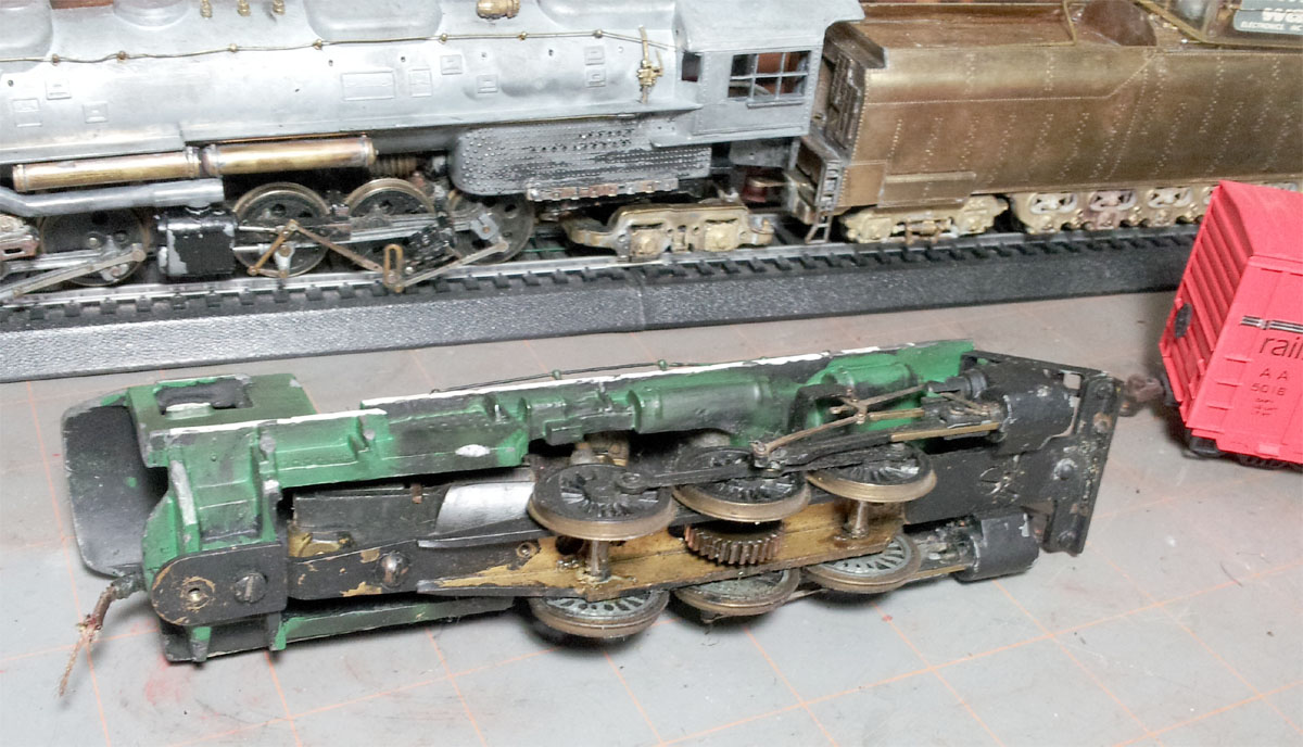

As some of you may recall, last fall a prospective customer handed me a crusty old diecast steamer missing parts and a tender, and drowning in some sort of mysteriously aged pseudo-camoflague paint:
The owner wanted it "restored" but was not too particular. While the Varney 4-6-2 Pacific is more influenced by a Southern Pacific prototype, he wanted it painted suitably for a local (Kentucky) connection - namely L&N, Southern, B&O or C&O. As the first tender I obtained (thanks Sean!) happened to be a Vanderbilt, that narrowed it to B&O or C&O, and the customer chose B&O and asked for the number 17, presumably in homage to his late father, who owned the loco (and supplied caboose) previously.
The loco shell had a lot of ding damage, which I decided to touch up but not eliminate, in honoring the history of the piece (the current owner conceded it was probably his doing as a lad).
So this was to be a mechanical restoration to get it running , with a cosmetic restoration using artistic license.

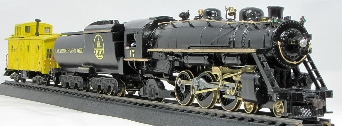

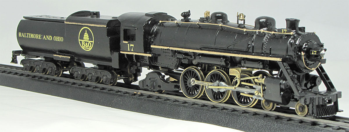

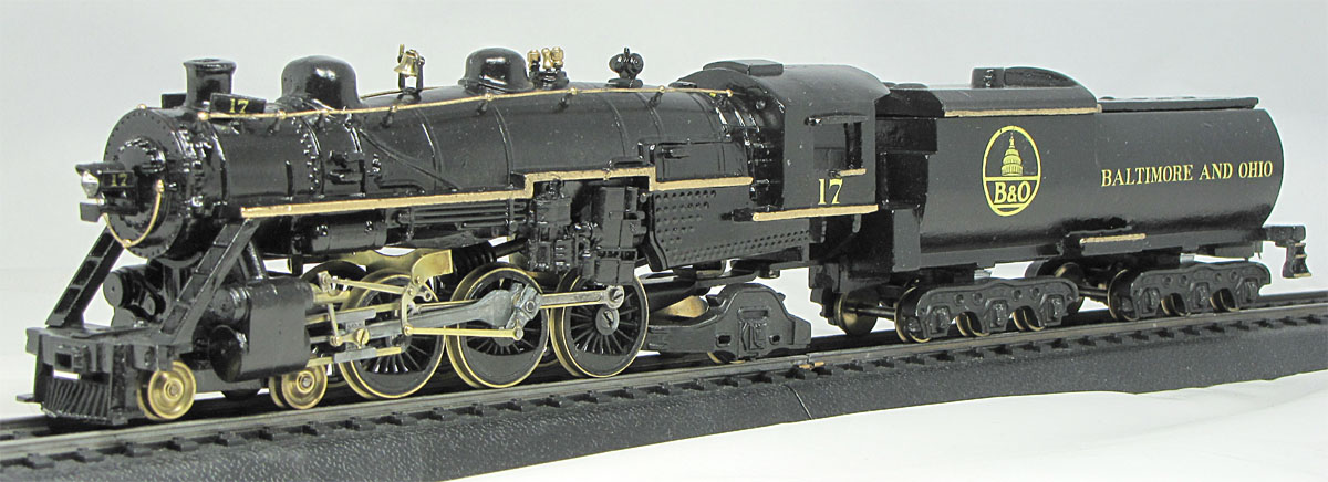

I rebuilt all the valve gear and and supplied the missing parts, then polished it out. Since the charm of these vintage models is arguably the materials they were made of - various metals instead of plastics - I left the running gear unpainted. Since much of it is brass, I painted the boiler trim to complement it, and then custom-designed decals and printed them in gold foil.
The paint appears a little thick but it really isn't: a combination of vintage castings that lack the sharp detailing we're accustomed to, under a coat of primer, paint, and gloss sealer for the decals. A flat finish would be more realistic, but as a display item gloss works for now. Customer gets final say, but the chassis and running gear is flat.
Again, it's not an entirely accurate B&O model... but it looks good nonetheless.

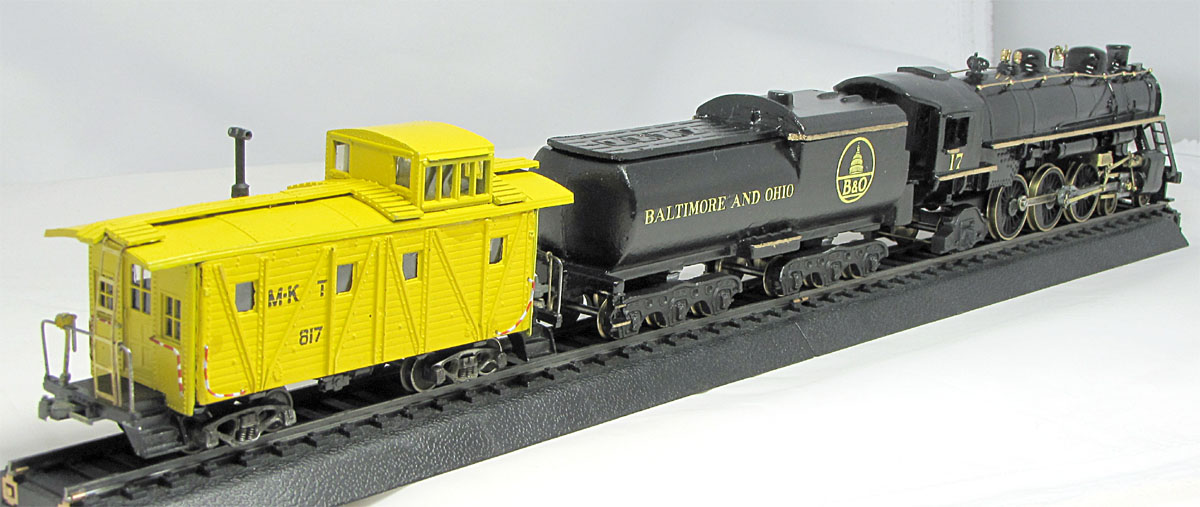

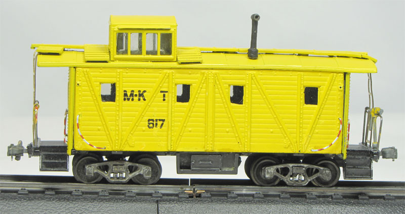

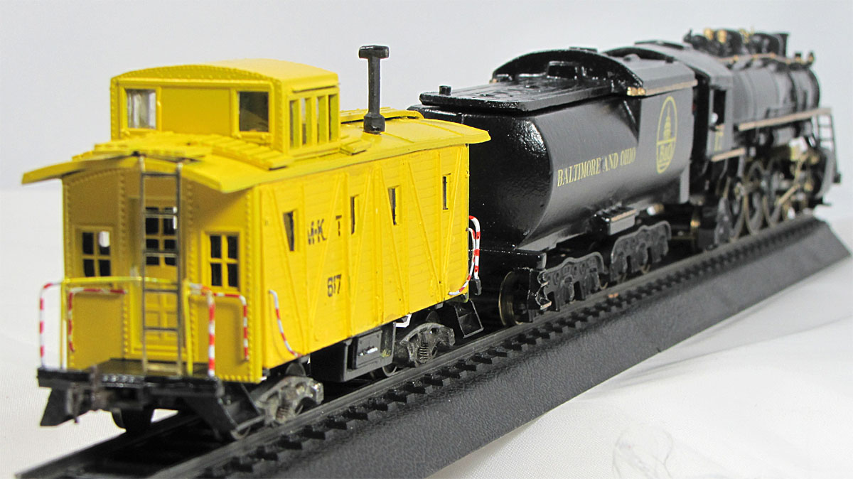

I wish I'd taken "before" pictures of the MDC truss caboose, which was a similar disaster. The platform roof ends were bent to the breaking point, all the the modeler-painted panels were chipped and flaking, and the MDC-painted side panels were filthy.
I was able to clean the MDC panels without ruining the paint, straighten the roof panels with heat, and find an appropriate color match for the yellow.
The white and red end grabs? Were painted by the owner's father - I was able to preserve them, and painted the side grabs to match.
Still needs some touch-up and tweaking, but I'm pretty pleased overall.

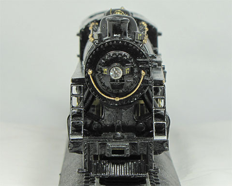

I touched up the handrails and such on the caboose. Then painted a cab figure, added markers to the owner's supplied signal lanterns, modified the tender bolsters to drop the ride height, found and modified metal Roundhouse couplers to fit (I still need to shim the optional pilot coupler), fabricated a tender pickup connection and drawbar (for insulating purposes, the drawbar is the ONLY plastic component in the entire model. Fun fact, the drawbar pickup is courtesy the terminal plate from a dead Kader pancake motor )...
...after a final tune and tweak, she came to life and POUNDED the nickel as few HO locos ever could.
With some final small incidental touchups, she's finally done and ready for departure. Always kind of bittersweet, but the owner is thrilled, and said some of the best compliments I ever received, so that makes me happy.
