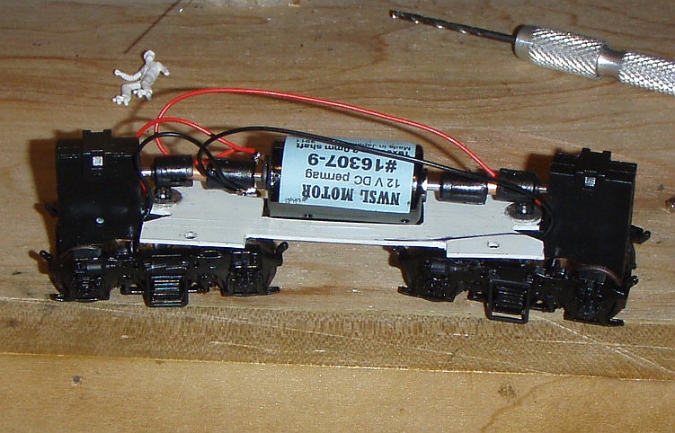

...I did a bit of work (12 hours, more or less)

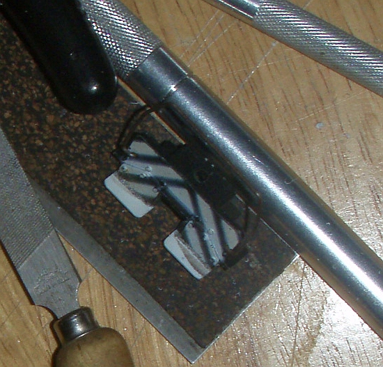

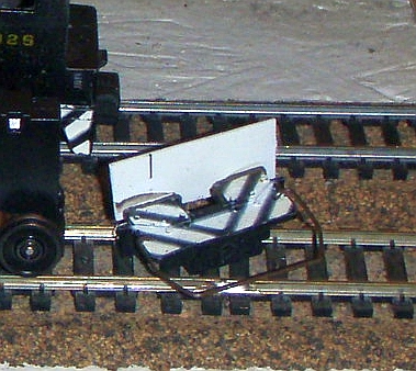

...new styrene steps JB Welded to the rear pilot, then shaped...
...a new frame, drive, P2K trucks, can motor, handrails, bell from the scrap box...

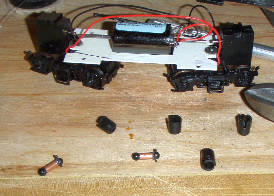

...the dog bones had to be shortened, then rejoined with brass tube...
Unseen is the original 6 oz. weight, sectioned and hammered flat, then glued to the inside of the shell all over, the beast can pull the knuckles off of any string it's coupled to.

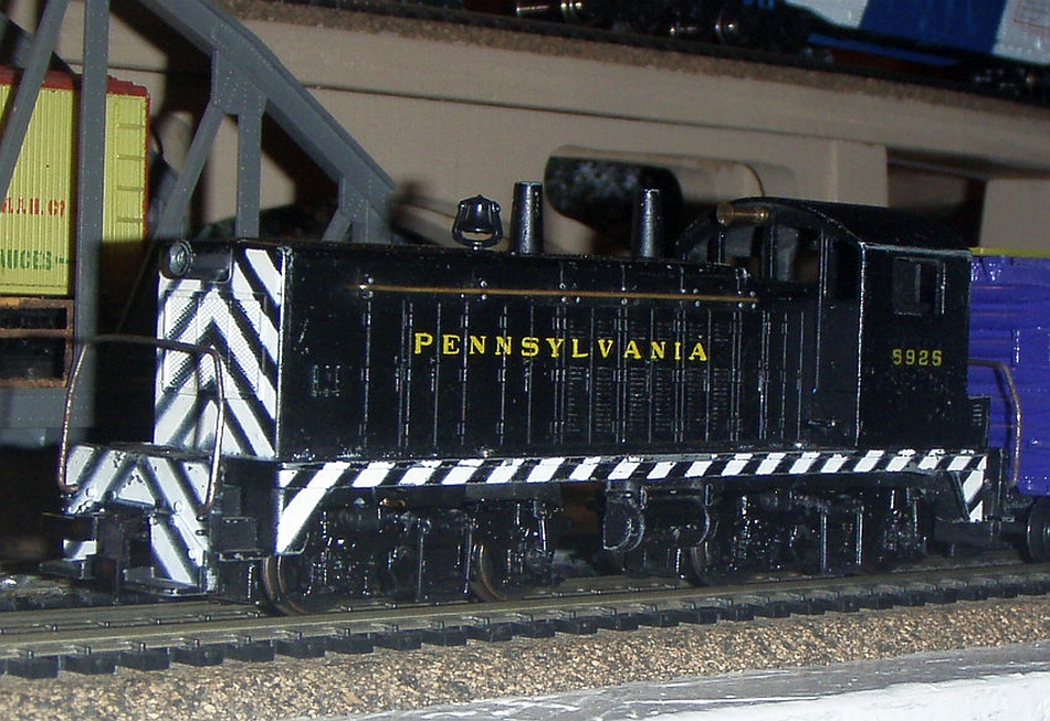

Yes it was a lot of work but I have a reputation to uphold..."If I say it's dead, then it's real dead"...and them zebra stripes are just too cool for the junk yard.
